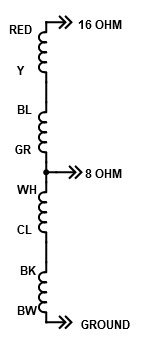

That’s interesting. This is a bit above my head at the moment, as I’m not so familiar with transformer windings etc and not so technical, but if the “8 ohm” setting is actually 10 ohms, then that would explain the results I got with these amps with 8 ohm speakers. Something didn’t sound right. A bit too heavy and slightly recessed in the top end. I switched to the 4 ohm setting (by resoldering the wires) and used that with 8 ohm speakers instead. That gives no recession in the top end but the sound is slightly too bright and lacking in weight. Something more in between those would be better.
Sorry if this is a question that is obvious but could there be a different way to wire (other than the combinations in the manual) to get a proper 8 ohms? (For example could you cut out the parallel middle part in the “8 ohm” diagram for example)
Or could you wire for 6 ohms? Not sure if either of these is possible without more knowledge of the windings etc, but if it was possible then either would be more desireable for me than a 10 or 4 ohm output (when I’m using 8 ohm speakers)

You can wire the secondaries in series, instead of connect the output terminal to red wire (16Ω output impedance), connect the output terminal to the green and white wire joint will provide a 8Ω output impedance. However, it might not give you the sound that you prefer.

Thanks a lot for that info. I was going to try to work on the combos myself but didn’t get too far as didn’t have time.
So my understanding is that each winding is 4 ohms, so what you suggest will give 8 ohms. I can see that by doing that you aren’t using all of the windings. I assume that would give slightly less output?
Appreciate it might not give me what I want as it’s more complicated as explained by Boyfarell, but it’s worth trying.
I don’t like the sound of these monoblocks with the stock 8 ohm setting when using 8 ohm speakers, as explained before.
The other obvious combo I saw using three windings (instead of four or two) is to take the stock 8 ohm wiring (that’s 10 ohms total) and miss out one of the top or bottom series windings. Then you get 6 ohms. Might also be worth trying.

As Tom has said several times, each winding is 1 Ohm (I was wrong saying it was 2 Ohms). That means it has a turns ratio appropriate to a 1 Ohm load if any one of the windings was used by itself, or if all were paralleled. Remember that these "Ohms" numbers are just another way of stating the turns ratio. They have no other meaning, none.
From the standpoint of the best possible coupling performance within the transformer, we'd want to use all of the secondary windings equally, so all in series, or all in parallel, or all in series-parallel. Thus, 16, 1, or 4 Ohms configuration.
From the standpoint of the output valves driving a loudspeaker load, we have to choose between lighter loading for lowest distortion and best speaker damping and heavier loading for most peak output (up to a point). There is no magic bullet but there are balanced decisions.

W. r. t. the drawing in #46, the tap definitively is 4 Ω instead of 8 Ω.
Anyway, other than for convenience I don't see any reason to wire like that, as the transformer's efficiency will be compromised. Tube output power is expensive and doesn't need to be transformed into heat more than necessary. Better do it as shown in #37 (and see that the 8 Ω wiring numerically transforms to 9 Ω).

Are the output impedances of the 4 windings identical? 1R?
P.S. Yes, they are, I misread.
Note that high frequency performance might vary depending on the connection of the secondaries and the transformer geometry.
For example in the 4R and 9R configuration, you have two connection options

If we have four identical windings of 1R and we label them as A, B, C, D
You can get 4R by the following connections: ( // stands for parallel connection, = stands for series connection)
A // B = C //D
or
A = B // C =D
or even cross coupling like
A = C // B = D
You can get 9R by the following
A // B = C =D
or A = B = C // D
Reactions: Tubelover25
Connecting an 8 Ω speaker to an output transformer wired for 9 Ω won't harm at all, I'd say. Plate to plate impedance would be decreased by just 11 %. But do we know exactly which load impedance matches best with the power tubes at their given operating conditions? And by which criteria would we decide? What's the dimension of tube manufacturing tolerances? There are several ways to skin a cat...
