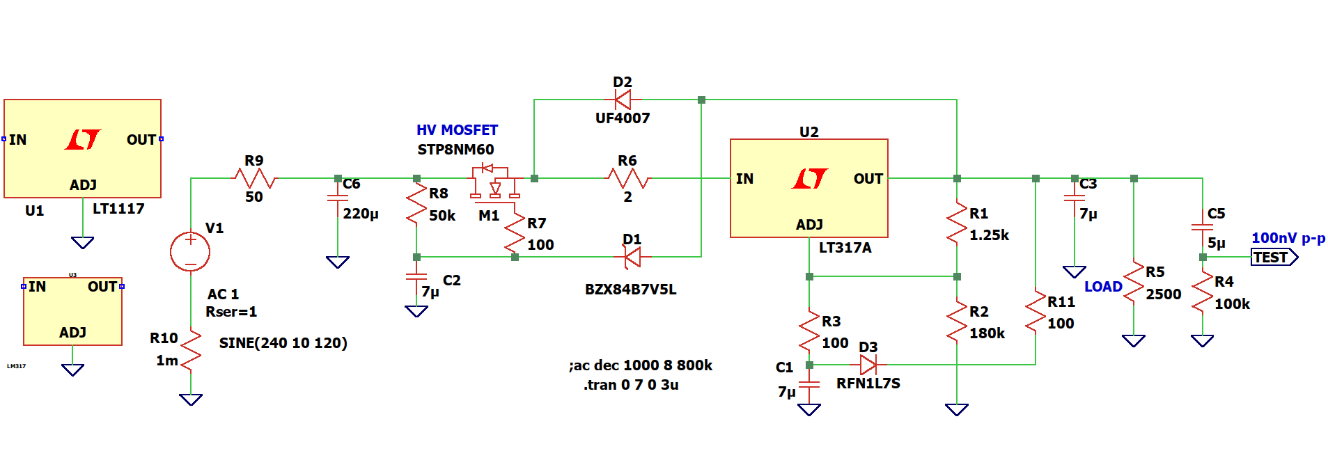

Yes, this design is not optimised for a power amp. I have used something similar in two DHT amps, P-P 211 and 811, the latter with a choke input. This was 30 years ago, using HV BJT's.
Using R in series is no worse than the R of an inductor, it will knock out a few dB of ripple.
Run the sim, I see at least 120dB of ripple rejection.
Efficient? No, neither are vacuum tubes. Wasted kWh won't add to a hill of beans.
Low dropout not an issue with sufficient head voltage. LM317 need an extra ~2.5V dropout, which is not much at 80mA. The LM1117 is better, but watch that stability with capacitive loading. A series resistor to the output cap may be needed depending on the caps ESR.
The LT1117 (and LM1117?) are not much better than the vanilla LM317 model I have, however the LT317A, which also is an LDO (not needing heatsink here) is a few dB better, and 10dB more money.
I changed D7 to lower leakage type and added a series resistor to limit discharge current.
I'm wondering if putting a series R to ground (R10) may be worth it to reduce hard rectifier current into ground. I may have to use real parts to find out.
