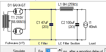

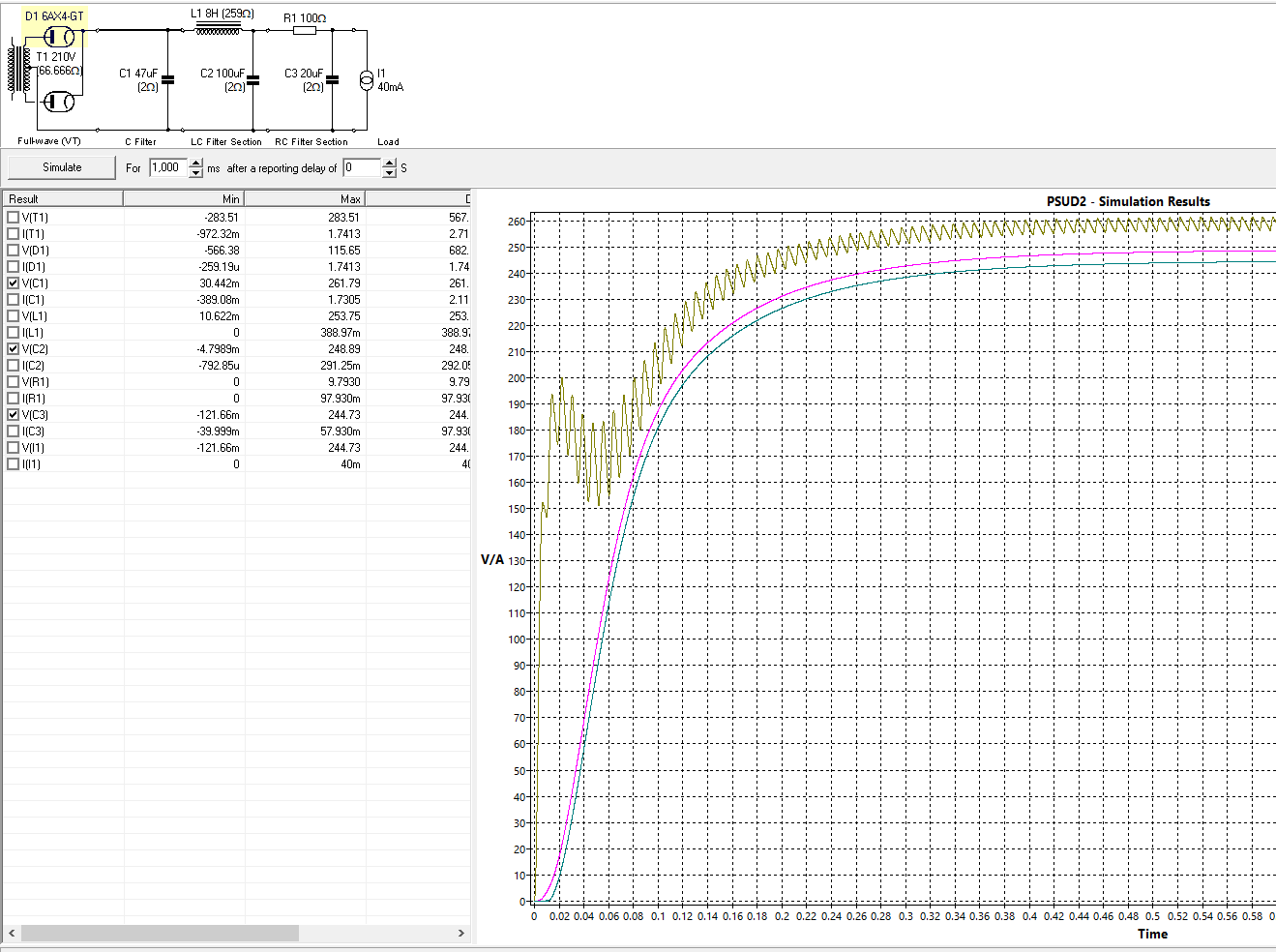

I think you need to ballpark with PSUD2, then switch to LT Spice. The values you inputed into Spice don't make much sense to me. If your choke has 259 DCR, you don't need added resistance in the PSU. That's a lot of damping right there. It depends a bit on the transformer you settle with, but, for example, this gets you to 9 mV ripple:
If you really wanted to use a film cap for the final RC stage, you could with this. Curve is a bit round IMO but that's what you're asking for using a tube rectifier in a lot of cases.
Sketch it out in PSUD2 then move to Spice and I think you'll get better results.

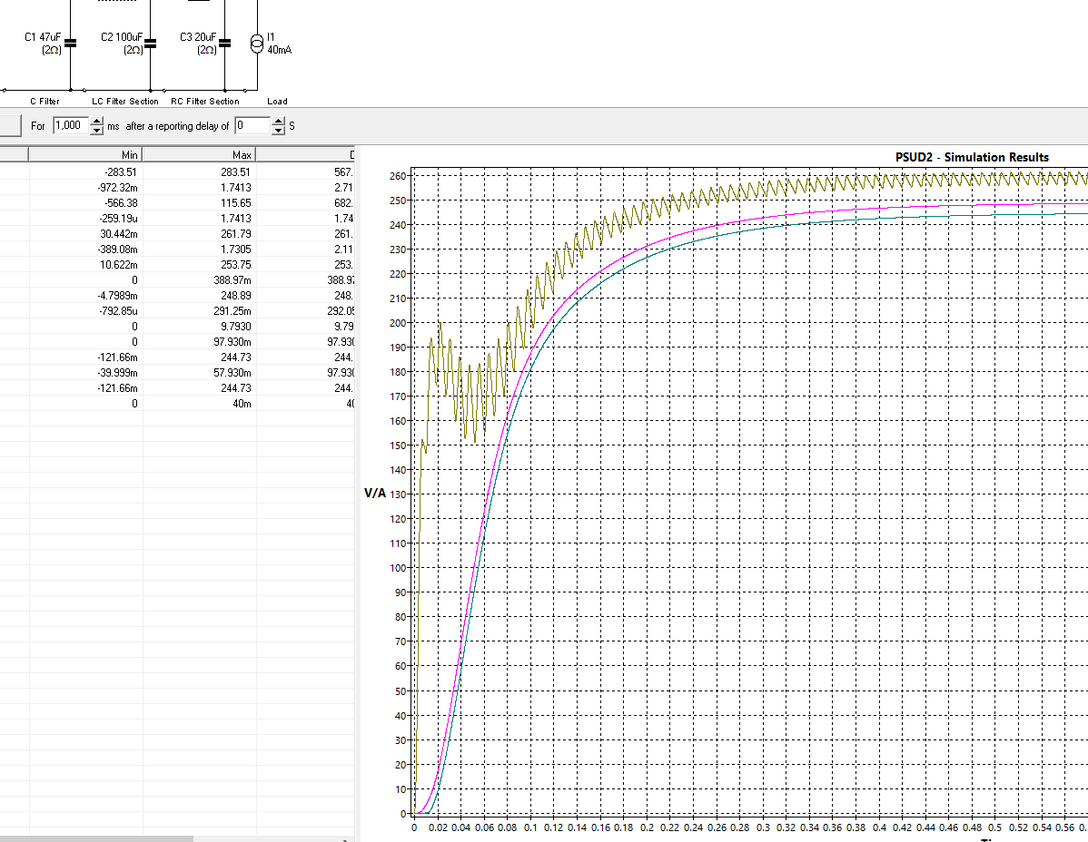

Thank you, again, @Thekak . After a bit more reading and simulating, I've settled on a paper design that I'll breadboard. Multistage seems to be the way to go, and I'll have about 200-300 uV of ripple.

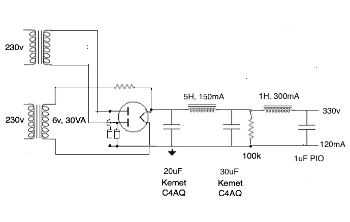

PSU is GZ34 in hybrid bridge > 20uF > 5H > 30uF so CLC. Caps are DC Link. AC ripple is 10V on first cap and 250mV on the second cap.
So maybe add a further LC?
You want to aim for sub 30mV ripple on the opt to give sub 1mV noise. On the speaker terminals, assuming 30:1 ratio on the impedance between DHT and output.

Right now, your process of pulling the letters C-L-R out of a hat and arranging them with arbitrary capacitor values could use improvement!
I doubt that you would expect that adding a 1H choke followed by a 1nF capacitor would lessen ripple. So why would you expect a 1uF cap to? You're dealing with 150 mA here.

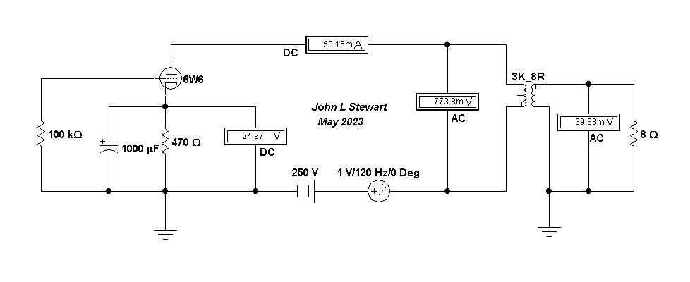

2. How much ripple for a single ended amplifier?
an example of ripple at the output of a single ended amplifier, to illustrate the concept, so you can calculate it yourself on your design:
2A3 output tube; 3000 Ohm to 8 Ohm output transformer.
2A3 plate impedance = 800 Ohms
Suppose the B+ ripple = 20mV
20 mV x 3000/(3000 + 800) = 20mV x 0.79 = 15.8mV ripple across the 3000 Ohm primary.
Root: 3000/8 = 19.4 turns ratio
15.8mV / 19.4 = 0.81mV (810 uV).
How about that!
How much ripple will you allow?
Depends on . . .
104dB/watt speaker
83dB/watt speaker
speaker in the living room
speaker 1.5 feet from your ear, right at your computer
Very sensitive headphones
Very in-sensitive headphones
I listen at 2 meters (6.6 feet), and at 2 feet too.
I pound my amplifier output hum down to be less than 100uV (< 0.1mV).

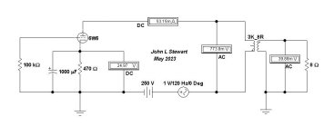

First of all for PS B+ problems it doesn't matter a Rat's Patooty whether the tube is DHT or IDHT.
What natters is the mu of the tube. The hum problem is much worse for low mu toobz with a low plate resistance (rp).
A voltage divider is formed by the tubes rp & the OPT. In the Sim that would be the 3K of the OPT & the 6W6 rp as a triode,
a bit less than One K in this case. The result is the One Volt PS ripple mostly appears across the OPT primary.😳
Bottom line, low mu toobz need a lot more PS filtering. 😀

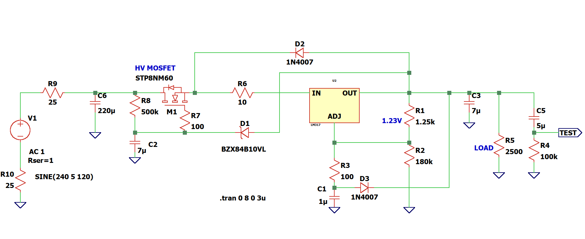

I included an example of a MOSFET/LM317 regulator for a preamp . LT1086 or LM317L is also usable here.
R8 + C2 gives a 7 second gradual startup. (I have a bunch of 7uF film-caps on hand, otherwise any suitable RC combination can be used.)
R6 can be used for a cheesy current limiting/protection with the value of the Zener diode.
The MOSFET burns off excess energy and needs to be heat sunk. The LM317 is set to drop out 3.5V (with the 10V zener) and limit the heat load of it here to 1/4W.
LM317 has low gain above 10KHz and bypass caps dominate noise performance above this, which hopefully should not be much needed.
Checking audio circuits with an scope is good to make sure some HF does not mess it up.
