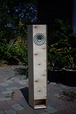

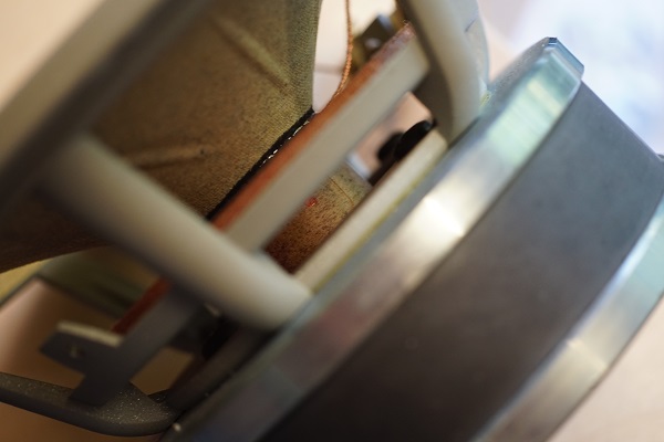

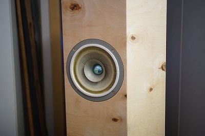

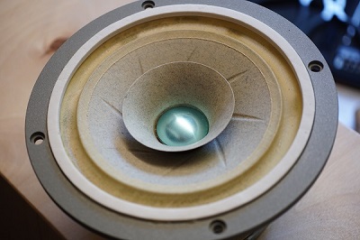

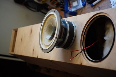

Dear all,
even though it´s technically possible, I have a hard time thinking about an 8-inch aluminium driver, doing 13 mm excursion and trying to produce correct treble in the same time...
I have not checked the moving mass for the SB units, but in my opinion a wideband unit has to be relatively light, with a strong motor. This will, of course, compromise the bass output, but it´s about compromises in the end. I believe that the fact that most wideband units have 3 or less mm travel one direction is there for a good reason, and to circumvent the bass compromise you´ll need a real woofer. This will be better in the bass region, and it will be better in the upper part of the spectrum as well, due to stress relieve for the wideband unit.
Of course, it´s possible to build a two-way with a high crossover frequency, and then you´re free to choose from several more units, but I feel that this is not the direction the TO wanted to go. Entirely possible, though, with it´s own set of troubles and compromises.
I have experienced the "real" fullrange set of compromises once more recently, when I suffered a sudden productivity boost and made myself a small loudspeaker, cheap and cute (see below, total cost a lot less than filter parts for my main speakers...). Actually, it´s quite OK for moderate levels, but of course dynamic restricted, and I need it just as a replacement for my main speakers during works on the latter. Still need to do a few measurements and design a filter...
All the best
Mattes
