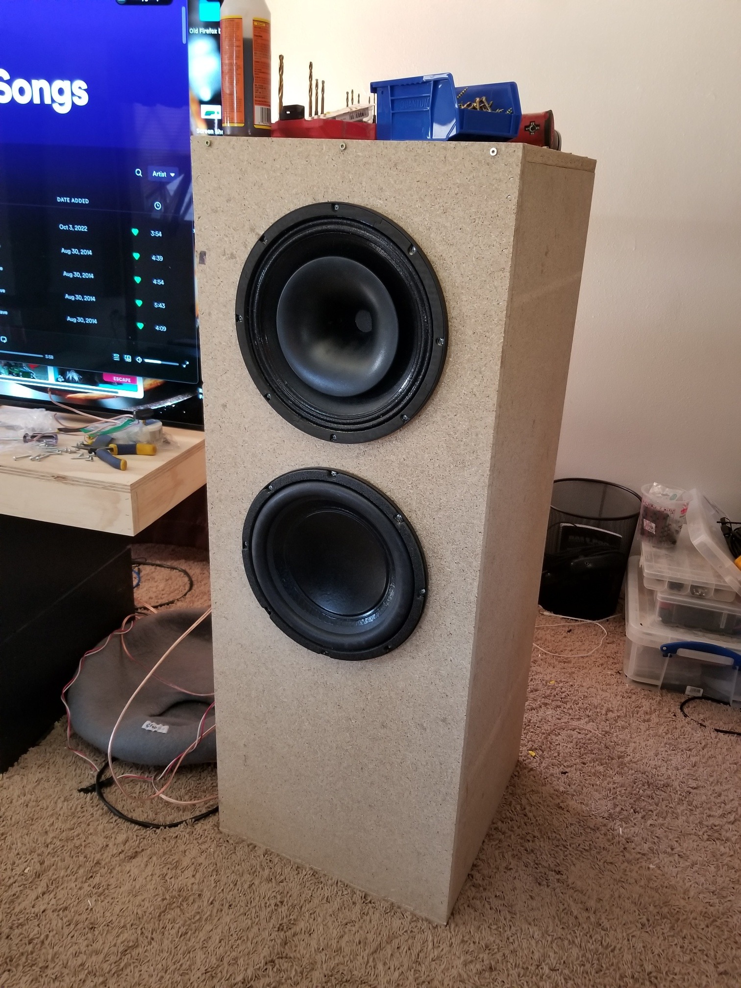

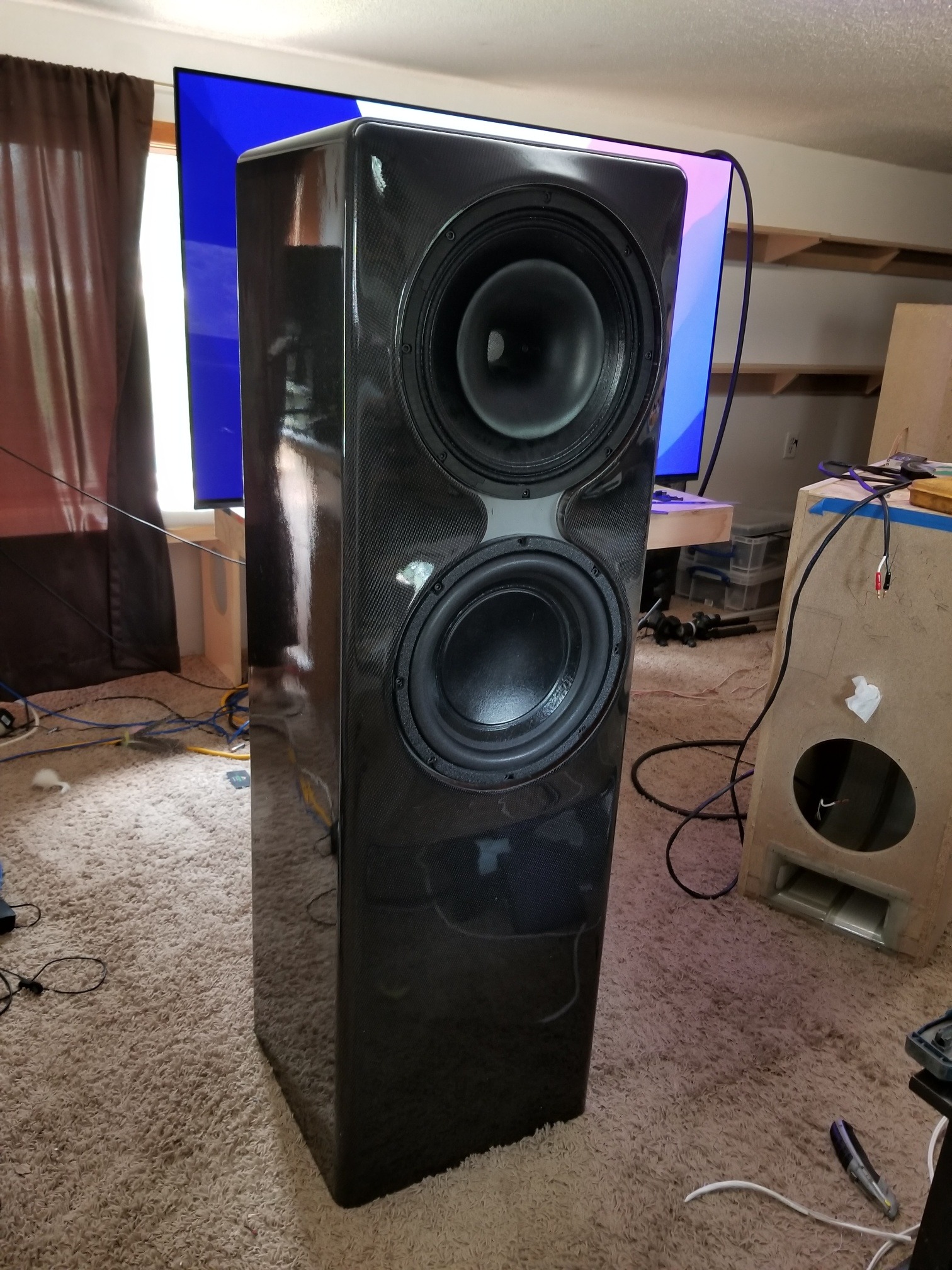

My project has moved on quite a bit since my last post here. I now have speakers that use B&C 12FHX76 coaxials.
Before I got them I purchased a pair of Beyma 12CXA400ND drivers on Ebay for seemingly a killer price. They ended up being New Old Stock. By the date markings they were 10 years old, and they were damaged when I received them. It might have been shipping damage since they were shipped in beat up old boxes with no padding...or maybe they fell off a truck years ago? I returned them, and then bought new B&Cs for the price I paid for the Beymas. I would have loved to keep the Beymas, because they seemed like excellent quality.
But the B&Cs are nice too. They are a bit cheaper, and the difference seems to be that the wave guide is plastic, and the cone is pretty thin. The B&Cs "can" play down to 100hz, but they develop a steep spike in distortion starting at 120hz. I avoid that by using a steep filter at 120hz.
By comparison, I think the Beymas would do better for lower frequencies due to the stiffer cone. But it isn't make or break in my case, since I am able to use a slightly higher crossover frequency. Maybe the B&Cs are better for midrange because of the lighter cone? I don't know.
What I liked about the Beyma and the B&C is the visible horn wave guide. I think it is better aesthetically, because it would feel strange to hear high frequencies coming from a 12" cone.
I was not able to compare the two coaxial drivers in an A/B test, so I can't say if one is better sounding. But I can say that the B&Cs do sound quite accurate and direct/ detailed. I am enjoying the fact that I do not have to be in the exact right spot to hear all the details.
I have not seen any benefit to setting up the speakers to have directivity, so I have them configured as a multiple subwoofer scheme. I have achieved roughly flat response throughout my room just by manipulating delays, even in spots that should be terrible!
I also abandoned the woofer + PR arrangement. This speaker design starts out being quite large, so I'm trying to make the cabinet as small as possible. And getting rid of the woofer + PR arrangement let me save some space. (And the woofers seemed cheaply constructed compared to the coax and subwoofer.)
Instead I landed on the Eminence Lab 12 for the front woofer. It plays down to 45hz in a 30 liter cabinet. I did a lot of searching, but I was not able to find anything else that could play low in a small sealed enclosure. The Lab 12 barely extends above 100hz, but I am able to cross it over at 120hz to meet the coaxials. (I could have used any subwoofer driver, but I don't like the bulbous surrounds that most subwoofer drivers have. So the Lab 12 works aesthetically for my design, since the surround is not as large as others.)
Currently I have been experimenting with subwoofer port designs. I have tried a few already, experimenting with port cross sectional area and port type. More detail on that will be posted in the subwoofer forum.

Photo is the most recent cabinet featuring the B&C coaxial. This cabinet has 2 ports running vertically and exiting out the back. Ports are about 30"x 4". Cabinet is tuned to ~20hz.
This cabinet is 18"x18"x48" tall, and I intend for the final design to be 16"x16"x 54"(?). I think this optimizing of the design is the tricky part of speaker design!
