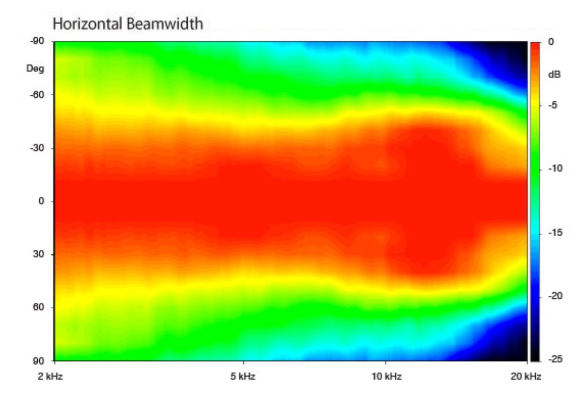

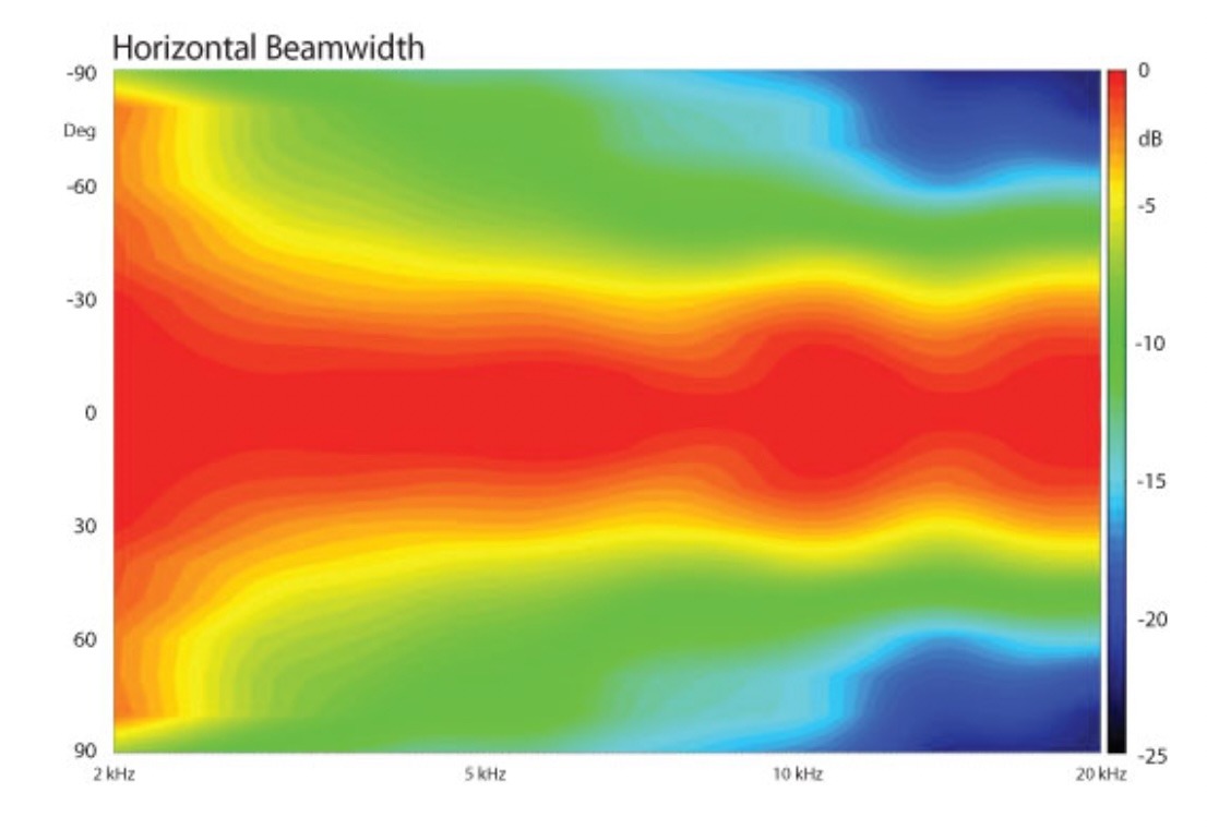

Faital has something nice in 12" coax...110° aperture. Maybe a little too much in vertical dispersion but surely nice in horizontal as the usual biradial that open till 120° works fine in home areas. The ferite Faital 12hx230 is less expensive that the neodynium one.

In my view 120* is too large for monitoring purpose ( pro quality assessment).
The early reflections might add something for recreational listening ( however this is preference related), if for working there is too much coloration (it is misleading).
90* is a good compromise, 60* improve on accuracy but might lead to too narrow a sweetspot for my preference.

Another point why i talked about the Bms 12c362 is it have a nearly constant directivity behavior from 1khz to 5/6khz ( edit:4,5khz).

What is the off axis constant directivity that is good enough for home in stereo ? 45° should be more than enough if you are at the top of the triangle listening area ?
Well as said before it is not feasible with that big driver that ask big overlaps but perhaps low order slope for longer overlapp or without some help . Being horn or/and FIR.

For my use, a 45 degree (actual) directivity would be enough for covering all listening positions. Most are rated for 80-90 or more, but I'm starting to notice that they are narrower than their rating implies, if you are expecting a deviation of only a few db.What is the off axis constant directivity that is good enough for home in stereo ? 45° should be more than enough if you are at the top of the triangle listening area ?

I was looking at Faital's graphs vs their stated directivity, and their rating of 90 degree directivity looks more like 60 degrees to me. But I assume they are taking an average, and they are allowing a certain tolerance of spl variation to arrive at 90 degrees. I'm sure that this is true of every company, and Faital probably shares their data knowing it is better than other products?

This is for anyone who would like to contribute: Pleae consider these polar maps as if they represent a typical coaxial design. One is a 6" coaxial and the other a 12" coaxial.
This image is the 6". The crossover is meant to be at 1.7khz, so the crossover is below the range of this map. But clearly there is a significant change in pattern width between 2-3khz. What is happening here? Is the 6" cone too small to create controlled HF under 3khz
Here is the second one. This is a 12" coaxial. It appears that the pattern might be widening at 2khz, but we don't know what happens next. Assuming a crossover of 1.2khz, what is the high frequency pattern doing at 1.2khz? Is it suddenly omnidirectional? Or does it gradually widen in proportion to frequency?
