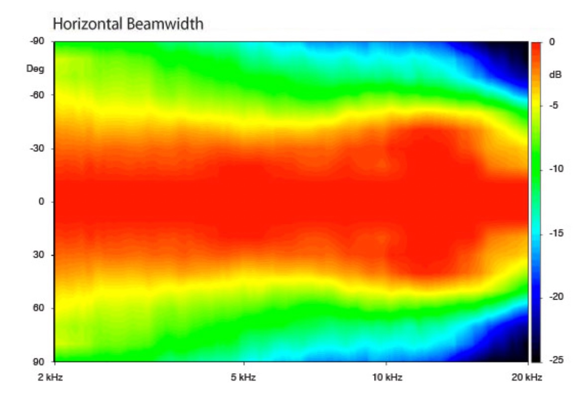

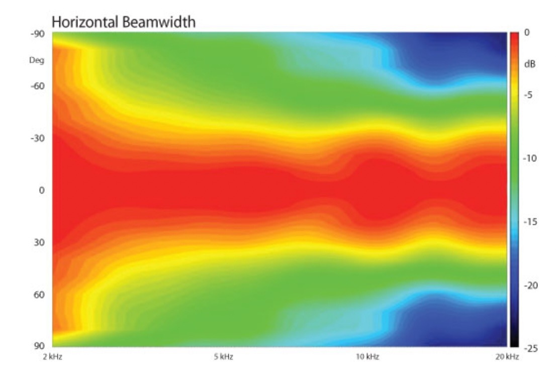

This is for anyone who would like to contribute: Pleae consider these polar maps as if they represent a typical coaxial design. One is a 6" coaxial and the other a 12" coaxial.
This image is the 6". The crossover is meant to be at 1.7khz, so the crossover is below the range of this map. But clearly there is a significant change in pattern width between 2-3khz. What is happening here? Is the 6" cone too small to create controlled HF under 3khz
Here is the second one. This is a 12" coaxial. It appears that the pattern might be widening at 2khz, but we don't know what happens next. Assuming a crossover of 1.2khz, what is the high frequency pattern doing at 1.2khz? Is it suddenly omnidirectional? Or does it gradually widen in proportion to frequency?

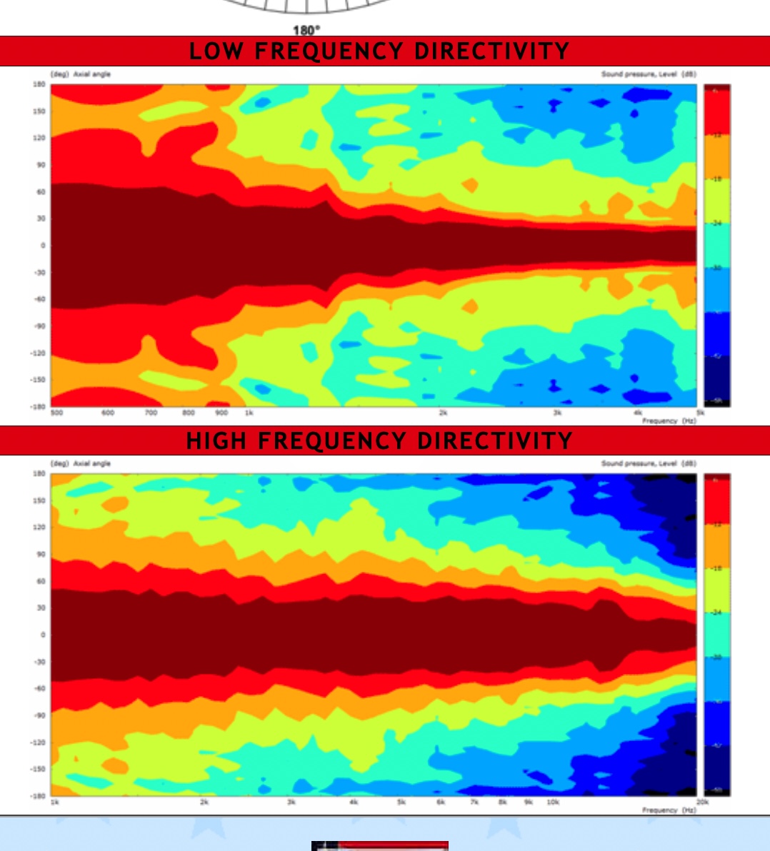

To the question of the directivity maps I posted before, is it safe to say that the horn beams at the same frequency as the driver it is installed in? We talk about how the horn uses the woofer as the wave guide, but I was not sure to what degree this works.
But if so, then the pattern is omnidirectional until it approaches the driver's beaming frequency, and the horn is essentialy beaming at the same frequency?
I wondered if the HF pattern might deviate from the 12" driver pattern. But it seems it does not?
Then that would be the answer for D1sco!

BTW, that beamwidth measurement seems to be just the tweeter. It seems to imply that the driver loses constant directivity around 2k with either model. I would question the woofer moreso in either case.
Yanno, I've never actually seen an example or diagram of midbass woofers actually working as waveguides, so I never 100% put faith in any given driver to behave as it's sold. I definitely should be accounting for this, but good pointing it out. I'm talking about Constant Directivity, like you are, and my concerns that a wide coaxial design will likely have a few big directivity spikes but ultimately the same nulls before the crossover region. It's tough to keep the shape of the beam perfect in a wider design. As I'm sure you know, the added reflections color the sound in-room. Which definitely brings me to the next point...
@fredygump how are you going to measure this anyways? I think it's one of the reasons people ask why you're doing your own design vs. copying an existing, proven one. Without being able to measure directivity and model appropriately, it could take a long time to get everything perfect.
I wasn't too impressed when Adason said I should do a "proven" design, and you choose to ask the same question in the same words. This question just reveals your biases. It really makes me wonder why you want to participate in this conversation at all!
You are correct that the beam width measurement is only the horn, because only the horn is playing at 2khz and above. The interesting part is that even though the cone is not making any of this sound, the pattern narrows dramatically at the beaming frequency of the 6" cone, the same as would happen if the cone were generating the sound.

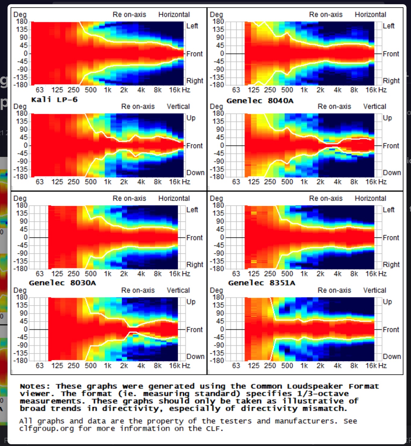

I found this polar map comparision of several well known speakers. I think it's great because it includes the Genelec 8040A, speakers I used to own for a few years. So it gives me a nice reference when trying to understanding what the polar maps mean in the real world. (imgur.com/F5rFf35)
This appears to be good news, because I thought the 8040A was quite good, but here it clearly has issues in the vertical. These are the issues that the coax does not have.
And I missed these before, but on the website usspeaker.com includes polar maps for B&C drivers. It is interesting. I looked at several, and there is always a close similarity between the two. But not exact. The horn is slightly wider than the woofer beam on all of them. And it takes a few moments to examine them, because the range is different on both images. The top one is 500 to 5,000 hz, and the bottom is 1khz to 20khz. (This image is for the B & C 12CLX64)
I doubt it proves anything, but just more data.

Their design is interesting. I just found a paper about the design of the Genelec 8300 speakers, and I instantly saw principles from the Genelec design in the KEF speaker. For example, the paper explains how there can be issues at the edge of the wave guide, so the entire front baffle should be the wave guide. And KEF is accomplishing this with the baffle being a continuous curved surface.
I will take your suggestion and read some of the KEF white papers as you suggested a couple times!
The only logical explanation I can find is that it doesn't matter if the sound is generated by the horn, or if it is generated by the cone itself.

I think there is a misunderstanding: the constant directivity can only be achieved through the use of the waveguide itself.
The woofer parts cannot have a constant directivity by definition: we use it's beaming range to achieve directivity match with the waveguide which then can achieve a constant behavior over a wide range.
When 'constant directivity' is claimed for a reference it can only be valid for the waveguided part of the spectrum. But i've not met a lot of reference doing so.
The fact the Bms have a range which behave as if it had constant directivity is a nice discovering ( independent measure) and the brand don't advertise about it ( but in no way i think it is an accident/random).
I'm not this concerned about the membrane profile of coax. about the directivity behavior, more about the diffraction which can occurs.
