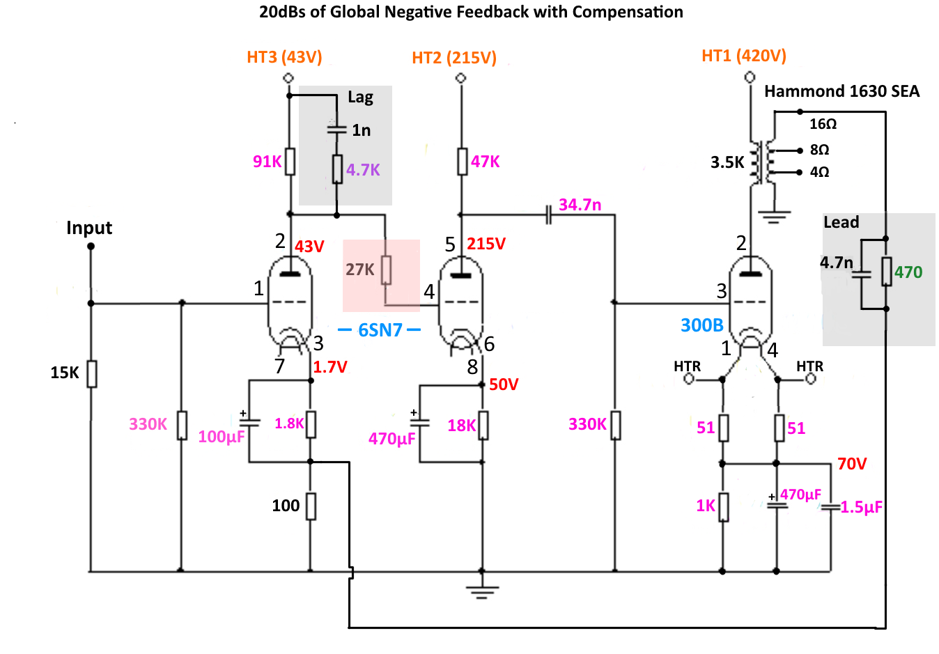

Jack Elliano has a direct Coupled 300B thats been in my folder called "my first 300B" schematics for some time. Just throwing it out there because it is so simple and that multi tap resistor sure makes it easy to trim the operating point for a direct Coupled amp. Ultrapath cathode bypass. 700 V is high for a beginner like me, but I'm careful. 300B should love 700V. I have a One Electron OPT waiting to be used, but Id order the 60H chokes from Jack. Then later get some OPT's from Jack as well. I think DRD is Jacks abbreviation for "Direct Reactance Drive".

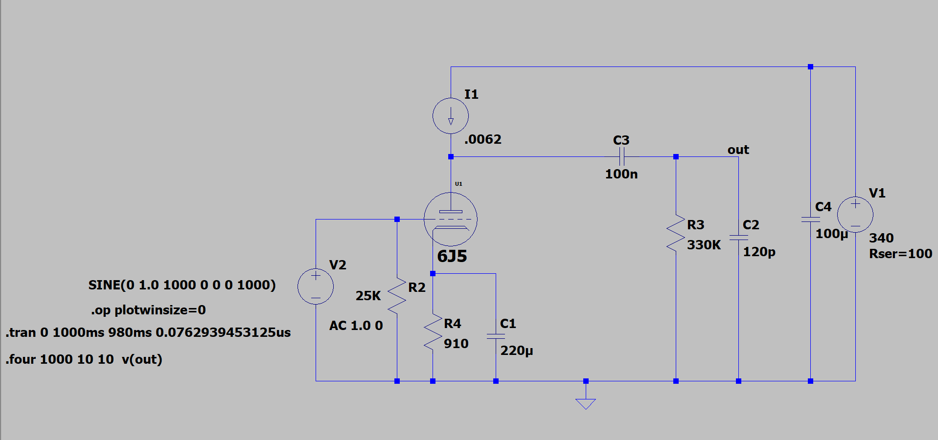

Single Stage 6J5.

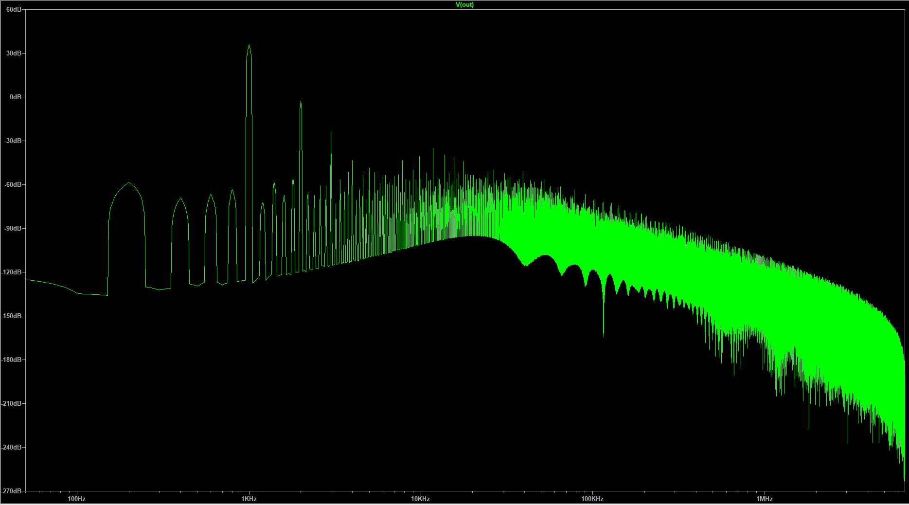

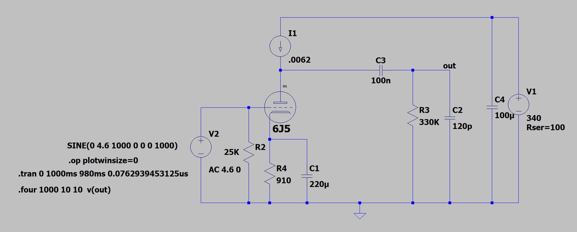

A single 6J5 with a CCS as a load gives exactly what is needed to drive a 300B - plenty of linear volts with very low distortion. 90 Volts for an input of 4.6 (LT Spice uses peak volts).

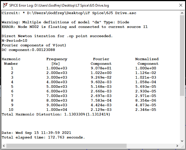

Thanks for the responses everyone, I have considered all of them and decided to go for a no GFB design given that is what I have been enjoying with my little triode connected EL34 amp.
And yes my heart is set on a 300B or 6C33C.

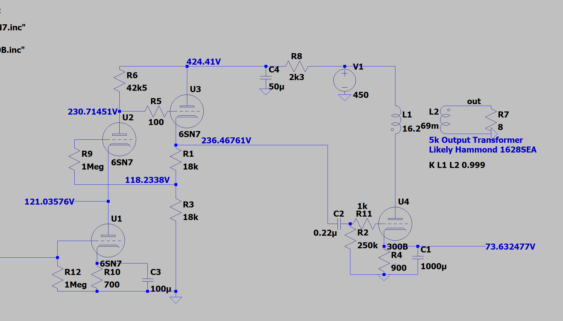

Looks like I won't be able to get the 6BM8 circuit to work satisfactorily, so how about something like this? I realise it's not exactly a beginner circuit as it will need several elevated heater supplies, but it seems to offer the most promise. The only major shortfall I see is the low operating voltage of the input tube - way outside the linear region. I pushed it up about as high as I can. Wondering if maybe I should try a 6922 or 6DJ8 in this location perhaps...or any other readily available suggestions?
Look forward to your feedback.

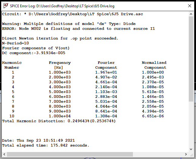

I went through a period of making lots of models of SE 300B amps and found that they all wound up with THD of about 0.5% at 1W rms output. That's predominantly second harmonic, true, but that's still considered to be an audible level of THD.
Is that par for the course for SE 300B amps that do not use global or local NFB? Or are there topologies that produce lower THD than that?
Do load-lines on the design and you will find it is totally unacceptable. Best redesigned as wither cascaded CC stages or a Cascode driver.
Of course, it's par for the course. Isn't that what we like about tubes - I prefer to call it colouration. Although I do believe in a fairly distortion (colouration) free driver section. It allows the 300B to shine through.
I use a CCS as a load in the driver stage for the 300B. The load-line is almost horizontal, when a large value of Rg is used for the 300B. Here, distortion is 0.25% with 1 Volt peak input at 1KHz.

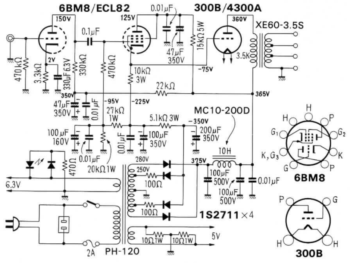

Thanks for this Windcrest77! I like the 6BM8 cathode follower idea. For those who haven't read the link I attach the relevant schematic below.
I would like to build an amp similar to this one. The key difference would be that I would use a tube rectifier for the B+ supply and solid state rectifier for the negative supply to ensure the bias supply reaches full potential first. I may also contemplate a CCS load for the input tube.
Now a quick question... The cathode of the input triode is at approx zero volts (give or take). The cathode of the pentode is at approx -75V, and likely to go much lower than this to drive the 300B to full output. Given the two devices share
the same heater and max Vhk for the 6BM8 is 100V, what is the best strategy for the heater supply? Should it be elevated (de-elevated?) to minus 50V or something? Or best just to tie to ground as per the schematic?
Also, can someone explain the purpose of the diodes and 470R resistor in the 6.3V bias supply?
