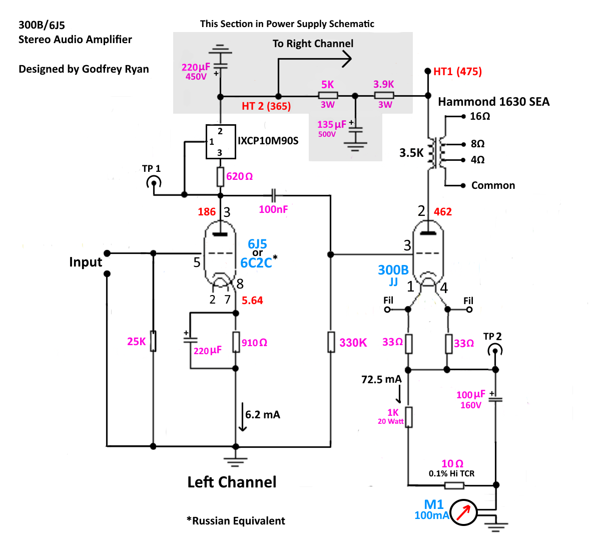

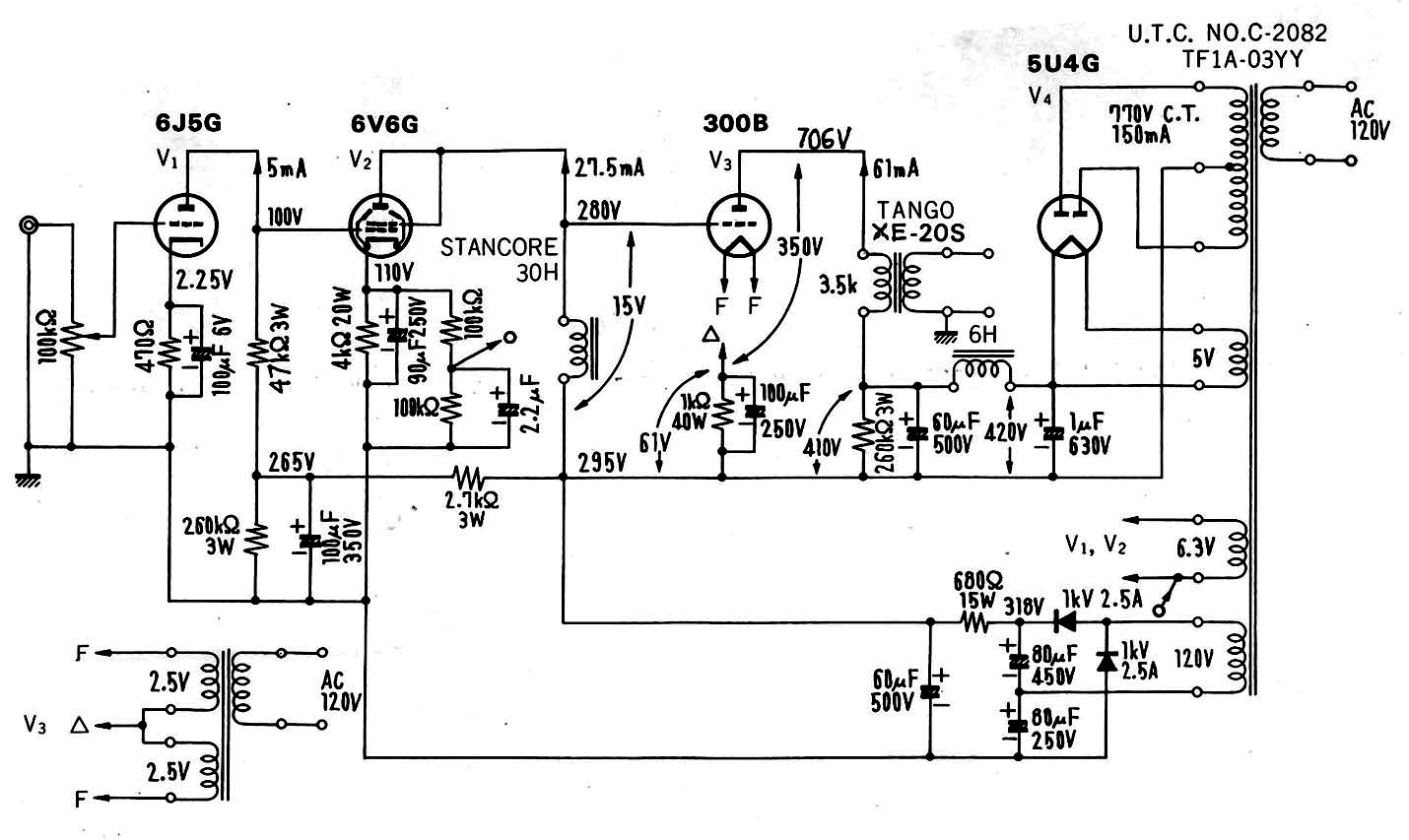

The schematic posted at message #1 is a Shishido design according to JC Morrison and it has been used by Sun Audio for both their 2A3 and 300B amplifiers since the 1980s and, as far as I know, is a current product you can buy as a kit.
JCM included the schematic as one of a couple dozen in a pamphlet of mostly Japanese designs he published about 1995. Someone has exploited JCM's name to draw attention to this schematic and that means some falsely believe that since it was published by him (as well as Sun Audio), that is an endorsement, when actually it was intended to show what others had done and be an avenue for exploration.
OK, that said, if you want to build a more modern design, the high Gm pentodes, when triode connected, can drive a 300B to full output (something the Sun Audio can't do) with about 1V input sensitivity. This assumes a DAC or CD player with 2Vrms output and a volume control at the input. The EC86 was already been mentioned as is a great tube capable of driving the 300B to full output and is an inexpensive and reliable triode. I use it in my 2A3 amp and use the EC8010 which is more expensive and difficult to find in my 300B amp.

Thanks for the responses everyone.
Sounds like a no go so I will keep fiddling and come up with a no feedback design. I have a bunch of 6BM8's and would like to use them if possible.
The basic circuit sims pretty well even without the GFB loop but is probably too sensitive, needing only 0.1- 0.2V for full output.

Why not try this one. It's a modification of a previous design I did. It uses a resistor instead of a IXCP10M90S CCS. (Much safer if you are using expensive 300Bs) You might need to change the 300B's Cathode resistor, depending on tubes used. Disregard the 72.5 mA - that was what I set the CCS to in the original design. It needs about 3 Volts RMS input for full power output, so a good pre-amp will be necessary. You might need to experiment a bit, but it might give you ideas.
How can a 6J5 (mu = 20) drive a 300B to full power all by itself?
Let's say you get all of the 6J5's gain, so 20X (just for the thought experiment).
Let's say you run the 300B with a grid bias of -70V (or +70V at the cathode for cathode bias).
In order to get 70V peak at the 300B grid, you'll need 3.5V peak signal at the grid of the 6J5 (3.5V*20 = 70V).
For most systems, you'll need to add another gain stage in front of this design, which ends up being basically the same thing as the Sun Audio circuit in post #1.
Someone else mentioned a C3a-triode as the voltage amp/driver stage for a 300B. That's basically the same as what you have here, but with a C3a-triode instead of the 6J5. That would work because the mu of a C3a-triode is high (although I don't know exactly what it is because I can't find a C3a data sheet). FWIW, mu of a triode wired D3a is listed as 80. You could probably get 50X gain out of one, which means it could drive the 300B to full power with about 1.5V peak input signal (1.5V*50 = 75V).
3.5V Peak is 2.475V RMS. Perfectly doable here, easily within the capability of a good pre-amp.
A good preamp is exactly what the first stage is in the circuit shown in post #1.

So the circuit we have in post #1 is a 3-stage circuit (like Herb Reichert's "Flesh and Blood" amp in Sound Practices), using a 6SN7 cascade to the 300B (with OPT). There are other circuits that could be proposed.
1) A two-stage circuit using high-mu, high-gm pentode-wired-triode as the voltage amp/driver RC-coupled to the 300B (with OPT).
2) Use a high-mu triode like 6SL7 or 12AX7 (ECC83) to supply the necessary voltage gain, followed by a source follower or cathode follower to supply the current gain and low impedance for driving the 300B.
6SL7 can be used with a large value plate resistor or CCS in the plate to yield 50X or more gain, which should be enough. A 6SN7 or 6N6P could be used for the cathode follower, or a low Crss MOSFET (like ZVN0545 or FQP2N60) could be used as a source follower.
3) Since this is a 300B amp, and presumably price is no object, one could use a plate choke-loaded power triode (low mu) to drive the 300B, with a 6J5 or 6SN7 as the input voltage amp. Noryasu Komoru built a 3-stage all DC-coupled 300B amp using 6J5 > 6V6-triode with plate choke > 300B that I heard. It was a beautiful sounding amp.
4) or of course one could use an interstage transformer between the driver stage and 300B. That would cost real money.
So many possibilities.
However, the one in post #1 can be made well. Why not?
