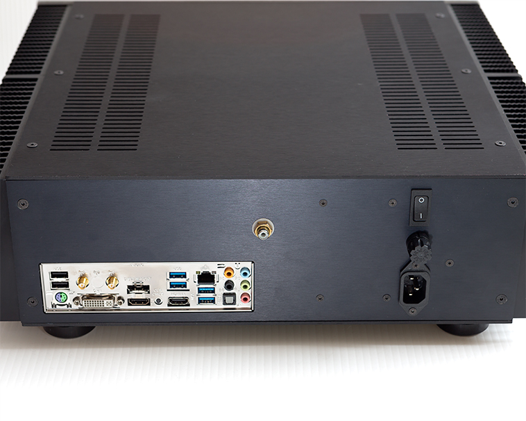

Ok thanks. Obviously this enclosure is multiple panels, assembled and screwed together. I will make sure there is a route to the safety earth connection for each. I should have made the PCB mounting holes such that when screwed to their standoffs a connection from ground to chassis was made.
I take it from your response that "exposed" is determined with, for example, the lid of the enclosure off so that the PCBs are accessible.
No.
With the equipment fully assembled and plugged in ready to use:
Are there any exposed conductive parts.

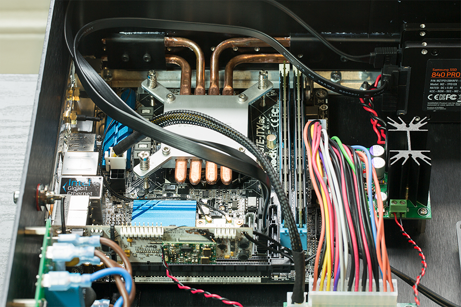

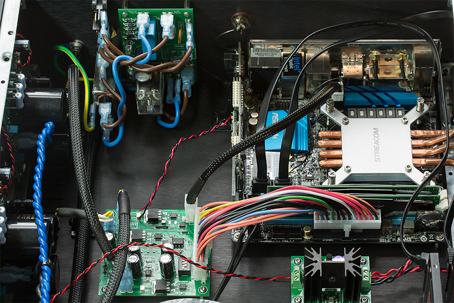

Thanks. I will take a look. I've spent the last couple of days assembling everything into its enclosure which was a learning curve in itself. Memo to self: Leave more room in the corners for access to interior assembly bolts/nuts. I will try to take some pics in the coming days.

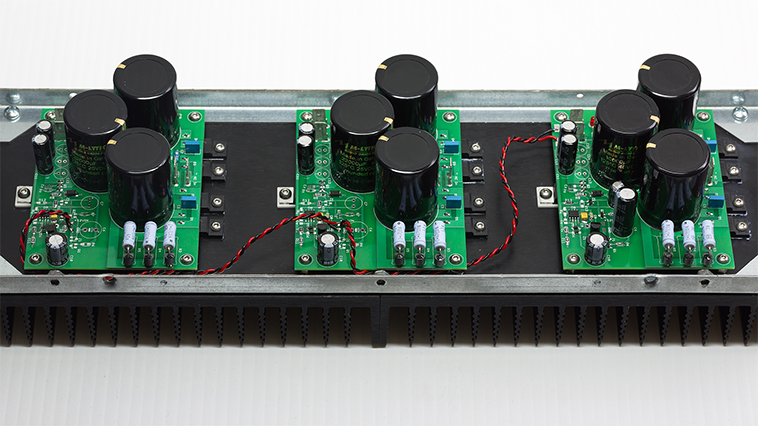

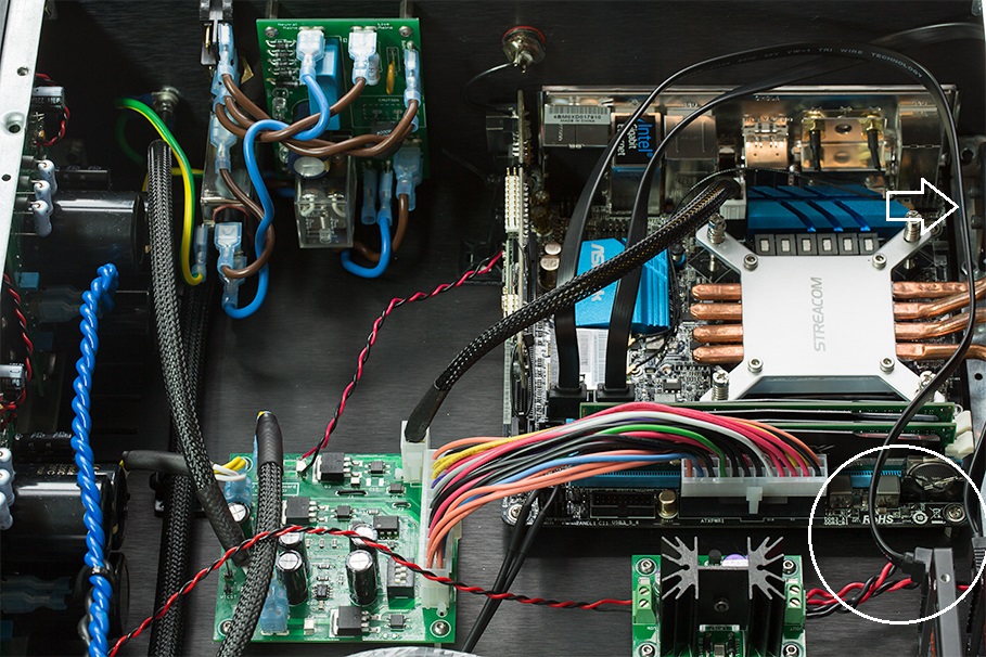

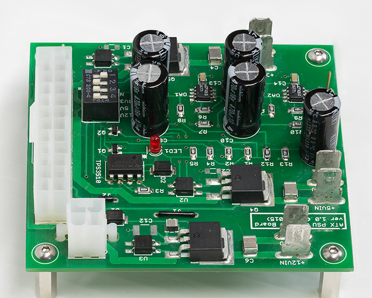

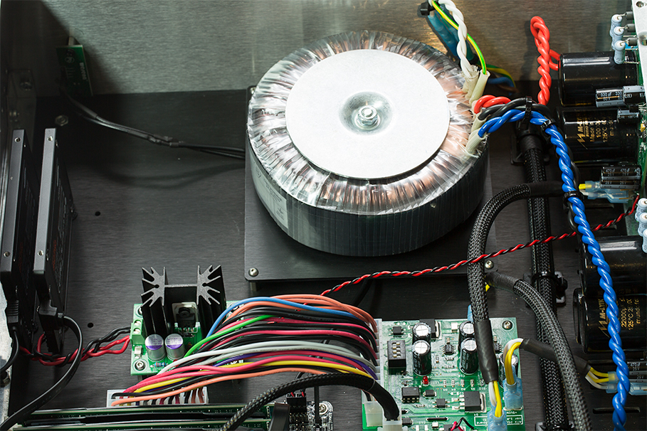

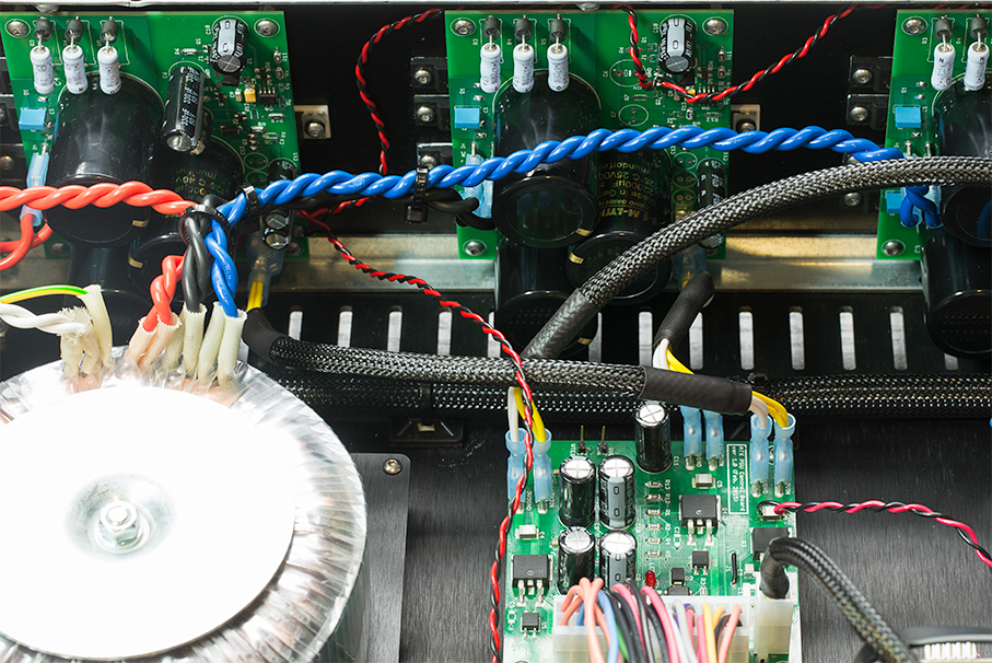

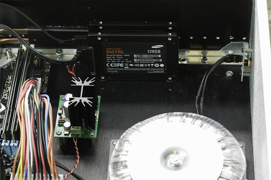

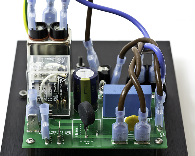

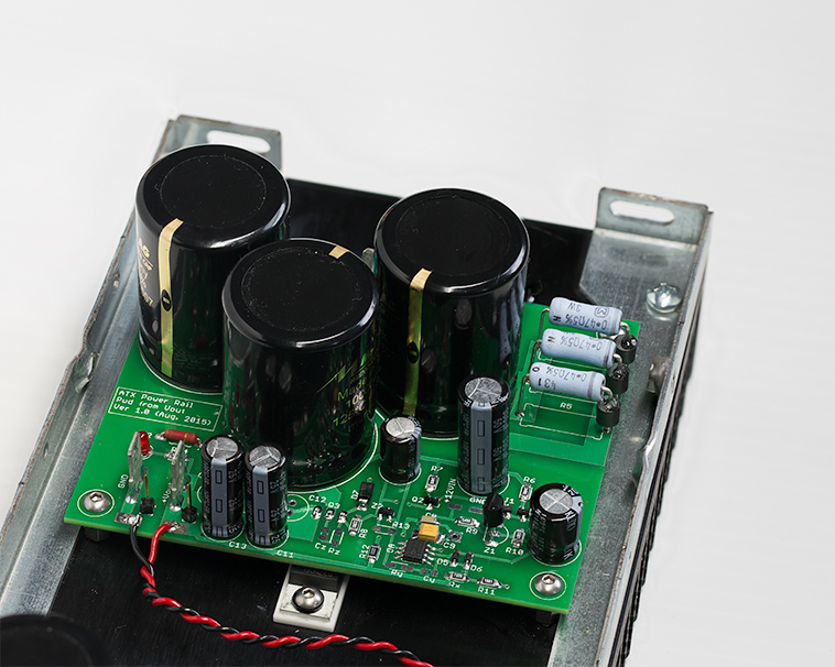

Here's a few pics of the interior. Yes, some of the cabling is overkill. Please anyone, do let me know if you spot things that should be corrected.

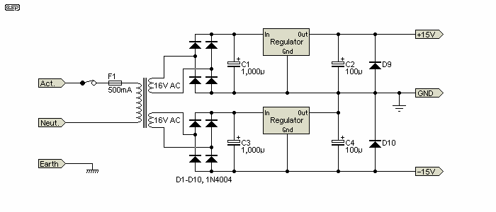

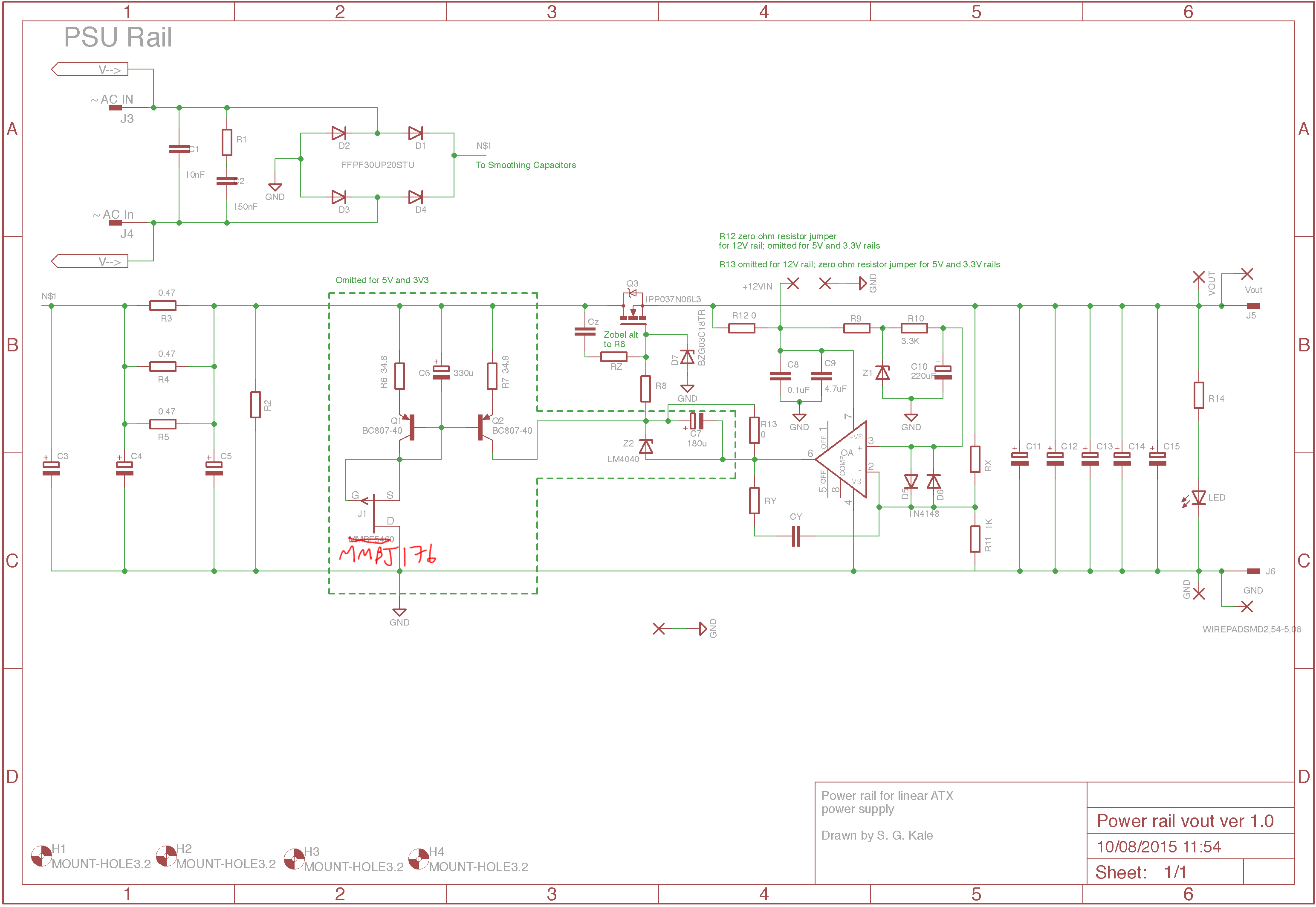

I have one question with respect to Fig 11 from Rod Elliot's article on Voltage and Current Regulators (here). I have reproduced his graphic below for convenience. How should one determine appropriate components for the protection diodes D9 and D10?
Also, if I were to use two of my spare PSU boards in this fashion, the negative rail would have the board's GND plane be the -12V supply and the Vout traces would be GND. Is this reversal of GND plane and traces a problem/bad practice/detrimental to quality?
These are discussed in Cordell section 15.3.2 "Rail Fuses".How should one determine appropriate components for the protection diodes D9 and D10? (these are the reverse biased diodes between (a) +supply and GND; (b) -supply and GND
I suggest that those diodes should be rated for a current at least equal to the larger of (i) (Vprimary/Vsecondary)*Primary_fuse_current ; (ii) the current rating of the downstream fuses in the DC rails ; (iii) the output current limit value of the voltage regulators
Me, I would use what I have in my junkbox: the FES16DT (datasheet). 200V, 16A, TO220, $1.07 qty=1. It's got a metal tab; maybe you want an all-plastic TO220 instead, since this diode will never get hot.

The audio server has been running continuously for a few days now and seems to be working well. The supply runs a bit warmer than I expected but not hot. There's a faint buzz from the transformer, but it is audible only in a silent room with one's head within a foot or so of the unit. It isn't yet plugged into my Isotek power conditioner. (It will be interesting to see what a difference that makes.)
I'm very happy to finally have this thing running.
I'm enormously indebted to you in particular but also to others who have helped me do this. Thank you.
Thanks. I will take a look at Cordell. I haven't a specific place for these diodes on the PCB and so will have to jerry rig them over the Faston connectors at the output or similar (so something insulated makes sense). I guess I could use spare FFPF30UP20STU which I am using in the rectifier bridge but I was hoping for something smaller. I will have a look around.

I notice an LED next the power switch.
I'd be glad to send you a "breathing" LED driver that slowly ramps the LED's brightness from 0% to 100% and back to 0%. It's an 8 pin thru-hole DIP (3.3V or 5V power supply) that can source 20mA; if your LED needs more you can install an external 2N7000 or BC547 to boost the current. (the IC is a PIC10F222).
Here are some youtube videos that show the basic idea; I would of course personalize the chip to ramp the LED brightness at YOUR selected frequency with YOUR selected min, max, slope1, and slope2.
Breathing LEDs are ever so much more soothing than constant-on, or on/off blinking.
