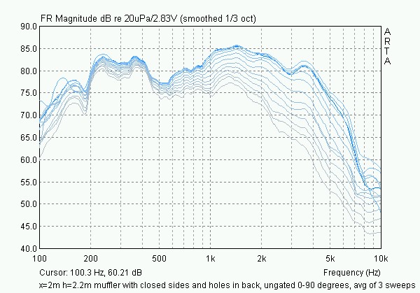

OK, let's hope we can sort this out w/o acrimony. I seem to have way overexplained everything until the main points got lost. And yet I have to do it again.
1) The missing off axis data of post 69.
Two days ago I built 2 more test baffles and measured them. One was a larger, 12" muffler, by popular demand. Another was the smaller 9" muffler but with a short tube simulating an U-Tube (sic) baffle. But I made the mistake to fire my off axis into a wall that was too close, and got too much reflections. So the off axis data were usable only with gating. But in all my graphs before I had shown ungated curves to preserve detail and I want things to remain comparable. So I compared what was indeed comparable, which is the ungated curves, which forced me to restrict myself to narrowly on axis responses, in post 69. The first two data sets of that plot btw have previously appeared in full 0 to 90 degree and even sonogram / polar plot incarnations. So, 360 degree hi res data on the first two curves have been shown before, and for the last two curves, don't exist yet.
Why do I prefer to show the measurements ungated? Because, next controversy:
2) John's plot and the missing knee.
I referenced the existence of a knee, or shelf, or resonance, or bump, in my post 16 . In that post, I further reference to a page by Siegfried Linkwitz where SL describes this phenomenon. He explains it as a result of the lowpass behavior of the back of the driver on any dipole baffle, leading to aberrant rolloff behavior in practice, as opposed to theory. I am not sure if he's right on the cause, but over the years, I have seen this bump in all my dipoles so I wasn't surprised, and it also shows up in all of Linkwitz's raw measurements. He EQ's it out, typically with a notch filter of Q around 3 and amplitude -4 to -6 dB, also my experience.
Since our muffler has some kind of radiation coming out the rear, some practical dipole effects have to be anticipated even in the cardioid experiments, and my data show the knee as well. Now why no knee in John's plot? I actually don't know, maybe his device does not exhibit this effect. But the plot shown by John in post 71 is not capable to exhibit any such bump. Reason: it is gated. From the cutoff shown in the graphs, gating is likely around 3 ms. This leads to a frequency resolution of worse than 300 Hz, in other words, it is the same as if you did a full octave averaging in the 300-600 Hz region that interests us. And this would surely melt the knee. Case in point, if I treat my own data, *with* knee, first set of lines in that famous post 69 image , the same way as John's representation in his post 71 , then we clearly see that even in my data the knee has gone.
In addition to this, and to my own surprise, when I took my same 9" muffler data using the appropriate off axis angles, and plot it using John's gating, and rescale and stretch it so the scales match exactly the ones of post 71, then I find that my own data overlap John's post 71 data, almost to perfection, except 135 degree curve, and none have that knee. This I show in the picture of my post 76 . So John when you say in your post 80,
I'd haste to add that John's rear data suggest a better cardioid than mine in the low f's, then again I want to mate it with a dipole at LF so I'm ok with that polar pattern.
Hence: Gating => grain of salt
Sorry for the confusion.

Leaving aside possible reasons for a while: does my overlay plot of post 76 not shows that my 9" muffler is acting exactly like your device of post 71? Do my 9" muffler's curves for 0, 45, and 90 degrees not follow your device's curves very closely in the overlay?
The complete 0-90 degree ungated polars of my same 9" muffler here. Now compare to the same muffler but with closed sides and just small rear openings, like a transmission line type box (but a short one), in the attached file. Leave aside the undesirable lumpiness introduced, and look at the radiation patterns: are they the same?

Here we see the same data differently. What I see is this: a bump whatever the cause, in SL's various models, and in my various iterations. These bumps look different depending on driver and baffle, but they're always there. And these bumps cause an artificial extension towards the bass, of the first dipole peak, which I would like to avoid. The peak then causes a dipole falloff that is initially faster than the expected 6 dB/oct. (when the system comes 'off' thew peak).
In my 9" baffle btw. the bump is hardly there at all, and to repeat for the umpteenth time, if my muffler has it then so has yours, because our curves look identical (within reason).

I don't know what to tell you because the off axis data you are talking about, that one would have to see, I already provided them 0-90 degrees forward in all but my last plot, for something like 5 or 6 different setups, and they all look different. That's a good dozen of detailed forward FR families in 7.5 degree intervals, too many to quote in links. In post 67 I explain why this last batch I can't show all off axis angles. Then, I also showed 360 degree full frequency sonograms in post 11, in post 17 and post 18. 360 degree polars? see post 13 . You asked for lower frequency full polars? I didn't replot but explained qualitatively what happes, in post 47 which also has a plot to address measured low pass effect of my muffler.
In your post 71 you also have a substantial falloff, if I extrapolate a little total falloff rom the 1000+ Hz peak down to 300 Hz, easily 10 dB, like me. No "shelf" though, and your 135 degree data look much more cardioid than mine, though your data is really very limited. As I explained in the posts cited above, mine progressively reverts to quasi dipole below 500-600 Hz and as I said in my case this may be a good thing, dipole waiting below for X-O at 300 Hz.
And to make this complete, here is a graph drawn exactly to the model of your post 71 . This is my 9" muffler, no baffle, at 0, 45, 90 and 135 degrees, tried to window it similarly to your pic, same frequency ranges and all. At lower frequencies my lines somehow get closer and the 135 line is clearly showing a come back of the rear lobe (attenuated figure eight), else though I don't see much of a difference.
You know Markus, they are what they are. If I measured to low frequency, as I do for design work, you would see my response continue to roll off smoothly and pretty much be the 6dB/oct "dipole roll off" superimposed on the driver's given Fs, Qts response. Perhaps the shelf, or corner at 400 hz in your cases is more an indication of some type of enclosure resonance, or the effect of the enclosure loading the back side of the driver. That was my initial impression. Looking at you pictures I do know that we construct our mufflers differently and mine are not prone to allowing internal resonances. In any event, I don't think we can resolve this over the Inet.
