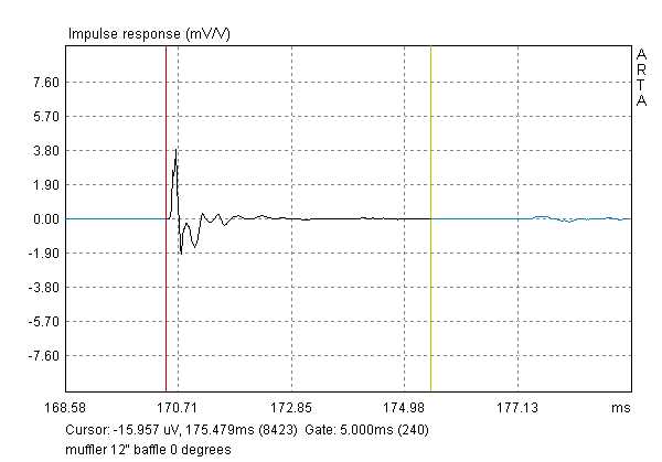

MBK said:The pic in post 15 shows the PVC pipe assembly BTW, a damped version which I also tried. But first things first, placing increasing baffle sizes (thin circular cutouts taped to front of muffler), what FR do we get?
Here is a combo of naked muffler - 12" baffle - 16" baffle FRs. The polars look less clean and at HF curves start to invert (off axis higher than on axis). The low end is lifted due to increased dipole separation distance, but at the price of a bump, described by Linkwitz here .
But still: the muffler improves a lot on the Linkwitz picture above (he uses a 16 in diameter baffle, so compare with the 16 in baffle FR graph attached, bottom). The resonant bump around 400 Hz is less pronounced, and e get no nulls higher up, just smooth on and off axis FR. The graphs of course are completely unequalized.
What jumps out at me is the line-crossing close to the zero-axis, and how quickly it shifts with small changes in emission angle.
The effects of the line-crossing are evident with the 12" baffle, and more evident with the 16" baffle, moving down in frequency from the 2~3 kHz trouble spot of the 12" baffle to the more severe 1.3~2 kHz trouble spot of the 16" baffle. What makes it malign is that it is happening close to the zero axis - even a small movement off-axis shifts the response in the affected region, and on-axis it is depressed by 5 dB with the 16" baffle.
It must be a function of the additional delay of the baffle compared to the front wave, since the diffracted and delayed rear wave is most coherent right on-axis, and thus is available to cancel the front wave. As you move off-axis, the summing of the rear wave is more spread out in time, and does not subtract the front wave as strongly. It is surprising how sharp the front null is, though - and the sharpness would make it undesirable to equalize.
Have you tried the muffler without the solid rear disk? That has to be creating a strong reflection. Maybe replace the rear disk with a blob of cotton in a mesh bag, or simply a large pillow?

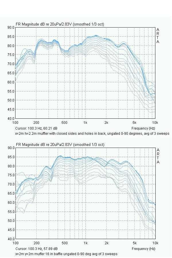

Here it goes. I haven't presented the data on issue 4- yet: what if I indeed drill holes in the back plate where it surrounds the magnet, and close off the muffler's sides (cotton still identical)? The idea was that firstly I'd increase dipole separation, and secondly I force airflow through not just 1 1/2" cotton on the sides, but really through 3 to 4" path length across the muffler "ring" towards the back and out the exhaust (imagine now a truly oversized automobile exhaust model). This would be a transmission line model, though with little actual "pipe" length which is advantageous to prevent 1/4 wave resonances etc.
The result surprised me again. Attached, the FR's comparing the closed muffler, 9" diameter and 3" depth , back open (really drilled a dozen 1" holes), with an implied separation distance of 9+2x3 = ca. 15", to the familiar 16" disc in front of the conventional muffler with open sides sans back holes.
Clearly now, the system behaves more like a conventional box. No more cardioid or dipole radiation patterns, it is omni below ca. 600-800 Hz and directional above. But, we have now a really lumpy FR as well, so there still is some summing with the rear wave going on, except it doesn't help the FR or the directivity patterns at all.

And my preliminary conclusions are...
Well. There are always trade offs.
Clearly the concept of flow resistance seems to work well with little fine tuning, using a simple material as cotton. On the other hand, in the mid range frequency range we get little in the way of low pass filtering. And this means we have a fairly conventional dipole loss.
On the bright side, dipole-beating clean cardioid directivity with low rear output apparently is not too hard to achieve in the midrange. And combined with a CD horn at 1200 to 1800 Hz crossover, this means we can now dream of a constant directivity, constant power response midrange-cum-HF unit. Below ca. 500 Hz this configuration turns into more and more of a dipole, which is a good thing if it is supposed to cross over to one at 300 Hz or so.

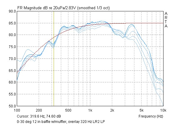

One thing I haven't mentioned yet is the directivity index. Arta calculates me a really nice 4 dB to 4.5 dB figure throughout both midrange in muffler versions AND the XT1086 CD WG. If this is true, then it matches the theoretical 4.8 dB of a dipole, per Linkwitz, almost ideally, which is what the bass is going to be.
Another thing is, the falloff of the 12"baffle muffler specifically, fits LR2/320 Hz not too bad w/o trying, see attached simulation overlaid on data. Ignore the 320 Hz dip and peak beow, this is floor bounce. This configuration could basically stand sans HP filter at all, the 12" baffle giving some LF boost without degrading axial performance too much in the 1000+ Hz region. So, currently I tend towards trying a well built version of the 12" baffle (or a bit less, say 10.5") muffler and cross it to the XT1086 at anything from 1250 to 1800 Hz. The higher frequencies would be feasible dispersion wise, but the separation distance between the drivers becomes too large, 1500 Hz might be the upper limit before exceeding one lambda.

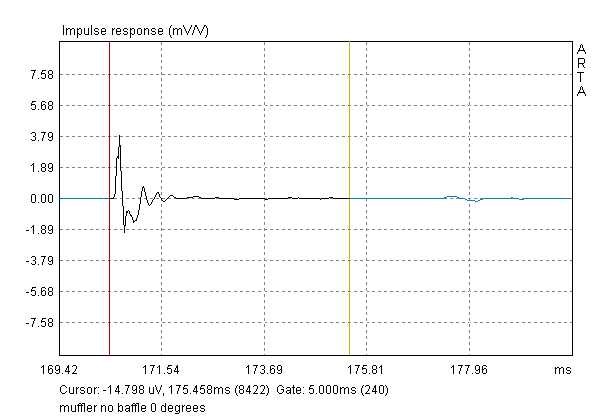

Think about a distributed path for the backwave instead of a single path (as it makes its way to the front). This is what the muffler is doing, as well as acting like a LP filter. The LP is pre-filtering the HF energy reaching the baffle edge, which is good, but the energy is also taking many paths from the muffler as well. Using a second, larger muffler increases the diffusion, as well as adding a second pole to the LP filter.
By the way, since you're using a powerful tool like ARTA, the impulse response over a 3~5 mSec interval would be most revealing. Based on the FR data, I'd guess the muffler with no baffle (or concentric baffles) would have the least stored energy. That's my figure-of-merit for the system. I'd leave bass-lift EQ issues for another driver to handle - I wouldn't sacrifice time-domain performance, which lies outside the scope of equalization.

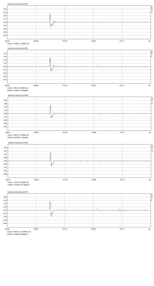

You're on the right track. Supplement the data with impulse response for each type of muffler and it should be most interesting.
Since impulse responses are hard enough to read, I'd break them out for each bearing angle, instead of trying to stack all of them in a single graph. Line-crossing is quite meaningful in the frequency domain, but it would just look like an unreadable hash in the time domain. Separately plotted impulse responses for 0, 7.5, and 15 degrees should be plenty.
The warning for a bad condition is when they look completely different for emission angles that are this close together - and this is something I've seen before, so it can really happen. When the impulse response for the left and right ears are different, this can really screw up stereo perception, no matter what the FR graphs say.
I'd have to add that this was not optimised for time domain minutiae. The support structure is basically a stool, then the angle table sticking out in front, reflections from these must be apparent right in the first 500 usec.
Not the worst I've seen by any means. I agree the furniture is giving short-term reflections in the first 500 uSec. There is a very small artifact, looking a bit like a reflection, in the 12" baffle data - it looks like a small down-peak around 800 uSec, and followed by two ripples in the positive direction. I suspect that's the baffle doing that, and if the muffler wasn't there, it would be bigger.
Well, it's definitely best at 22.5 degrees, with the quickest decays. That would be entirely consistent with the FR's posted in #16 (top graph).
