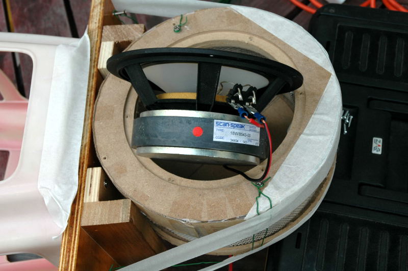

Similar to an approach I have tried. I used 1/4" meash screen (Home Depot) and formed a hemisphere around the back side of the driver (wraped pie shaped pieces around a basket ball and soldered them together). The hemisphere was line or filled with damping material.

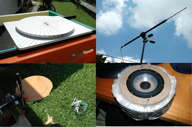

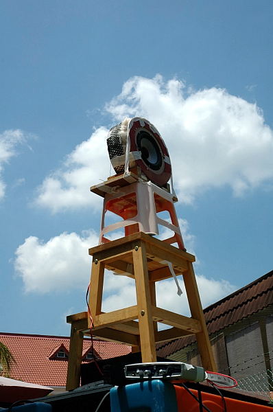

And since someone asked about the turntable, here is a better picture of it, and a medley of related equipment measurement mic, cutting test baffles, and adding extra cotton to the muffler.
I did try two things today: use a 12 in muffler (that is add extra cotton around the existing one), nd use he original 9in muffler with a short in tube in the first section closing it off for the fist 1 1/2 in on he sides sort of an ultrashort U-baffle.
After it was all done I realized I had too many reflections in ht off-axis measurements, I fired the woofer in the wrong direction. Now in the ungated data the polars are unreliable, and gated they are too clean and not comparable to the ungated graphs that I have shown here. Later I'll post at least an on axis comparison, on-axis the reflections did not do too much harm. Right upfront, both the large muffler and the short tube section did not appear to bring anything qualitatively new.

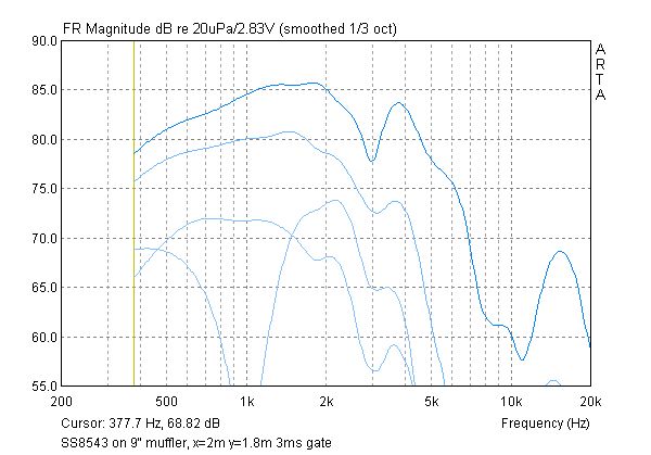

Limited data due to limted data quality

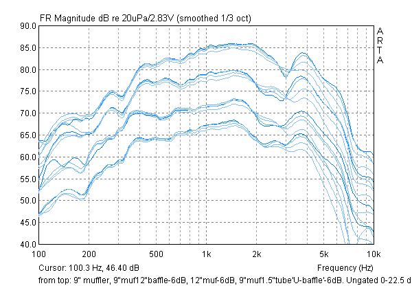

And here I present a comparison between four families of 0-7.5-15-22.5 degrees frequency responses, ungated, each progressively offset by 6 dB.
From top to bottom, always using 6.5" ScanSpeak 8543 driver on cotton-damped cylindrical mufflers:
1- 9" muffler assembly (the original muffler), no extra baffle, damping ca. 1.5" of cotton
2- same as above, but with extra frontal 12" baffle
3- 12" muffler assembly, no extra baffle, damping ca. 3" of cotton
4- 9" muffler assembly with 1.5" tube section forming a shallow "U-frame" tube around the muffler.
I am specifically comparing these 2nd, 3rd and 4th sets because they represent three different ways of achieving roughly 12"-disc-equivalent dipole separation distances, and they are compared to the first, original 9" diameter muffler.
Note: Only limited frontal polar data used because larger angle data have some issues w/o gating here.

Re: Limited data due to limted data quality
I don't think these measurement show what you would like to think they show. Over 22 degrees the directional characteristics of the driver would be more significant that the dipole or cardioid off axis effect. At 22 degrees off axis an ideal dipole response would only be down 0.64dB. A cardioid less.

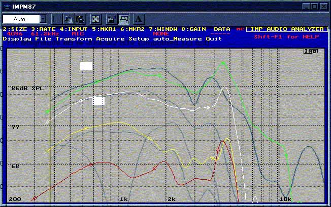

Here is a comparison of an approach similar to the annular muffler that I have used:
Form top to bottom, on axis, 45 degrees, 90 degrees, 135 degrees. Note that the gradient roll off is apparent all the way to the lowest frequency shown and that as the measurement moves to the rear the response level at low frequency decreases monotonically instead of rising again as it would for a dipole, thus indicating cardioid like behavior. I don't have a good explanation for the peak at 4.7k at 135 degrees. On axis this is a breakup mode. There may be some resonances of the back plate of the "muffler" as it is not very substantial.

Some preliminary conclusions
Just to state some things while they're fresh:
- a small and circular baffle with muffler gives the cleanest off axis results. It also is the best solution w.r.t. driver separation issues. Directivity factor is around 4 dB with cardioid pattern above ca. 600 Hz and increasingly dipole like pattern below.
- but this comes at the price of an early bass rolloff, because the small muffler only acts as a low pass down to ca. 500 Hz.
- if this is acceptable then a small 9" muffler that really only consists of driver diameter plus 1.25" of cotton each side, is an easy and functional resistive box.
Attempts to prevent the early bass rolloff can be divided into two approaches:
- increasing front-rear separation distance through frontal baffle or pipe, and
- increasing damping.
Increasing separation:
- wider circular baffles provide lower midbass shelf-like extensions, with 2 drawbacks:
1- the rolloff is rapid after passing the shelf's knee, and rolloff shape is not obviously standard highpass. So EQ needs to be tricky. What is puzzling is that a larger baffle does not seem to move this shelf's corner frequency lower, all it does is to move the shelf itself higher. So it is maybe in reality a resonant peak of increasing amplitude overlaid on one and the same rolloff pattern;
2- starting at 12" baffle (2x driver diameter here) and increasingly worse the larger it is, a large frontal baffle lifts the HF in the more directional region of the driver, here >1kHz, leading to a resonant bump there plus an increasingly perverse polar pattern. The larger the baffle, the earlier the polar inversion. A standard, bookshelf speaker-dimensioned rectangular baffle gives the most irregular raw frequency and polar responses.
- tube shaped extensions work similar to circular baffle but with slightly worse polar pattern
- a driver sized small diameter tube works as well as the muffler as far as LF extension is conserned, but polar response is more uneven, lumpy, and dipole like with widening and narrowing of the pattern over the passband.
- the same tube separation extended by a damped tube extension introduces new pipe resonances and improves nothing.
Increasing damping:
- larger diameter muffler gives marginally better LF extension, but still in a shelf like fashion, not a gentle bass extension: cotton seems to works really as a resistor, and for this not too much material is necessary. HF cutoff does not change much with thickness.
- closed-off muffler only open at the back seems to be an effective LF absorber, but this destroys all benefits of the resistive box: the polar pattern becomes quasi-pistonic, but lumpier than a well designed closed box (of course one could optimize that).
___
The conclusion to me is to avoid large baffles - stay below 12" for the 6.5" driver. Additional benefit is geometric advantage re: Hi X-O driver separation. Maybe Gradient's asymmetric placement is a combination of getting small separation distance and a smeared out resonant shelf. But I don't like the idea of smearing out aberrations, it's better to avoid them or resolve them cleanly (say, by EQ). I also don't want to get into too much slanting-to-manipulate-polar-lobes business, it is tricky to optimize, tricky to measure, and I always suspect it may only work if you stay in specific listening positions.
Another conclusion is that at least for the cotton I used, the resistive part of the equation seems to work very well, and the low pass seems to have a sharp cutoff. Both resistive effect and low pass effect seem to change little with variation of cotton thickness, which is both good and bad - good: high tolerance of the building process - bad: one size fits all effect.
BTW Paul, yes felt would be interesting to try, I thought of this because that works for your large mid array, no? It's more resistive than cotton and can be layered in a reproducible way. Unfortunately all the felt I can find here is the thin stuff, sub-1mm. That's why I went with cotton first, because this I can get easily and it feels high quality and homogeneous.
It may be worth building a baffle between 9 and 12" and stuff the muffler more densely and craft the prototype really well, to see how far one can go in this direction. And then also built it as a realistic structure, with the horn on top and the bass below, to see where the effects of the adjacent objects become larger than anything in the muffler itself. So this is where I want to go next.
