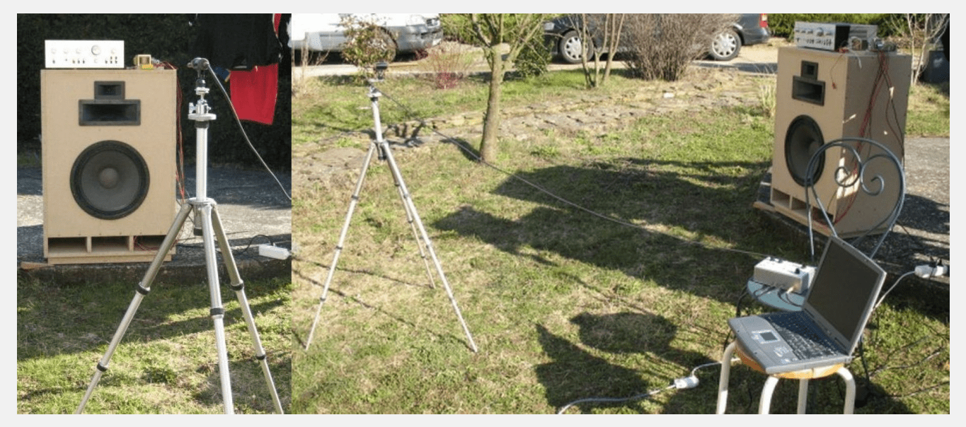

Thank you, I know how to make correct acoustic measurements :
I am also able to recognize by ear when a speaker is in phase or not, and if the transients match themselves between the speakers or not. No need to simulate, nor ot measure it...
I do not have measurements of my designs because for now, my measurement chain has become obsolete (thank you Windows).
T
Reactions: Vix
If you took measurements in the way you showed in the pictures, then unfortunately it is not about the correct way.
Don't get me wrong. I also like to use series crossovers, but what you have shown will not work correctly.
I encourage you to re-do the measurements one day according to generally known guidelines.

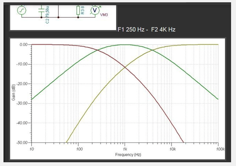

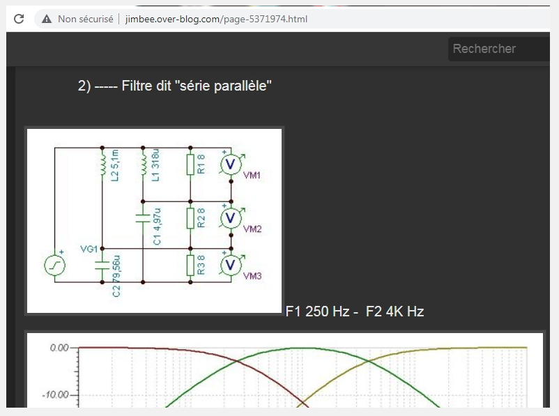

Yes. In essence, for the S- // Xover, the order of the rolloff starts at circa 3dB at the crossing frequency, increases to 6dB, then 9dB, and approaches slowly 12dB at the end. Here are two simulations made by an Audio friend and presented on his webpage (250Hz / 4kHz) :

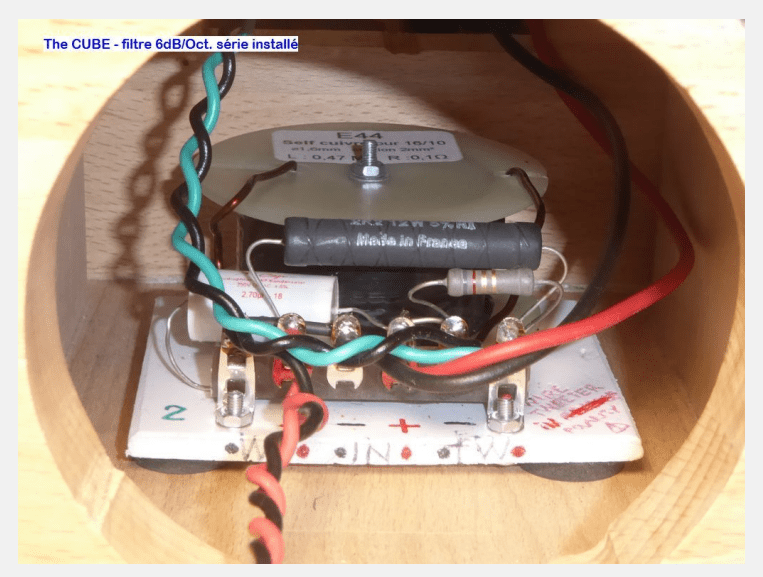

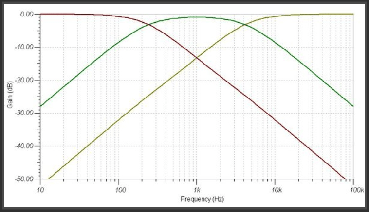

* A 3-ways classic parallel 6dB/Oct. crossover shows the regular slopes at 6dB per octave :
* A 3-ways serial-parallel 1st order crossover shows the increasing slopes :

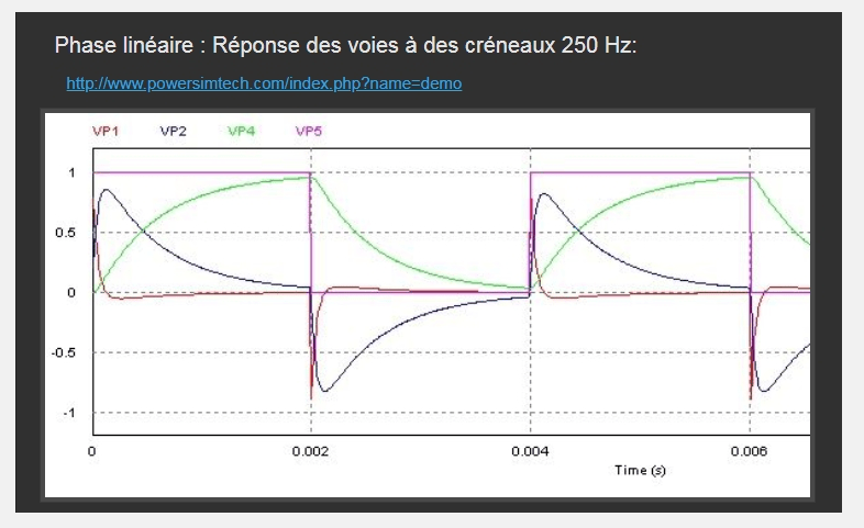

* Note that the speakers on the diagram above are all in same polarity, hence the synchronized transient response between speakers, shown below on square waves, by the serial-parallel configuration :

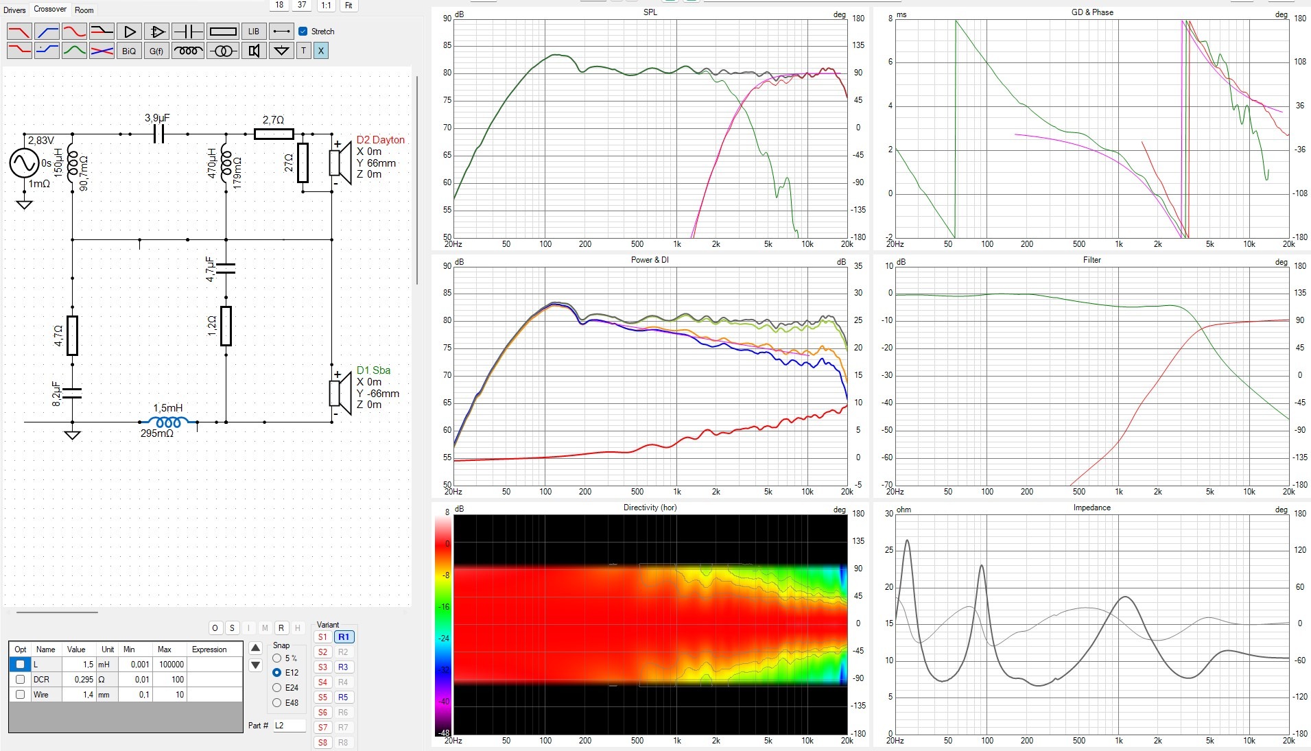

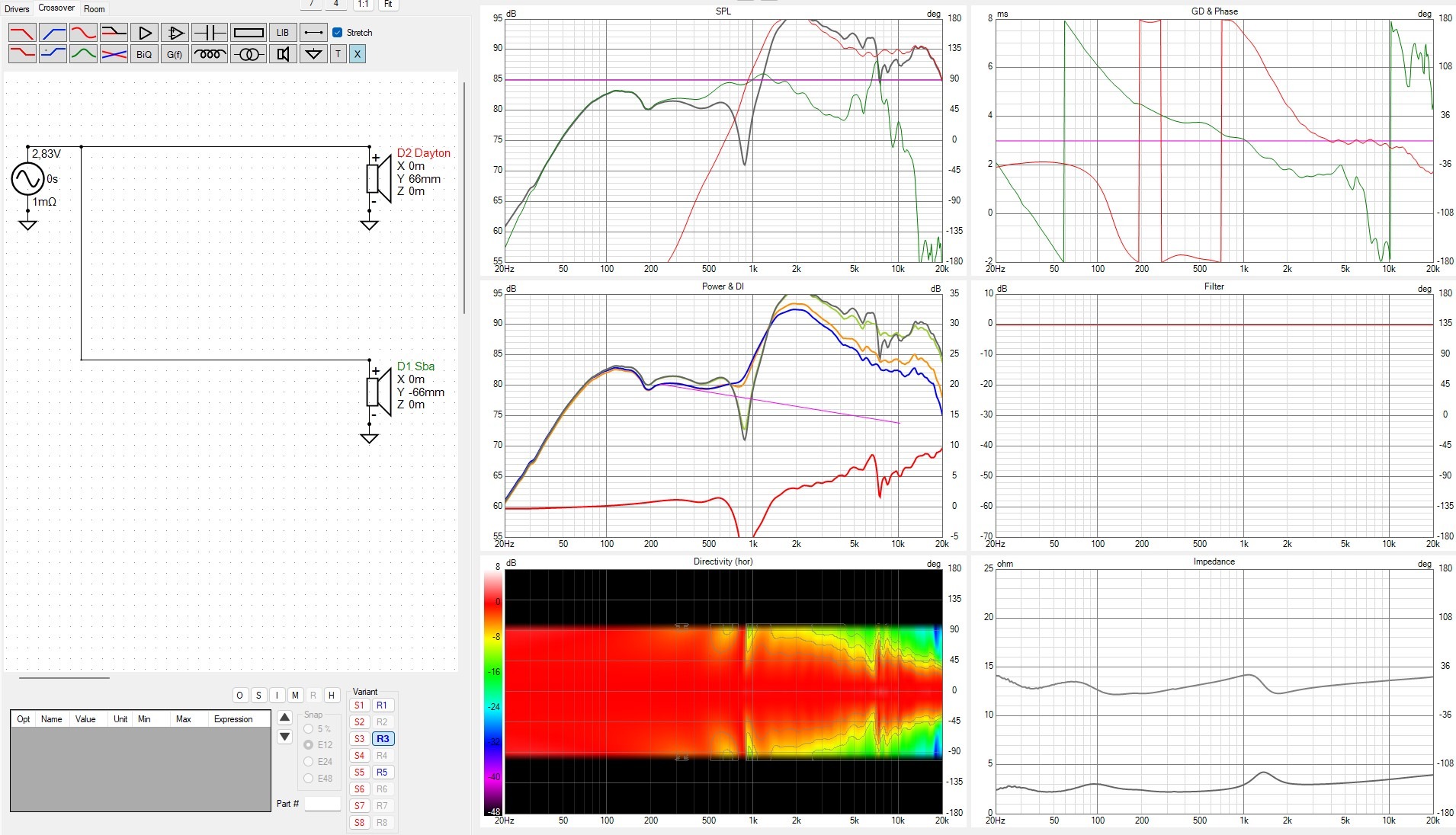

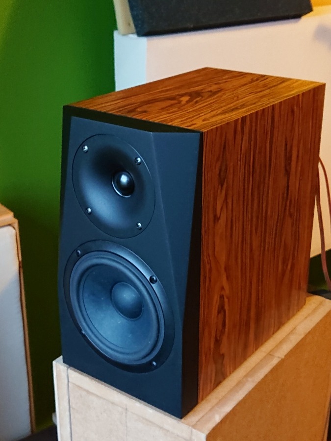

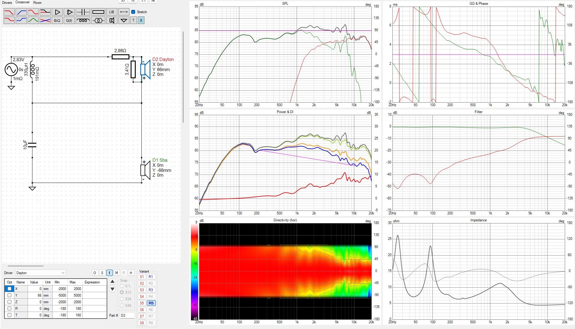

I will show such an example of filtration based on my design of a cheap stand monitor, in which I used a series crossover. In the next few posts I will describe its behavior. Measurements for the crossover were taken using Arta software, on a 0 to 90 degree rotary table.
The first screenshot is the measurements of the speakers connected in parallel. As you can see, this is a connection in the same polarity, and even without any crossover we see quite a bit of phase distortion.

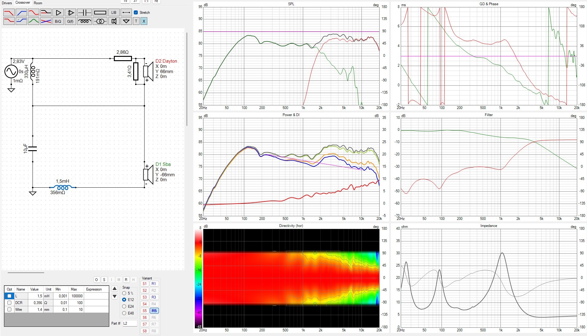

Now let's see how the simplest 1st order serial crossover works. I added an Lpad for the tweeter to the schematic to lower its SPL slightly relative to the midwoofer.
Looking at the transmittance of the filter, you can see that such a crossover is unable to correct the Baffle step phenomenon that occurs with a typical loudspeaker enclosure. If we used an infinite baffle for these speakers, such a simple filter could work, but in the real world we still have a problem with the midwoofer, whose frequency response is not ideal and requires further intervention.
The two speakers are still connected in the same polarity, which manifests itself in a huge frequency response hole caused by a phase mismatch.
Reversing the polarity of the tweeter significantly improves the frequency response.

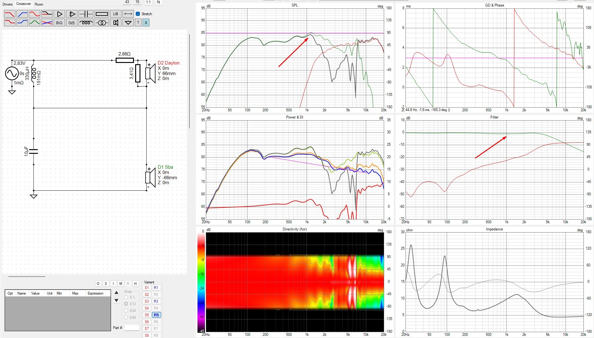

We need to add another coil to our schematic to correct the Baffle step effect. This is still far from the theoretical ideal, especially considering the frequency response of the midwoofer. We need to attenuate the break up of the cone, which can be achieved by using additional elements at our coil responsible for Baffle step correction. This is a typical LCR scheme, acting as a notch filter. I have added a series resistor to the schematic, which will make it easier to achieve optimal filtering characteristics and impedance without large drops in the higher bandwidth.
In the end, we have a series crossover with a small number of elements, but allowing for effective speaker filtering. This crossover scheme is quite versatile and even when using speakers with not very even frequency response, one can get quite good results.
Thanks to the use of a waveguide tweeter and an enclosure with chamfered sides, we get fairly even bandwidths off the listening axis. The waveguide also allows for better time alignment of the speakers.

A serial higher-order crossover can also work very well. The schematic creates a 3rd-order crossover, but acoustically you get an LR4 crossover. In this case, the polarity of the speakers will be the same.

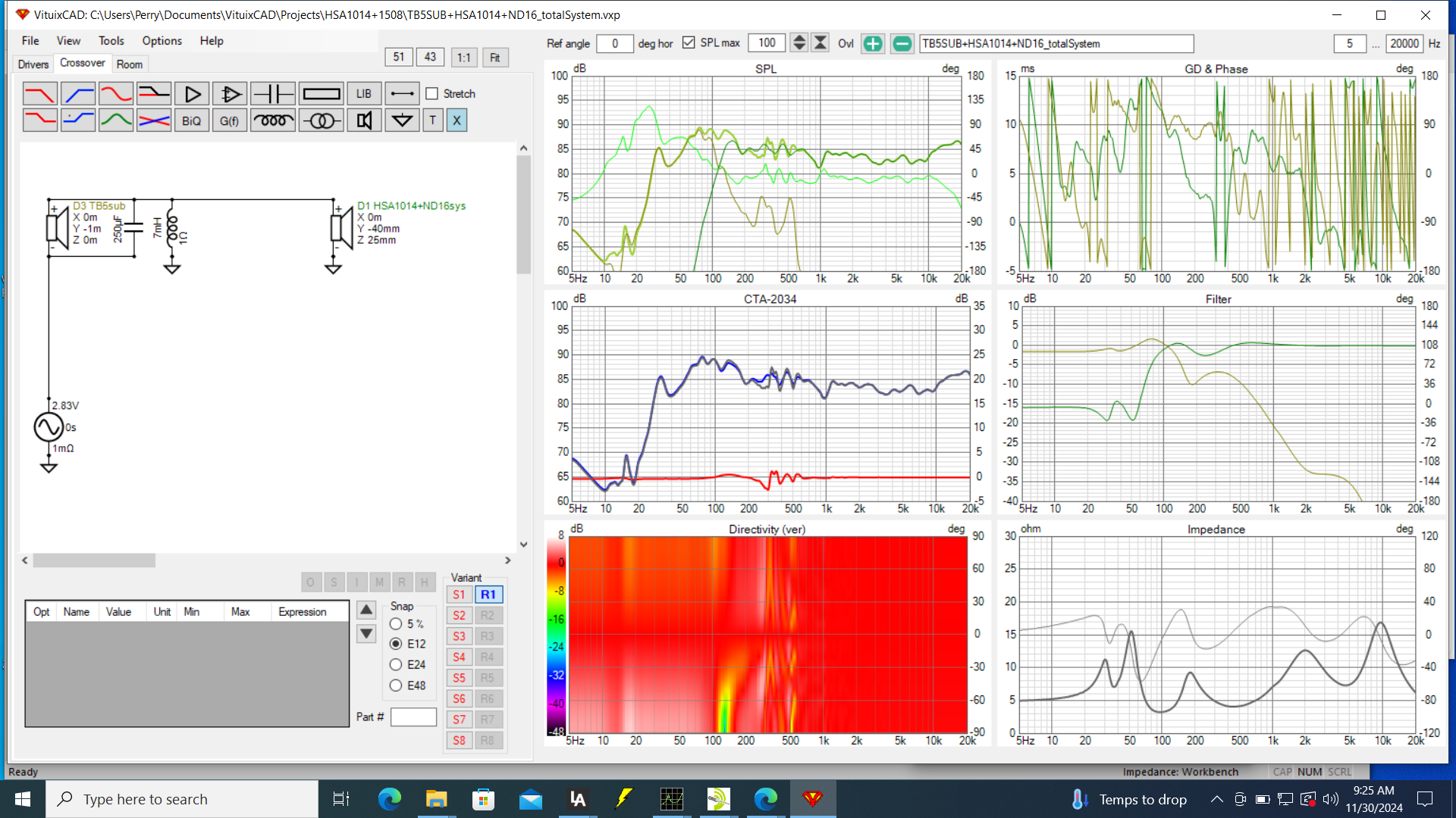

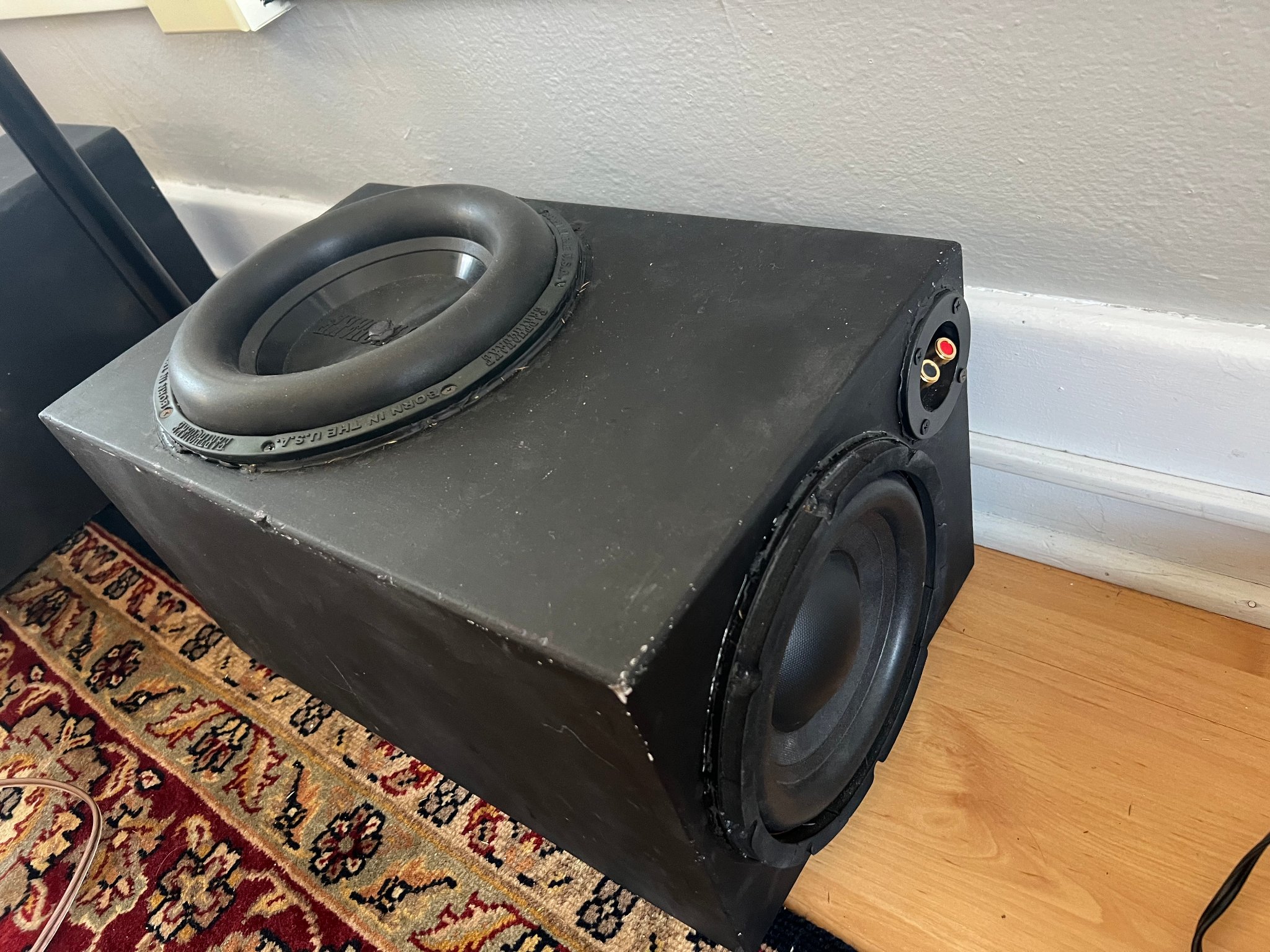

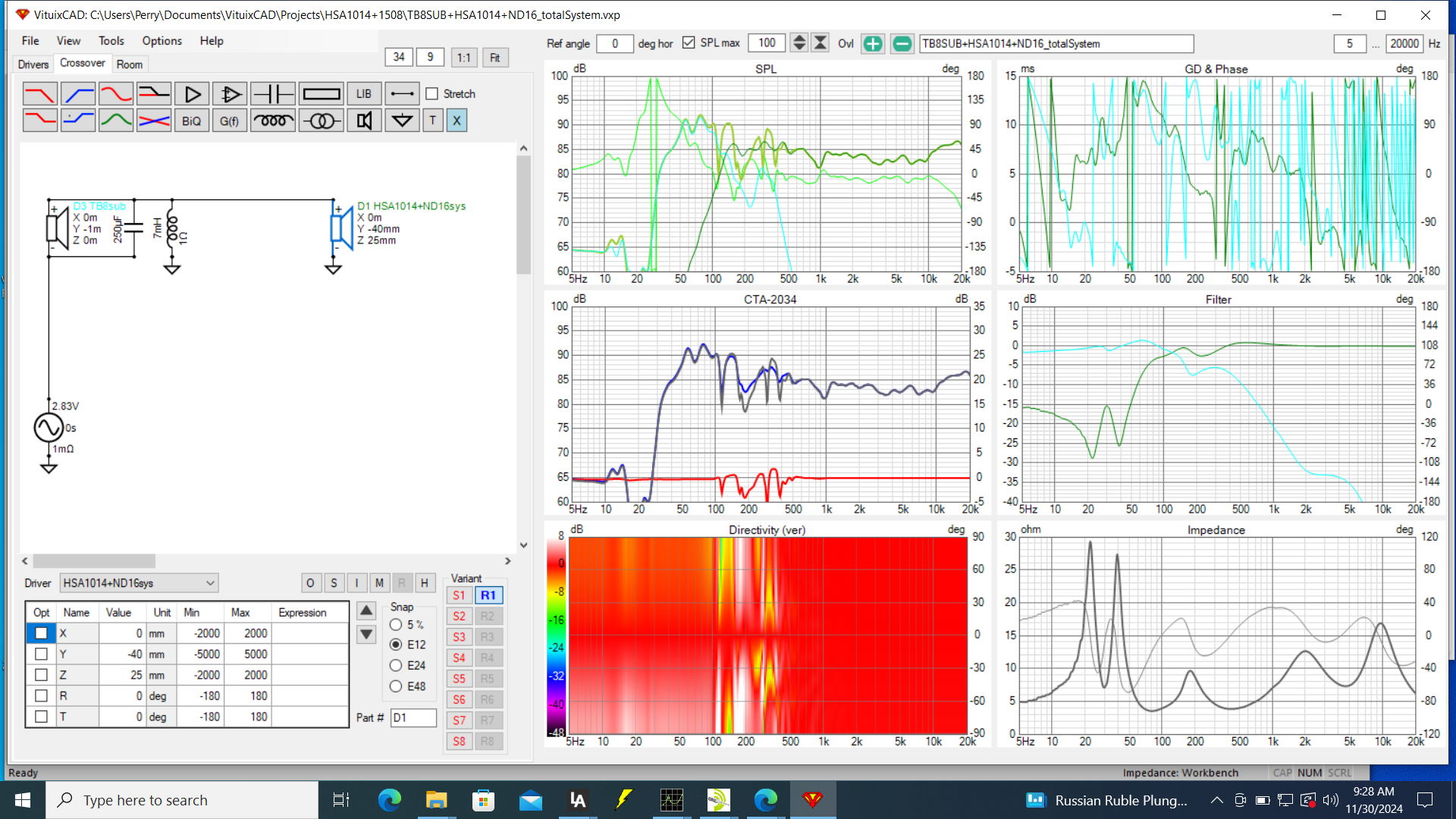

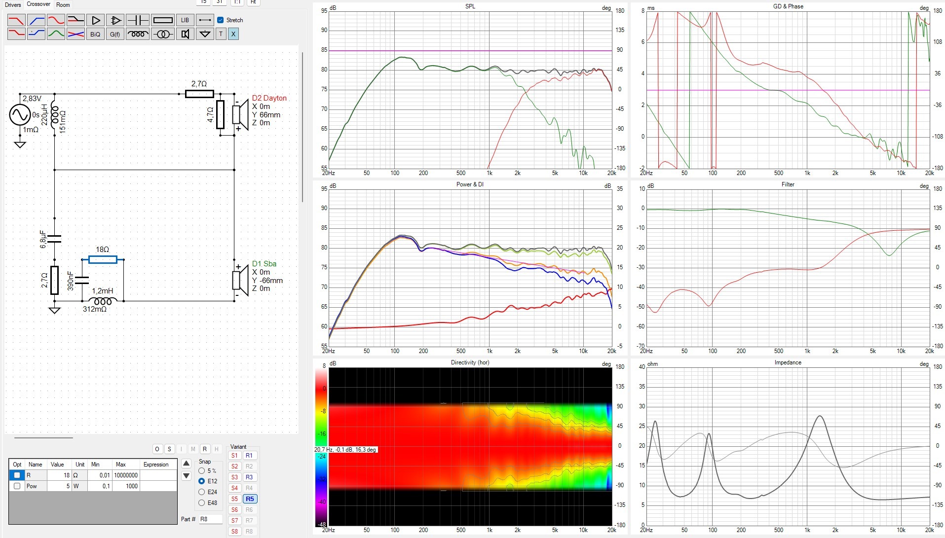

Here, a detailed simulation of a couple of systems I built using series subwoofer crossovers.

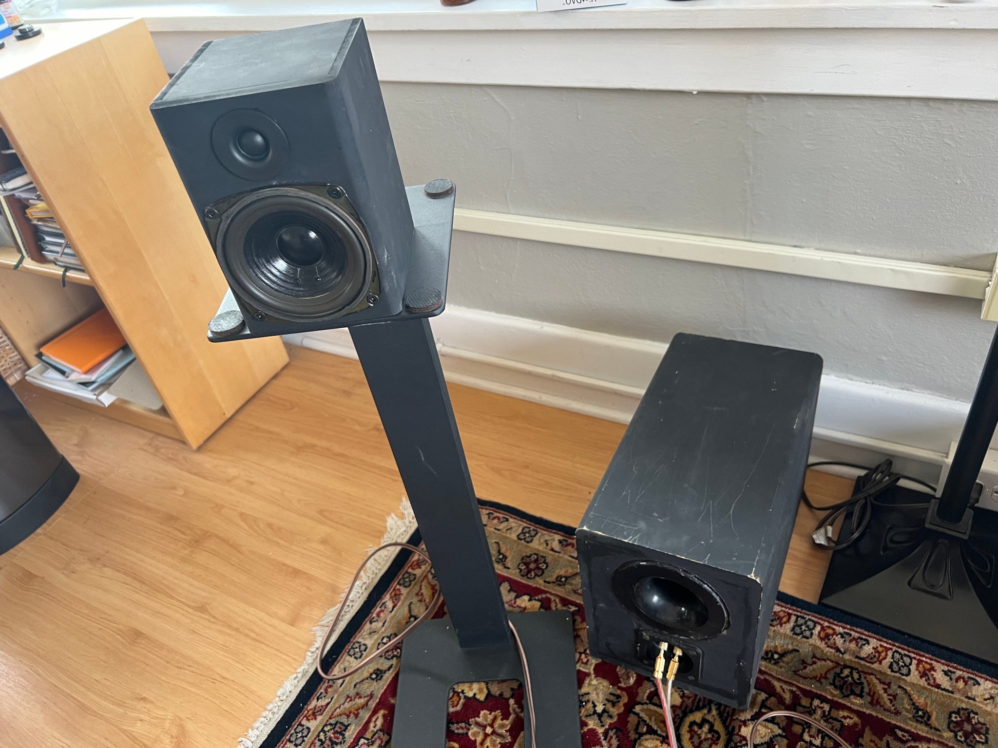

Example #1, Subwoofer #1:
Subwoofer: TangBand W5-1138SMF in a 14 liter reflex enclosure tuned to 36Hz. 2" port.
Satellite: JVC HSA1014 (4") and Dayton ND16FA (0.625") in a 1 liter sealed box. Tiny little speakers.
The crossover is a super-simple SERIES circuit with 2 elements: 7mH inductor in parallel with the satellites + 250uF cap in parallel with the sub, and those two circuits wired in series - as shown here:
The filter curves (right side middle row) show that the sub drive signal is roughly a 6dB slope with impedance interactions working in your favor. (They work against you in parallel circuits, as discussed earlier in this thread.) The two impedance peaks from the sub, at 30Hz and 52Hz, suppress output in the satellites at those frequencies - which is ideal. The single impedance peak from the satellite, at 180Hz, suppresses output from the sub at that frequency.
The satellite drive signal is roughly a 2nd order shelf filter with -16dB asymptote and a pretty steep drop below 100Hz which is exactly what we want.
I get the best results wiring with normal polarity on both sub and satellite.
I also modeled them as being separated by 1 meter and the directivity graph lower left gives you some idea about interference patterns.

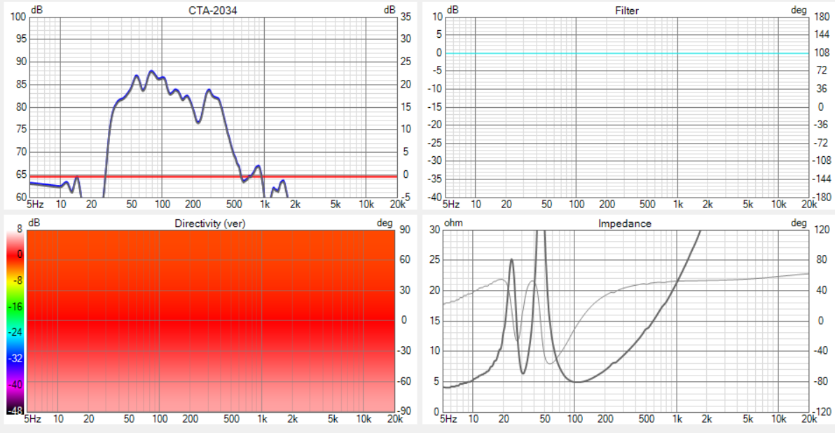

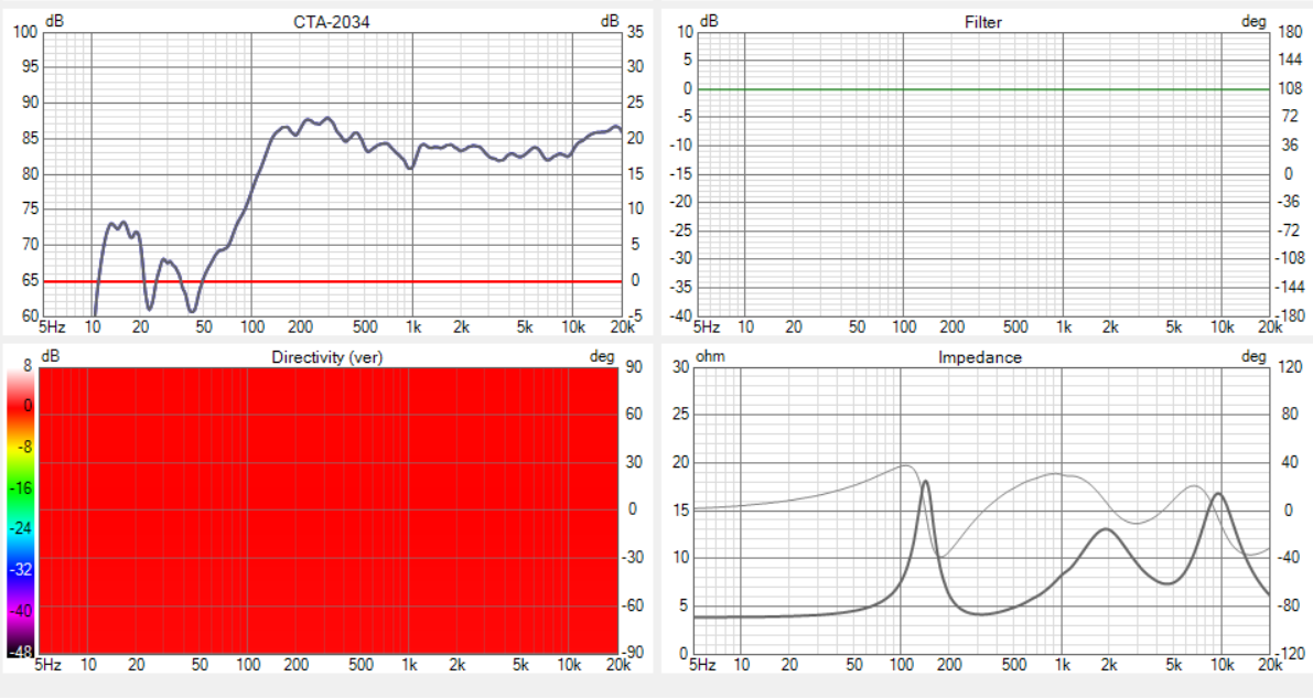

Example #1, Subwoofer #2:
I switch out the 5" sub for a TangBand 8" W8-740P subwoofer with 10" passive radiator in a 20 liter box.
I get this result:
As you can see the sub has impedance peaks at 22Hz and 40Hz, which are reflected as dips in the satellite drive signal at those points. Signal rapidly falls below 70Hz. This is desirable.
These measurements are from the actual speakers in my room, nearfield, as best I can manage. No attempt has been made to gate out room reflections.

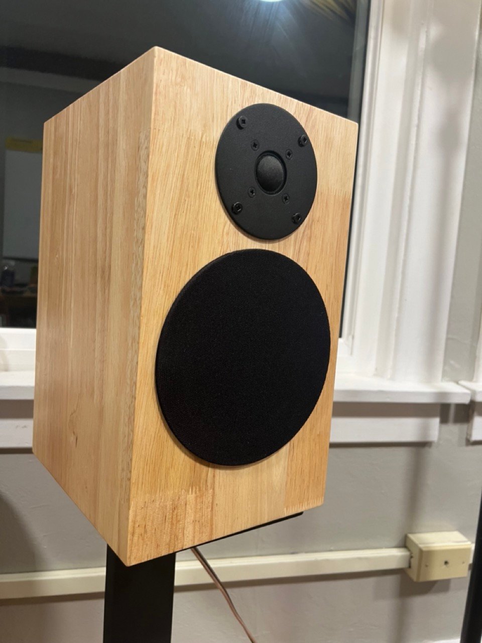

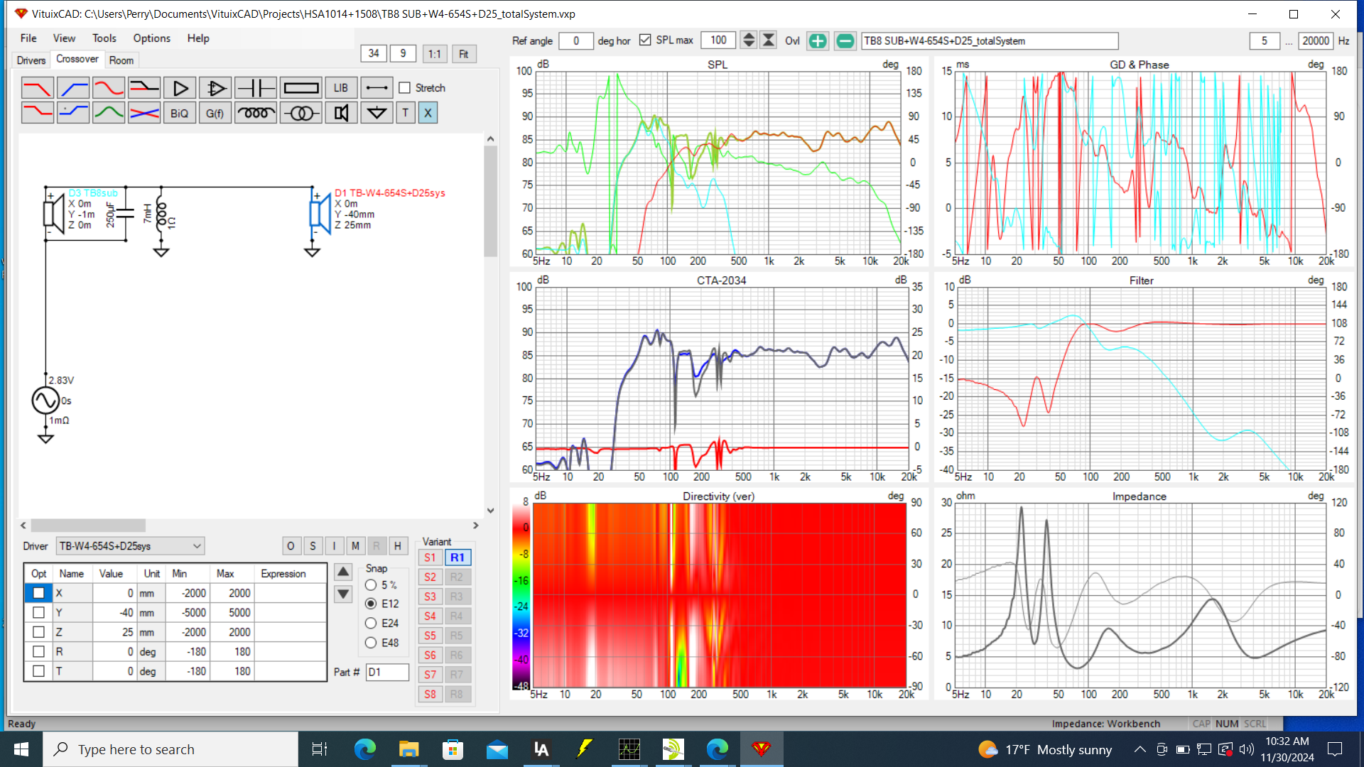

Example #2, Subwoofer #1:
Then I switched in these satellites, which are 7 liter bass reflex design with a TangBand W4-654S woofer and Audax TW025A0 dome tweeter:
Here is the VituixCad simulation using the actual SPL and impedance measurements for TB 5 sub and satellite:

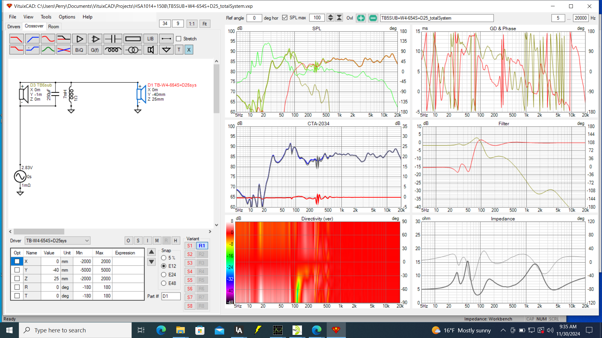

Example #2, Subwoofer #2:
And below is the same ported satellite with the 8" sub.
Both of these subs are ported so they have an upper impedance peak at either 40Hz (8" sub) or 52Hz (5" sub) and those assist in making the satellite rolloff steeper. A sealed sub would only have one impedance peak at Fb.
This simple series circuit 7mH / 250uF would be an effective 100Hz crossover for many subwoofer / satellite combinations, and 90% of the time will work much better than a standard parallel circuit.

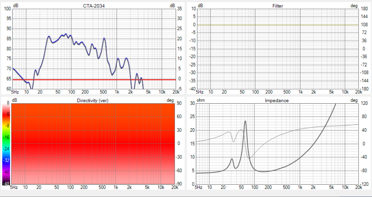

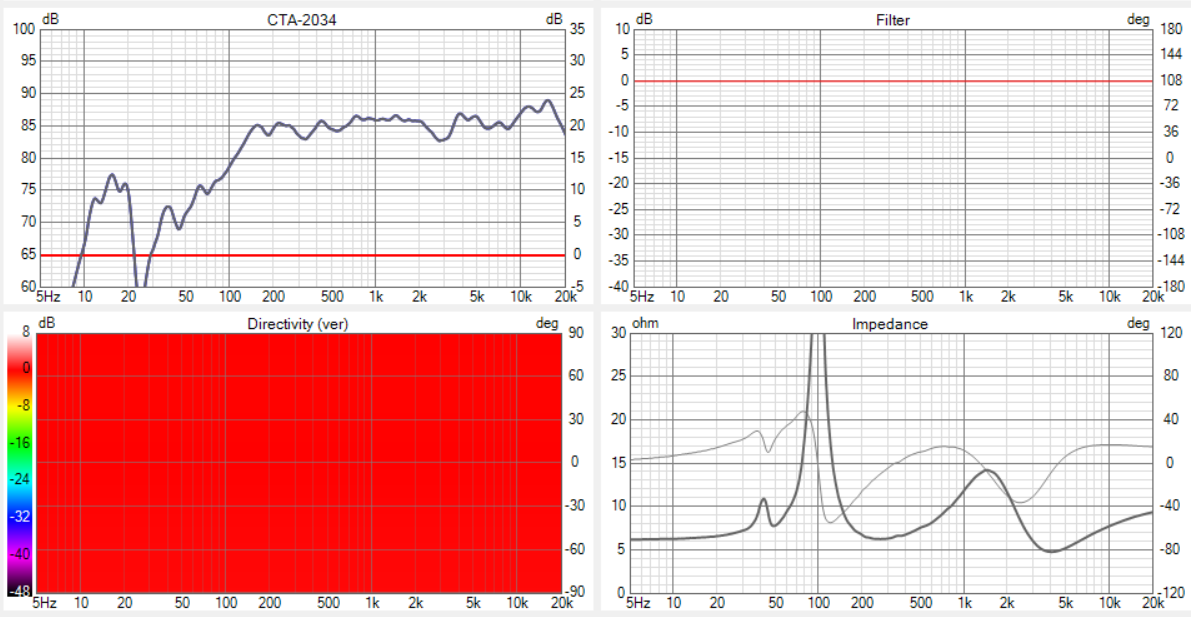

For reference, these are the impedance curves and frequency response curves used in the VituixCad simulation. All these were measured in my room so curves include floor and wall reflections; subwoofer measurements are ground plane, not nearfield.
TB 5" ported Subwoofer:
TB 8" Ported Subwoofer:
JVC micro satellites 1 liter sealed box:
Tang Band W4-654S + Audax 1" 7 liter ported box:
