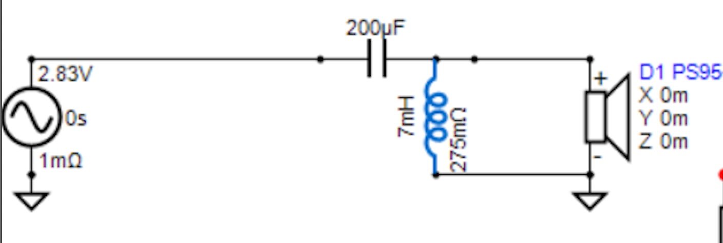

Hi Perry, I will play with it.You can likely still insert the passive bass boost circuit into your series crossover. You just need to model it and work out the kinks. It's going to be very sensitive to DCR of the inductors which needs to be low. I think it will help (4-7dB is good) I just estimate it's not quite enough boost.
