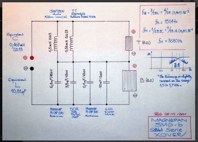

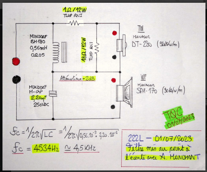

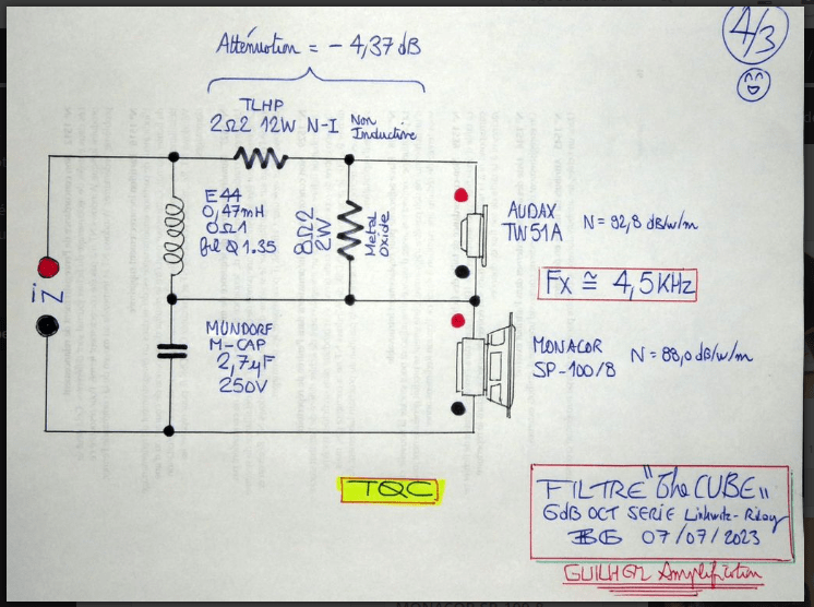

After many experimentations and listening comparisons with 6dB/Oct. // and 12dB/Oct. // configurations, I'll even add some other advantages to the serial 6dB/Oct. crossover :
1 - the speakers are connected in same polarity. This means that on a transient wave, the cones will move in the same direction, without any other delay than the construction flaws of each speaker can provide, unlike on most higher order crossovers.
2 - the speakers are in Serie, and connected directly to the amplifier's terminals, without passing through a LC crossover component (wired in // to the speakers). This means that no possible phase gap or rotation exists than the construction flaws of each speaker can provide.
3 - the number of parts are minimalistic. This simplicity means that the insertion losses are reduced, and as they are not in serie with the speakers, they possibly have less impact on efficiency.
4 - each speaker "sees" the same LC assembly, conversely to the // 6dB/Oct. configuration, where each speaker "sees" a L or a C. A parallel 12dB/Oct. offers also a LC assembly, so it may be an explanation for the attenuation slopes of the Serie 6dB/Oct. closer to a 2nd order slope.

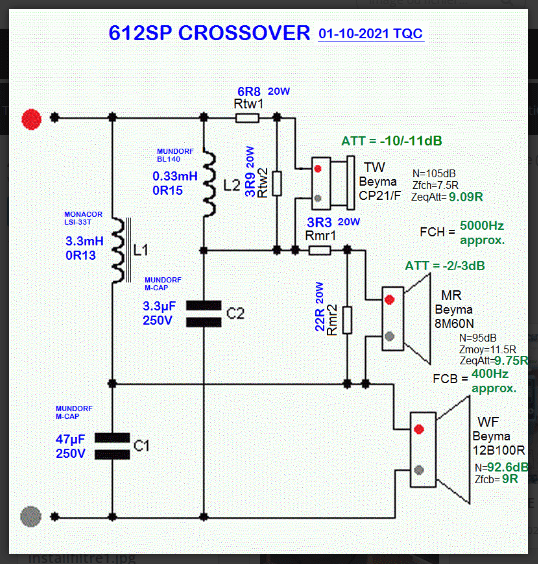

All my DIY speakers have now 6dB/Oct. Serie crossover, being 2-ways or 3-ways. I even went for this solution when I rebuilt the crossovers of my Magnepan SMGb. The results are amazing and at any rate, I wouldn't go back !

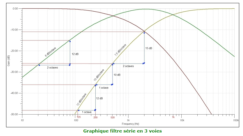

I think that the slope is between 6dB/Oct. and 12dB/Oct, if I rely on several (but few) studies I read on the subject (including those mentioned by @Stanislav in his post). I can mention others, but these are in French :
http://jimbee.over-blog.com/page-5371974.html
https://www.audiotechno.fr/php/filtre-serie.php
T
The issue is that these 6dB and quasi 6dB electric slopes once loaded with a real driver rather behave like acoustic second or third order slopes.

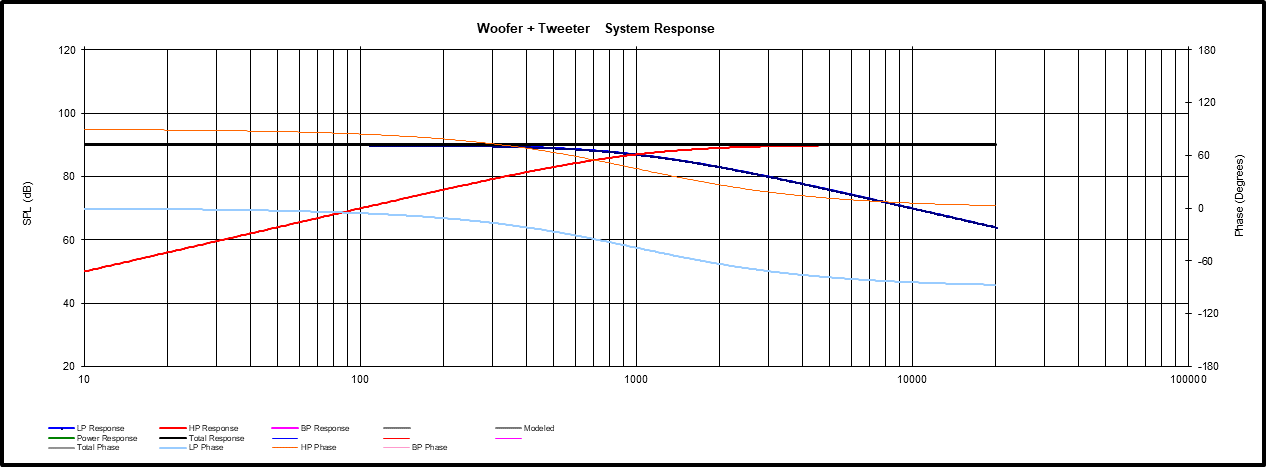

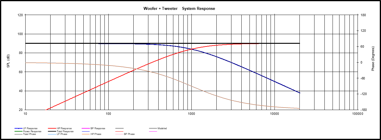

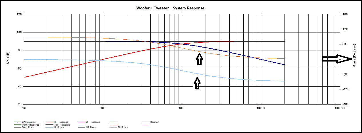

You can't simulate these in any of the free crossover design packages yourself?Someone please sim 1st-series vs 1st-parallel vs 2nd-parallel, including phase. Thanks.

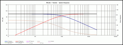

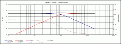

Attached. This is assuming a purely resistive 8ohm electrical load, flat FR, phase & coincident acoustic centres (so we're just looking at the electrical transfer functions: the second you apply real-world drivers to this, with their frequency-varying impedance loads, variable frequency/amplitude responses & offsets between the drivers in the 3-planes it all goes to pieces).
1st order parallel, 1st order series, 2nd order Butterworth & LR2 shown with a 1KHz nominal frequency. I included two different 2nd order filters since you didn't specify any particular type -in this case Butterworth for type-consistency & LR2 because it electrically speaking sums flat. The 2nd order filters both have the HF polarity flipped as they are 180 degrees out of phase in the same polarity. 1st order sums with 90 degrees phase difference, whether it's a series or parallel filter. No mysteries here. With a purely resistive electrical load & ignoring everything else, 1st order series & parallel are identical in terms of the summed / system impedance, frequency response & phase shift. It's when you get to real-world applications that you can start to see functional differences -but for that, we'd need to have the measured FR, phase & impedance data for a given speaker.

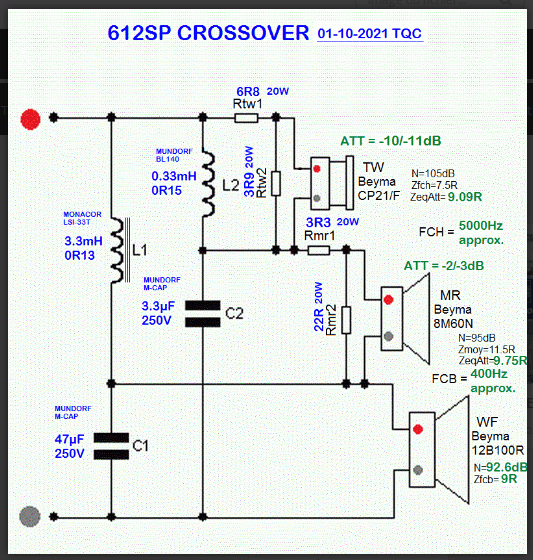

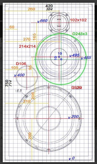

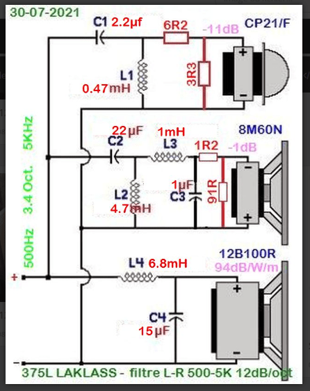

C to C ideally should by 1/4 wavelength of the XO frequency, in many cases not possible.

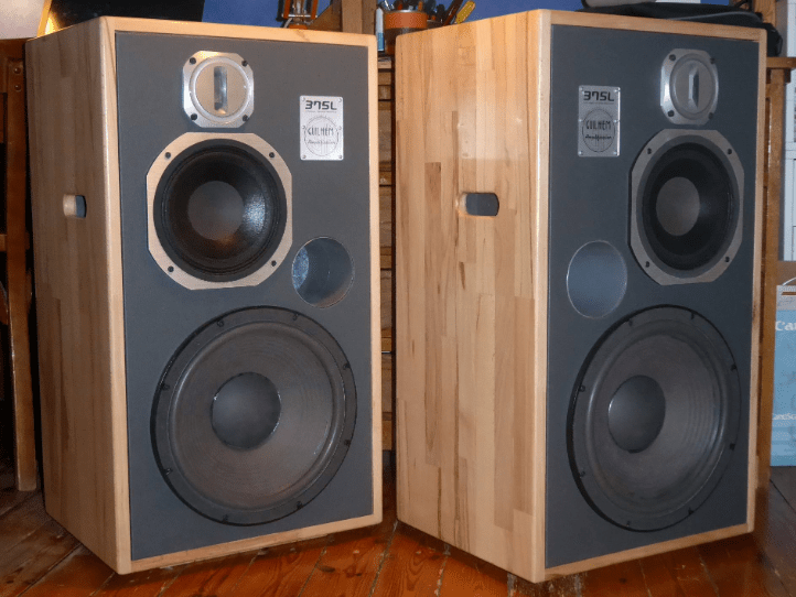

Yes, that's it. I did my best to achieve that on my 375L Monitors (DIY) - and yes, this is not always possible... Here, FC are 5000Hz and 400Hz.
Below, at left, the 12dB/Oct. // version ; at right, the 6dB/Oct. Serie version - both listening-tested on the speakers above, in instant A/B test, with the same sources / amps / musical program and samples :
No picture : the 6dB/Oct. Serie configuration completely buries the 12dB/Oct. // configuration above, aurally speaking.

Yes. If we did not tested it - as objectively and seriously as possible - with Audio friends, we would never have believed it ! Like what, as often, la carte n'est pas le terrain ( the map is not the terrain)...

THANKS Scott. But I already knew the simplistic story of this four-way comp and it does not show/explain features such as slope and phase of 1st-order series vs the rest. Hence my request (even begging) for the difference to be sim'ed, if only for a "typical" or ideal set of drivers (impedance curves, phase) and test conditions (baffle layout, aligned acoustic centers, etc).You can't simulate these in any of the free crossover design packages yourself?
May I also propose a "null hypothesis" experiment: take two identical drivers, near-flat impedance area, crossover one to the other. Should be zero audible difference series vs parallel 1st-order, correct?
If the slope is the same then phase will be the same.such as slope and phase of 1st-order series vs the rest.
I'd also point out that I did show the individual filter phases in the four simple simulations above. See attached; phase indicated by the arrows. The filter & phase slopes are identical between 1st order series & parallel since this is an identical static / resistive load.
