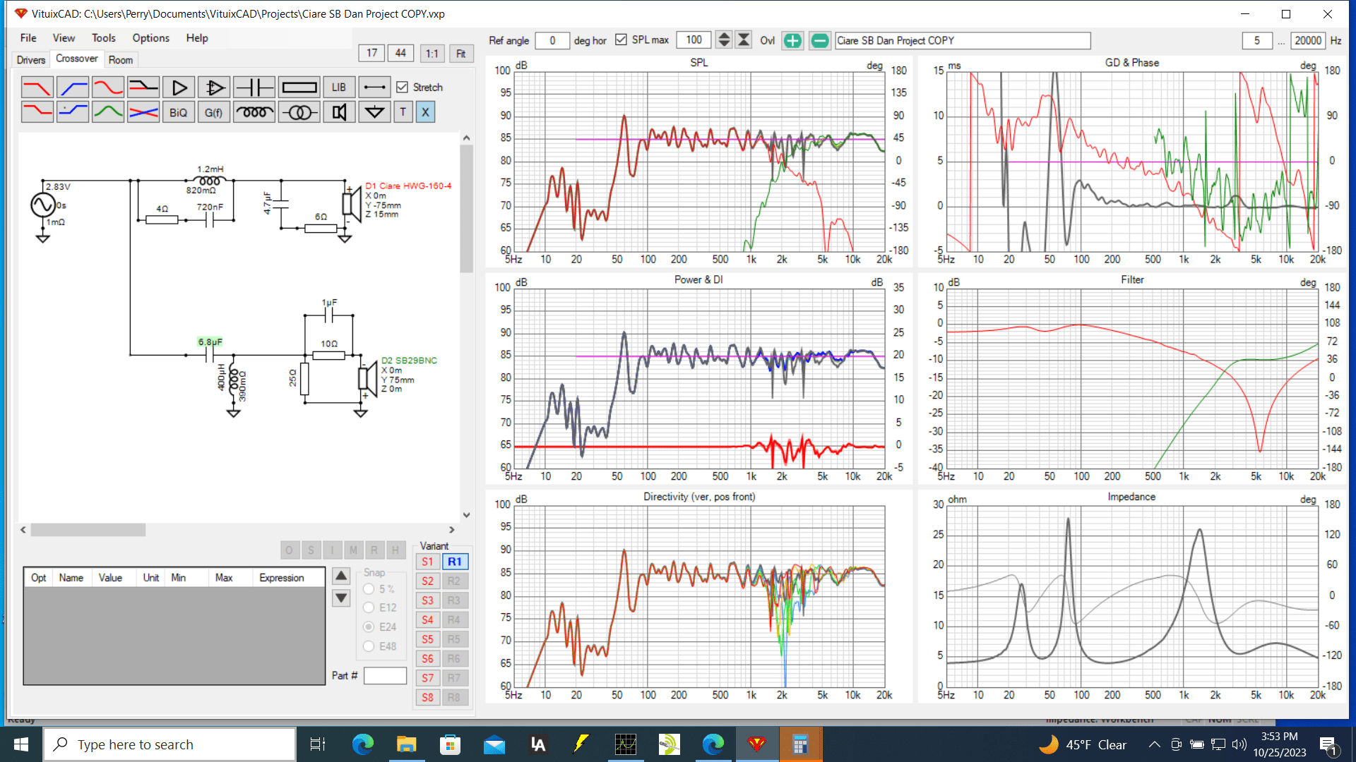

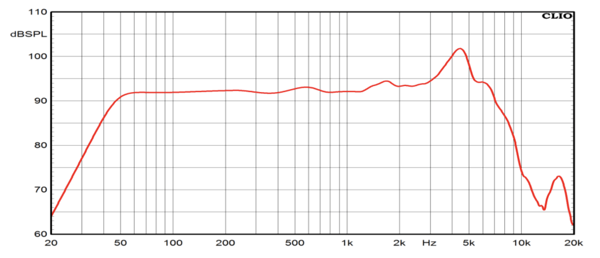

I built a system using the Ciare HWG165-4 which is an excellent driver but has a peak at 5K that must be dealt with.
Here are the models for a parallel crossover that I modeled and actually built. It's worth pointing out that this circuit is not a traditional low pass, it's a notch filter specifically targeted at the 5k peak but which also compensates for Baffle Step:
Here are the models for a series crossover that I ran just to see how good I could get it (I did not build it FYI):
You can see in the series crossover the LC trap circuit on the Ciare woofer which removes the 5K peak. .56mH || 1.8uF+5.6 ohms. @Davey is right, the series has more interdependencies so when you actually build it and inevitably have to tweak stuff to fine tune the sound, the series config may be more challenging.
Yes, that's a very typical real-world situation. Folks who have built systems with Seas Excel drivers (for example) would find that familiar looking. 🙂
I note that you also had to reverse the (conventional) relative polarity on the drivers in both instances.
So right away you found yourself in a trade-off situation to achieve your goal. (This is the sort of real-world challenge thing I'm talking about.)

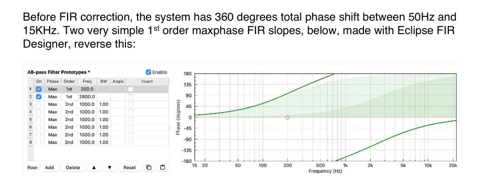

In the Bitches Brew and Live Edge Dipoles, the phase shift of the crossover from woofer to mid is pretty similar to a 12dB/octave slope requiring polarity reversal on the midrange. I correct that in the FIR DSP file by adding an all pass filter that shifts phase 180 degrees and brings the system back into linear phase. Part of my strategy with crossover slopes was to make this easy to do. If you read the Live Edge Dipole article in AudioXpress carefully, you see the layers of filtering and I don't fully explain in the article that I'm trying to minimize the amount of gymnastics that the FIR filter has to do.
In the Bitches Brew design, the MiniDSP Flex8 only has 2 FIR channels and I use both of those channels to rotate the phase 360 degrees between bottom and top and that renders the phase response flat and the impulse response close to perfect. This goes back to a priority that I learned by studying John Dunlavy and his viewpoint that a square wave is a huge litmus test of a speaker. 99.9% of designers don't have the chops for that but he did.
This is the FIR filter I made using Eclipse software. More details at https://evo2.org/wp-content/uploads/2023/09/Live_Edge_Dipoles_2023_Beryllium_Update.pdf
