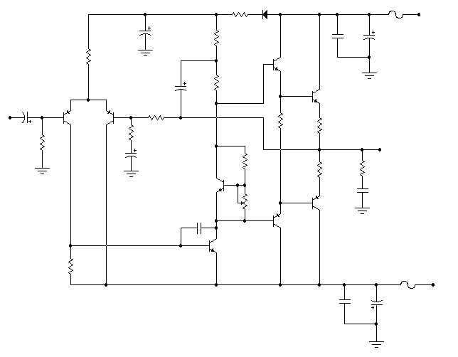

edl said:Dear Mastertech, if you dont mind... a few mods.
Edl...Would be interested what the current mirrer does to your ears.
Mastertech...What would you like us to conclude over your circuit?
For the input differential stage, Nelson Pass, John Curl, Ernest Borbley, and several other diyAudio experts recommended resistor loads instead of a current mirror based upon their ears and product experience. You can search to confirm. Resistor loads seem even more common for JFET differential input stages.
I've only built amps with JFET inputs and low voltage power rails. For JFET differential input stages, my ears think that cascodes add noise and limit the dynamics. My experience says that matching JFETs for cascodes is very difficult and can affect distortion in stages with limited local feedback. The real world is more complicated than Spice.
Dear Mastertech,
I've played (and still playing...) much with this amplifier globaltopology.
Due the experimentations I've found that current mirror in the LTP worsen the sonic quality of the whole amp. It gives stiff sound and become disturbing in the long run. A simple resistor gives softer and listenable sounding.
Yes, I know, it reduces THD, but I develop amplifiers for my ears, not for my measeurment gears.
If you design going to be a PA desing, then the current mirror in the LTP wouldn't be troublesome.
Best regards
Postcript: Using the same globaltopology, my favourite realization: (let's see attachment)
The parts values and types aren't included, it develops on the concrete case. With a lot of experiment you can reach a super sounding amplifer design, with the attached schematic. Of course, it can (and should) be modified to tuning for maximal sound quality.

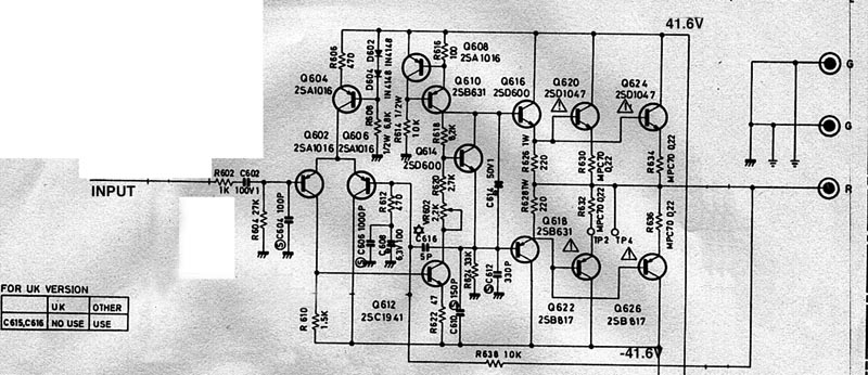

very close i think...

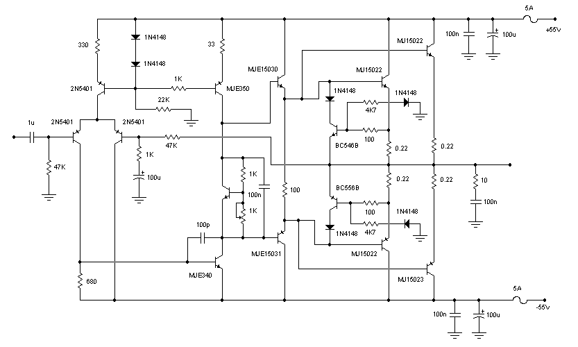

More closer (a simple 200W/4ohm PA amplifier design):
I thought i should my two cents. First off your Vbe multiplier needs to be adjustable so replace one of the fixed resistors wth a pot. second you need emitter resistors on the active current mirror. Third the last few schematics have shown resistive loading but have a major problem, they only loaded one of the collectors and not both. So the Vce will be different, damn body effect. BTW your circuit is very similar to my headphone amp 🙂

Looking good!
Agree on resistor collector load for the LTP.
Agree on resistor drive for the LTP.
More attention to crossover at the output stage; see Self's Type II EF.
Now begins the difficult task of dimensioning and component choice........

get rid of the current mirror on the LTP load.
Add Re degeneration to the LTP and Vas.
Try to reduce or eliminate the Miller compensation around the VAS and augment or replace with VAS to LTP base or output to Vas base feedback over two stages plus some comp on LTP load.
Adjustable Vbe multiplier and thermal coupling to output heatsink.
Ensure your LTP load actually balances the current in both legs of the LTP. A trimmer // to the LTP load is better than adjustable Re in the LTP emitters. Alternatively an adjustable current source for the VAS to balance the LTP currents.

I often see that diode in rail (positive rail and negative rail).
What is it's purpose? And sometimes these diodes are connected series with R (100ohm). What does these do?
David,
The diode blocks rail voltage drops under heavy load, preventing bad effects on the TLP. The 100R resistor in series helps to reduce the switching noise of the diode and serves to decouple the supply, with a cap, from the main supply rail.
Hugh
Hugh
