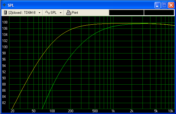

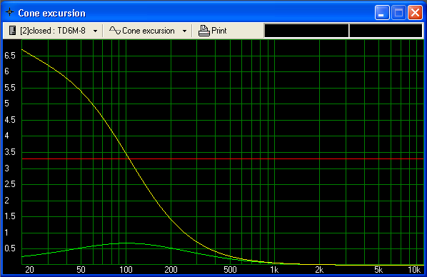

The fact is that they simply offer less protection, but that might still be adequate for the right drivers (so the expression "required protection" is quite vague). Also keep in mind that the driver's displacement doesn't continue to rise below its resonant frequency - at least not for a closed box (which is the case for most tweeters and mids).
Exactly. Here's a midrange driver (TD6M) in a closed box tuned to Q=.5 at 105 with 30 watts applied. Yellow is the SPL and cone excursion with no filter and green is with a 6dB electrical highpass at 500. Of course the green acoustic SPL curve is nothing like first order so all the supposed 'phase advantages' are somewhat moot but at least the simple filter is providing adequate driver protection if you don't get carried away with the volume control. 🙂
The issue is more appropriately what occurs with an acoustic first order. That said, no matter how close to a first order acoustic slope is achieved, at some point due to the driver's response in a closed box, it will ultimately revert to second. As long as that point is far enough down in level (possibly the noise floor), it becomes a moot point.

1) Through a first order high pass filter, displacement requirements of a MF or HF driver do not decreas as signal frequrncy is lowered. For this a higher order filter is required.
2) You may choose drivers using any criteria you like. That does not change the "abuse" that must be sustained by MF and HF drivers when fed signals with content below their operational frequency range.
