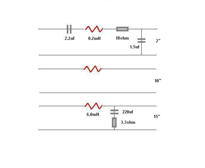

Im listening to this in dipole omni right now
drivers are just placed on the floor
drivers are nothing special, just used what I had
I have no idea what it is, but it works😛
despite cheap cheap drivers, classical especially is amasingly good
Im building other speakers, but I could live with this forever
Im sure theres a whole world of undiscouvered sound hidden in omni designs, and the crossover needed for such
what m trying to say is that every each speaker design has its own special demands for crossover design
and even if you have a good idea about what you want to achieve, you wont really know for sure until its built
