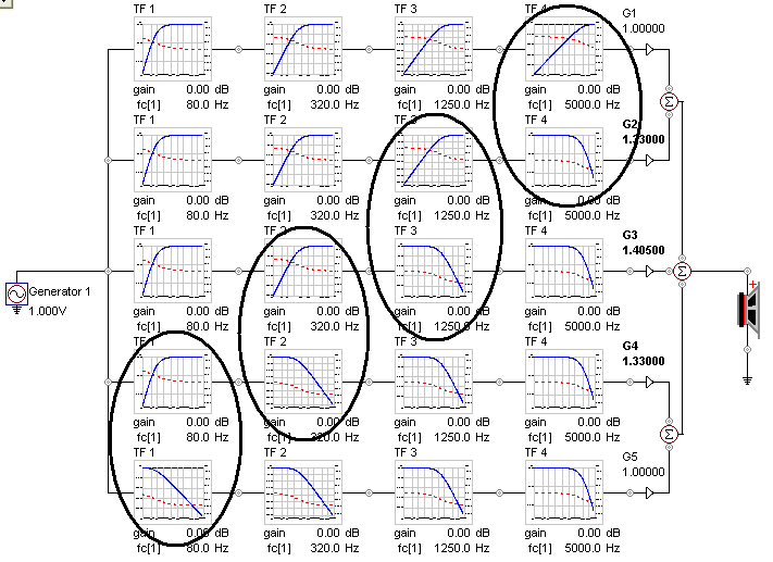

I was looking at the array that Dennis H. had put up and it finally made sense why it works. I know that it works from a transfer function point of view (all the S domain sections add up to unity transfer function) but wanted to understand it intuitively.
I've coppied Dennis' crossover diagram and circled a few of the sections. Note that each driver has 4 first order crossover section and as you go from the high frequency unit at the top you start with 4 highpasses. Second unit has 3 highpasses and one lowpass, third 2 hi and 2 low, etc. Also the high and lowpasses are all with shared frequencies so the tweeter has the crossover point it needs plus the crossover point of the upper mid, the "middle mid", the lower mid and the woofer. These extra roll offs make the crossover definitely higher than first order.
Note that only one driver is shown but the assumption is that each of the 5 crossover pathes is terminated by a driver.
But if you look at the encircled section note that for every pair of drivers considered, the effective crossover between the units is first order. In every case, outside the encircled bits, the extra crossovers would be indentical for that pair of units so although they would cause phase shift they cause no phase shift between the pair. Also, the phase shift they cause is not in the passband of either driver but "downstream". At that downstream point, another pair of drivers will dominate response and again they are crossing with a first order crossover (between them) and sharing all other poles.
So in the end you get a transient perfect crossover, but with enough other poles added to both greatly improve power handling and also to allow for some compensation of the inherent driver rolloffs. By that I mean that you have a much better chance of optimizing to the 2nd 3rd or 4th order acoustical target rolloff than you would of making a driver hit a 1st order target over any appreciable bandwidth.
Note that this only works well with a multiway system with lots of sections. Using it as a 5-way means the extra poles downstream aren't too far removed and the bandwidth requirement of each driver is lessened. As a 5 way the power handling is considerably better, primarily because the multiple extra poles give effective electrical filtering. This works best with more sections because the extra rolloff points are less removed from the fundamental crossover point.
