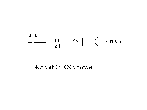

I finally got around to trying out some KSN1038s. The idea of running these without a crossover is nothing but a marketing ploy. Unmodified, I would not use them crossed over at less than 10K. Their efficiency is not that great either, above 10K anyhow.

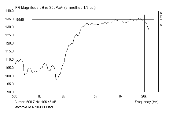

In my application, I wanted 103dB/w/m. Recalling Fredi's suggestion in another post, I stepped up the voltage with the aid of an auto transformer. Still about 8 dB short. However it did flatten out the FR, a combination of electronic/acoustic x-over.
The resultant f/r.
The best I have heard these is with the shunt 33ohm res, and a series 0.47uf poly cap. That will provide about 91 dB/w above 10Khz.
Try and use them x-o ed at 5K and they sound like a disco. The top end is worth exploiting, if you have some laying about. But I think my solution is with new whizzer cones.

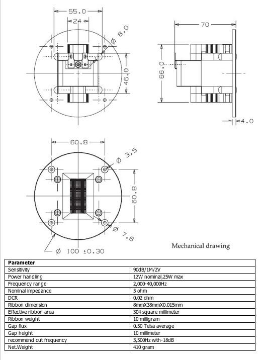

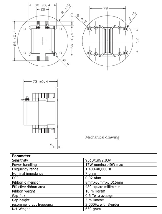

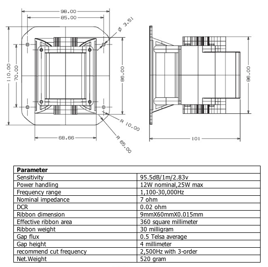

I have Alpair 10 units - very smooth and nice but a little shy in the treble. So wanting to add a ribbon supertweeter with a simple capacitor rather than using a 2-way crossover. Alpair 10 are about 88db so one question is matching. I've been looking at Fountek Neo CD1, 3 and 3.5H and Aurum Cantus G2si. The cheapest of these is the Neo CD1, but I'm wondering if this would match the Alpair since the sensitivity is 90db - pretty identical but leaves nothing in reserve. The others are 90-something.
I'm sure adding a ribbon is nothing new, so hopefully others can report on good solutions (the JX92 would be a similar case). Can anyone give me some help and guidance or experiences of such ribbons, or indeed suggest any other tweeter type? There's virtually nothing online on the Neo CD1, but more on the other models. Specifications show the CD1, CD3, CD3.5 and G2si left to right.

I'm using G2si on top of Fostex FE204 (older brother of FE206). Crossed with 2uF Siemens MKV cap and L-padded with Mills resistors. All I can say the top end from this units are really of high quality.

As to the Aurum Cantus G2si it is great unit for it's money, really cheap actually for what it does, try them for your Alpairs.
