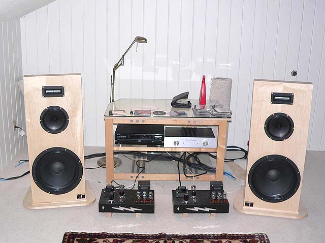

Attached is a picture i just got from a client of his B200 based OB (B200 has plugs and has been treated lightly with C37 (which lowers the noise floor of the cone). The phase plugs and the sideways ribbon allow a higher XO so more of the seemless magic of the FR can be used to a greater extent.

Is it possible to know the X-over points of that one (between B200 and ribbon, and the woofer as well)?
