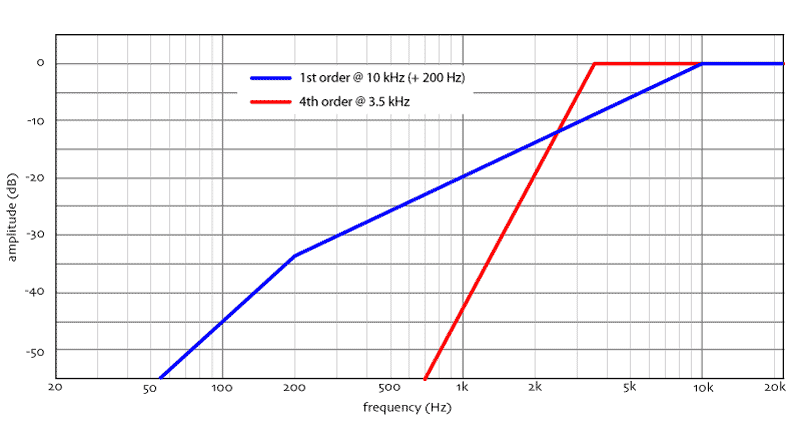

If you look at the recommended XO point & slope for most ribbons you note that they are typically 2.5-3.5 kHz but with minimum 4th order/6th order preferred.
Way to steep for us FR guys.
1st order at 10k gives the same attenuation as a 4th order at 3.5 kHz at about 1.5 kHz. Below that it is getting more energy. The extra knee at 200 Hz (+ a 3rd knee at the frequency the OPT rolls off -- ie if you use a SS amp things will be worse), makes the difference between life & death. Fortunately replacement ribbons are fairly cheap & easy to install.
As to the B200s, you can always take the knife to them yourself :^)
dave
dave
Dave,..can you explain this once more, I am kinda slow.....*s*
JandG said:1st order at 10k gives the same attenuation as a 4th order at 3.5 kHz at about 1.5 kHz.
Looks like thr top of my head math was off -- it should be 2.5 kHz not 1.5 kHz... graphic attached
dave
Good graph Dave, makes it easy to see what you were trying to say.

Geoff H said:If the energy below 2KHz is a concern you could try a 2nd line filter at about 2.5Kz/6dB/oct. The added phase shift at such a low level shouldn't be a problem.
How?
If it was active, i'd add a cap to add a knee a couple ocatves below the 10k turnover, but i don't know how you do 2 knees in a passive XO.
dave
You need 2 passive filters in series, or preferably separated by a voltage follower or other stage.
Geoff.
edit: the load of the second hi pass needs to be greater than the design R of the first.
Geoff.
That isn't going to worl here where the tweeter is passively XOed and the same amp drives the B200 & the tweeer.
dave
