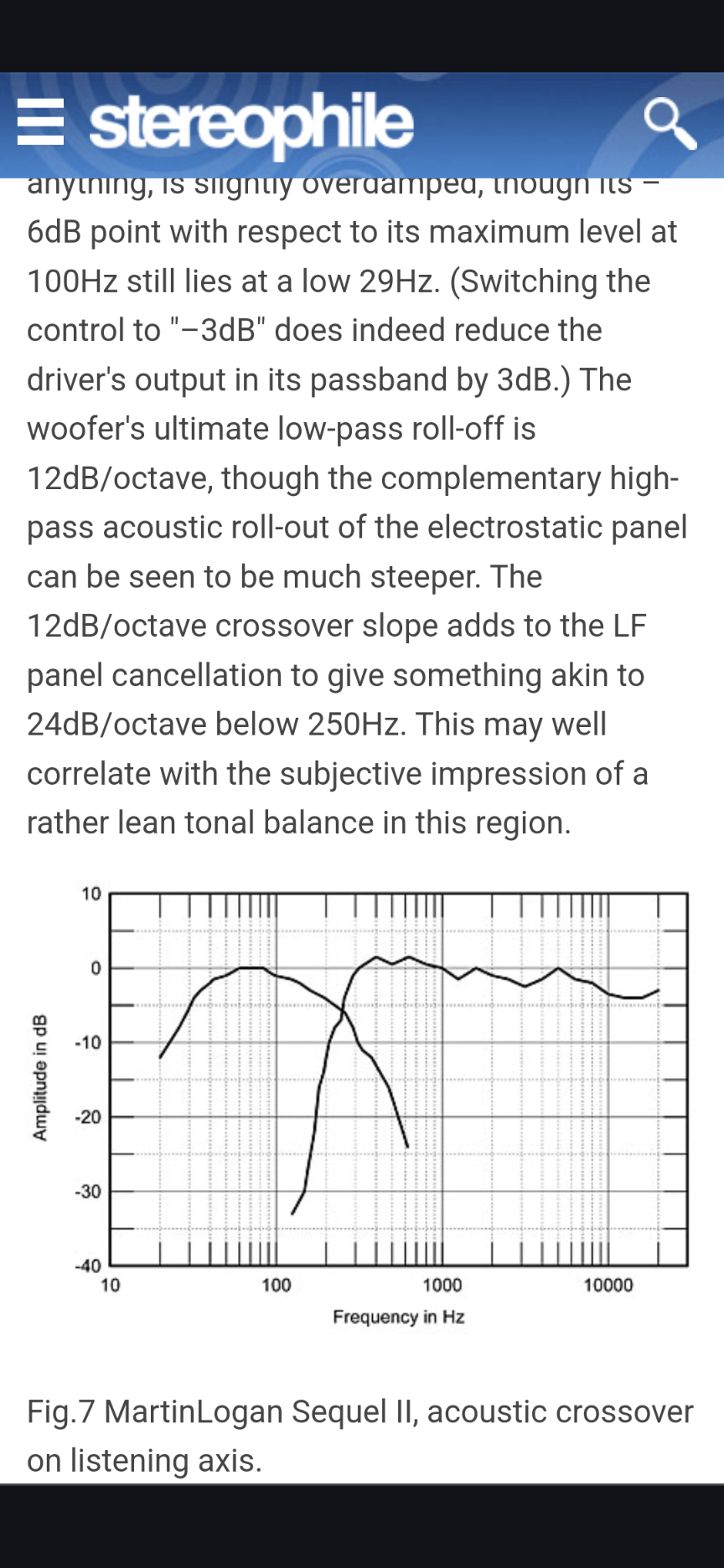

Per stereophile, the ML panel has an acoustic rolloff of 12db, combined with a 12db give an effective XO of 24db.
Since my speakers do not have an acoustic roll off at the 250 XO point, I will stick with 24db xo.

I have a vague recollection of ML using two woofers and manipulating the phase. The woofer module is a dipole at its upper end and a monopole at the lower end.

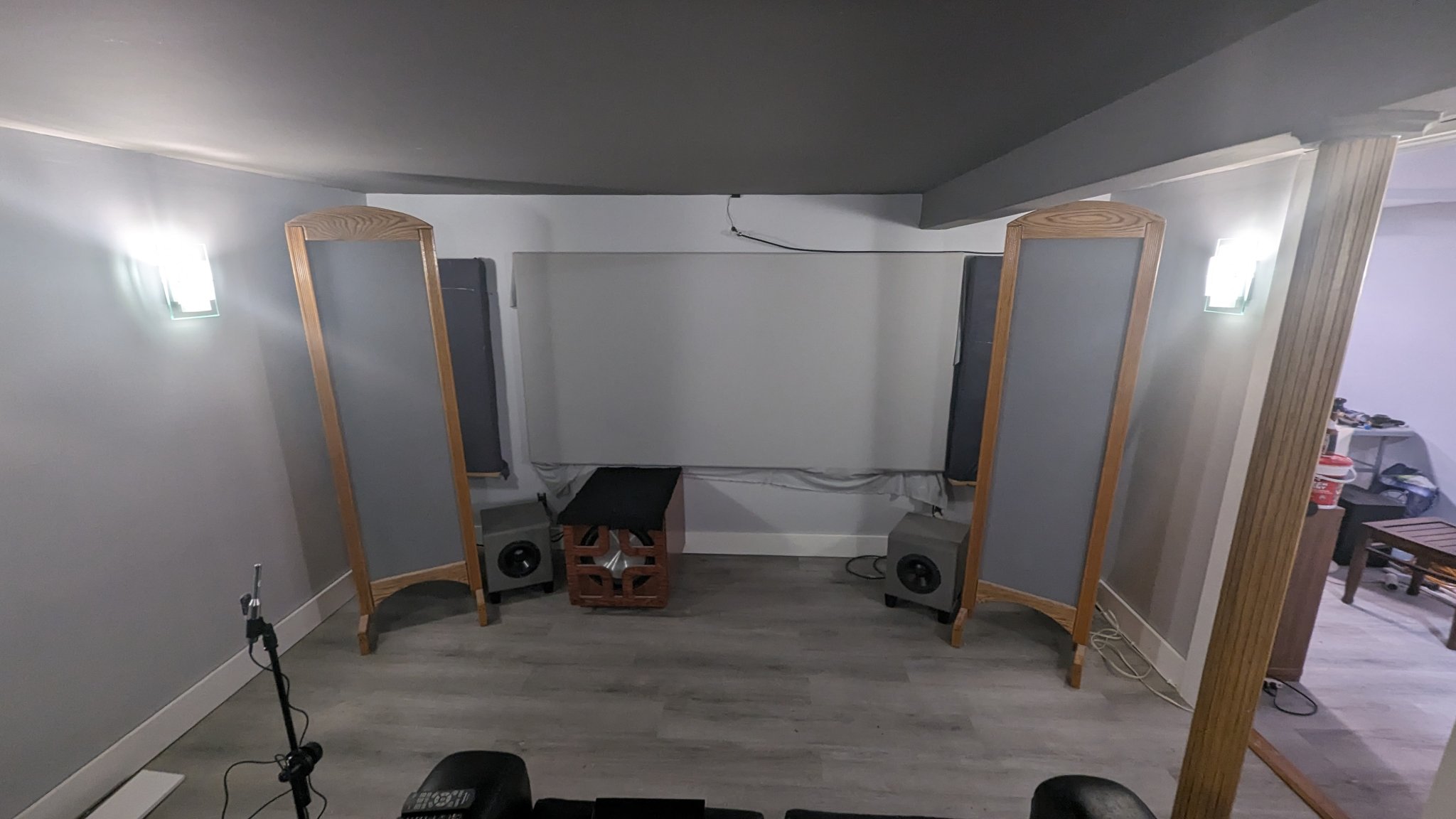

At the moment low pass at 55Hz. I am still experimenting with the crossover. Maybe high pass the LRS+, we will see.
I use a Yamaha pro amp, maybe you can see it in the picture. Reversing half the drivers, but also reverse the phase on them. This has the advantage to cancel out spider resonances. Maybe you can hear them, may be not, But the look cool! And GR research and others are doing the same. I can see them cancelling out thought, on my impedance measurements but they are outside of the used frequency range.
After I posted I guessed it was nulling any acoustic issues the way balanced cables null then out.
What amps are driving them?

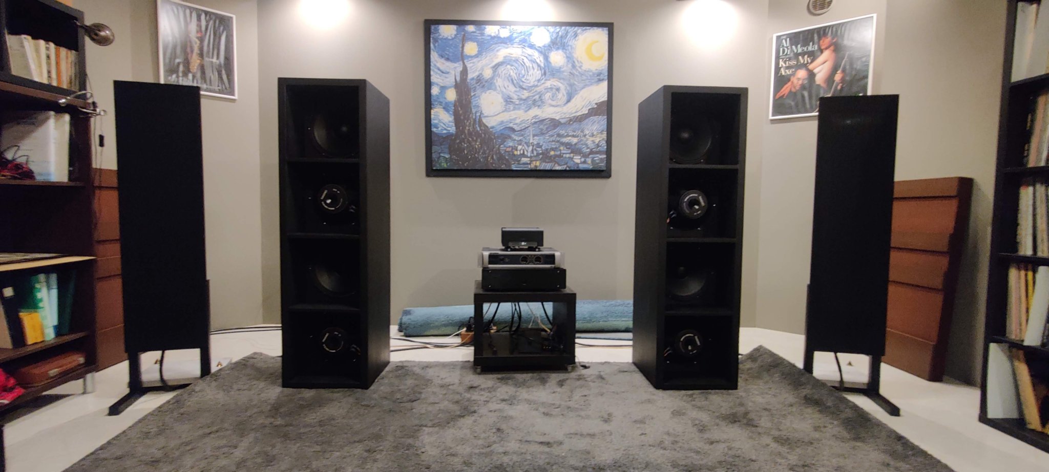

Did I miss it, or has someone mentioned an open baffle line array of woofers yet? Magnepan has been demonstrating the UBS comprising 4 forward and 4 backward firing 6 " woofers for a while now, so I am surprised that there isn't some similar DIY approach.

That configuration doesn't cancel spider resonances. 🙂 It does reduce even-order distortion because half the drivers are operating "inversely" to the other half.At the moment low pass at 55Hz. I am still experimenting with the crossover. Maybe high pass the LRS+, we will see.
You have way more woofers there than would be needed for SPL matching to the LRS+. But, you have sufficient capability should you go to larger Magnepan's.
What you don't have there is any sort of mechanical force cancellation, since all cones are moving in the same direction all the time.

I have the Magnepan 1.6 and have previously built and used a Ripole similar to the Linkwitz Phoenix Woofer3. More recently a pair of open baffle dual 12" servo subs. However, I am really curious about a line array that can sit alongside the planar. This appeals because:
1. Potentially lower cost than a pair of servo open baffle subs,
2. A line array might better match the propagation characteristics of a planar and there may be an advantage in soundstage/imaging by keeping the mid-bass/bass tied to the planars rather than as separately located subs
3. Staying with non-servo conventional drivers leaves the option to do the cross over at line level and biamp in the future
4. The structure could be built so as to brace the planar - which seems a very popular mod among Maggie owners (but not something I have tried)
An open baffle vertical line array of multiple identical woofers. This is not a full range speaker, but a mid bass project. Ideally I'd like to see performance down to <40Hz and up beyond 1kHz. Gain would be matched to a planar at ~85dB. Crossover would be in the Lower frequencies for mostly non-musical / HT purposes could be dealt with by a pair of El-Pipe-Os (ref. Nelson Pass)
