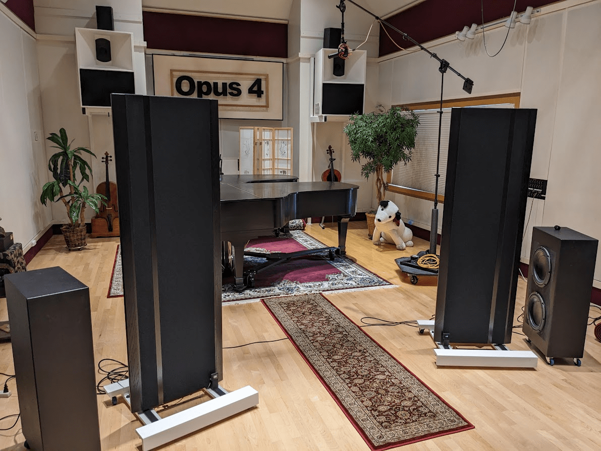

Not too different from what you are doing. I recently completed work on a pair of 3.7i speakers. They have active crossovers now and we added these slender woofer boxes with two 12" Eminence woofers in each to take over the bass at 100 Hz. So they handle 27Hz up to 100 Hz. The results are really great. If you plan to have the woofers close to the panels it's good to place them at right angle to the Magnepans so they don't push the membranes around with the bass.

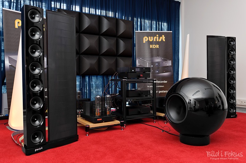

Old memories of hearing the Martin Logan E2 Statements. Anyone know which mid bass driver they used as the clarity was in matched IMHO.
while a digital LMS is a powerful tool it can't solve the problem of differing distribution character between dipole and monopole.
With the system I've shown above, as well as the ML Statement2, the problem is tackled in a way that with falling frequencies the transitions from dipolar cylindrical to dipolar lobed to monopolar are smooth.
The hard break in distribution character between a too high xovered monopolar sub and a dipole leads to the often experienced slow and lagging bass sound.

The behavior depends on the wavelength of sound (1KHz is ~1 foot wavelength).
A dipole has a figure-eight radiation pattern. At high frequencies, the wavelength is short compared to the dimensions of the speaker and so the front and rear waves act independently. At low frequencies, the wavelength is long and so cancellation occurs. Dipole speakers are designed to compensate by boosting low frequencies.
A monopole has a spherical radiation pattern. Due to the baffle, box speakers are omnidirectional at low frequencies but become front-firing at high frequencies. This produces the characteristic box speaker sound. For your purpose, the woofer will be omnidirectional.
I think Calvin has stated the key to success - the transitions have to be gradual.
Ed
Ed
I believe that Martin-Logan claims their woofer module transitions smoothly from dipole to monopole. I don't know how they do that.
