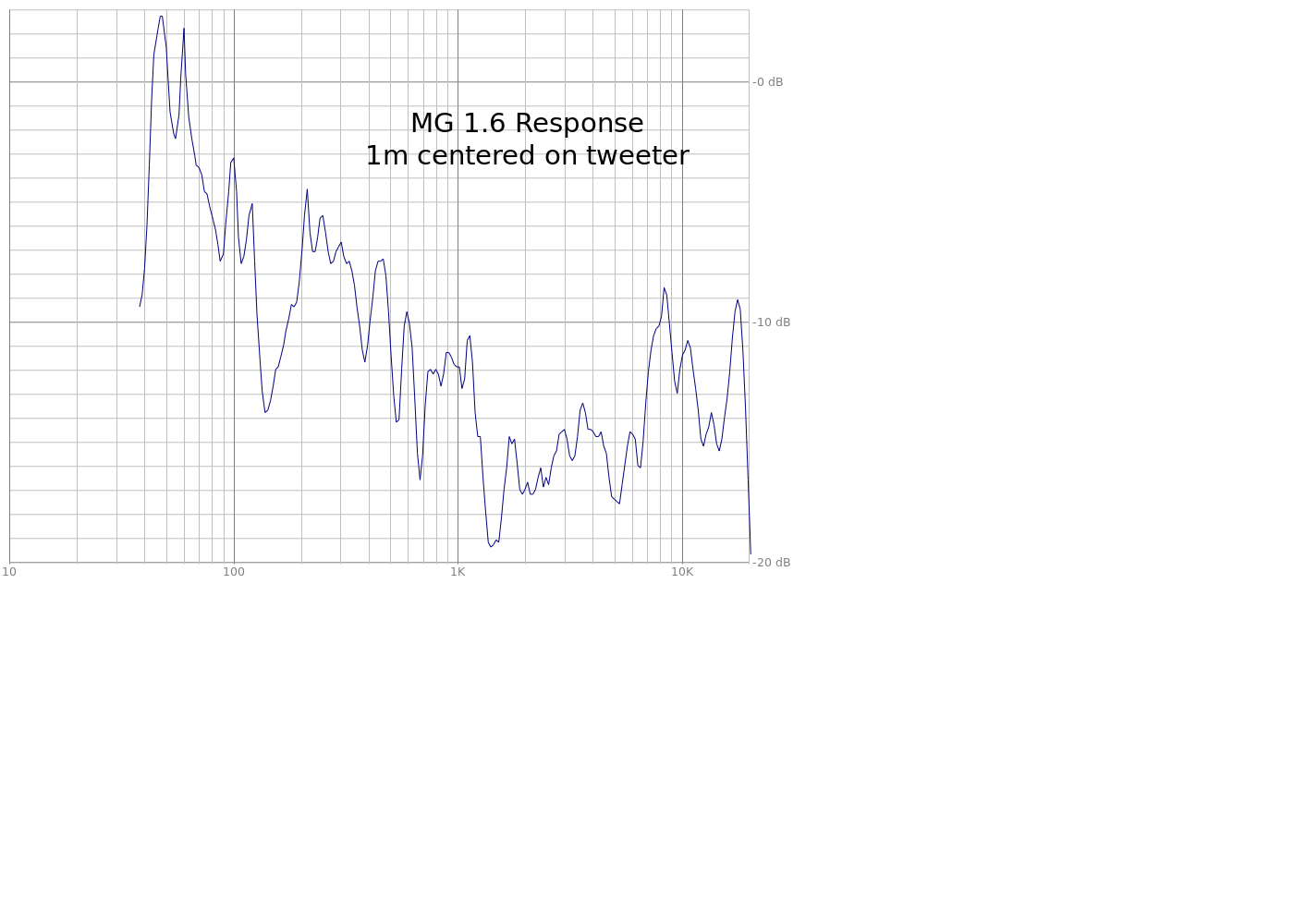

I measured the MG1.6 bass panel resonance at 47Hz. The MG1.6 should be good down to 42Hz.
If you want more mid-bass, you may want to try attenuating the tweeter. I use 0.39 ohm resistors to reduce the tweeter level by 1dB. This makes the MG1.6 even more coherent by narrowing the gap at the crossover.
Ed
Ed

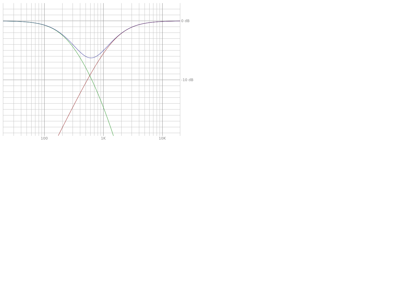

I had all that except the -9 db for the tweeter... ThanksThe low-pass section is 12dB/octave. The high-pass section is 6dB/octave. The crossover is at 600Hz but -9dB.
Ed

Okay. I suggest starting with the response of the stock crossover so that you know what the MG1.6 sounds like in stock form.
You have the hardware to do better dipole compensation than the stock speaker (which uses the crossover and bass panel resonances). The stock MG1.6 has a lot of boost in the mid-bass.
Ed
Ed
