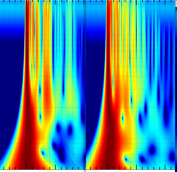

I would appreciate some comments upon this blink comparison of a wavelet analysis. Only from engineers please and from a point of view of which driver might be best employed in a speaker system, to be used as a reference for comparison, in audible double blind tests with other drivers. I would appreciate your comments upon why you choose a particular unit. To activate the blink just roll your mouse off of the page.
Enable Tests
Other data presentation formats can be provided at request.

Bud,
The comparison says:
mouse over to invoke stock change (2 different drivers, 1 stock, 1 treated)
The two different drivers presented in your Enable tests look different in delay vs frequency. I would expect two different drivers to look different.
I’m not understanding your request:
“which driver might be best employed in a speaker system, to be used as a reference for comparison, in audible double blind tests with other drivers.”
My preferred reference for comparison would be two closely matched broken in drivers of the same type (matched prior to modification, after break in) in identical enclosures, one modified , one stock.
I would also want to compare the modified driver before and after modification traces to compare the modification vs driver differences.
Do you have any comparisons of a broken in stock driver and the same driver after treatment?
As far as data presentation formats, I find overlayed amplitude response and phase response to be convenient for comparisons.

I'm not sure which, is which, but I'd take the one on the right in Art's side by side image. They seem to have some trade offs, but the worst offender is that junk around 1.5 to 4khz and 1.5ms and then again around 4ms. I'm on my phone now so hopefully I'm looking at it right. My choice has more junk but it's tighter and more spread out in frequency so likely less audible. The 1.5 to 4khz range on the one I wouldn't pick is more likely to stick out. Critical frequency and further in time. Otherwise my pick might be worse.
I too don't totally understand the question. I think you're asking which one would I think I'd pick in a blind test? It would be the one on the right.
