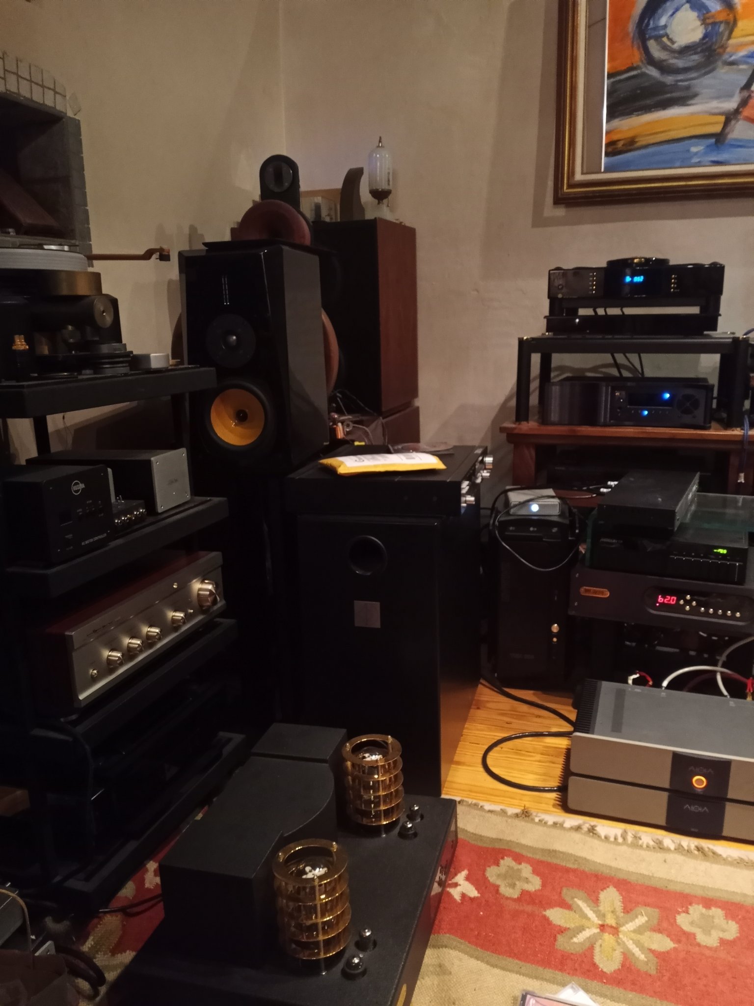

Hmm... we rebuilt the house to the studs, added more space, added lots of dedicated AC homeruns.. calculated the acoustics of the rooms while doing the design, then found the best places for the speakers and couches, oh.. and we used double layered drywall with acoustic drywall and/or plywood (for quake shear wall strength - which helps a lot with controlling bass energy too )...
Also, my main 2ch rig uses TWO Entec woofers... my den's HT uses two PSB Gold-i ( described by PSB as a minimonitor on top of a subwoofer ).. that makes it TWO subwoofers..
I defeated all audio processing in our Emotiva pre/pro. The main 2ch and HT rigs are off by ~7" the center line... Maggies are four feet from the wall, no need for stinking woofers... Audio Notes and Entecs are on the same plane... heck I've ended up using the Entecs as the base for the ANs... perfect height.
We have very smooth audio response in the den and living room. You can walk around and not hear any unevenness of bass response at all. Heck with the Maggies, the dining room, room adjacent to living room, the sound of the 2ch system is outstanding as well. No booms! No suck outs!
