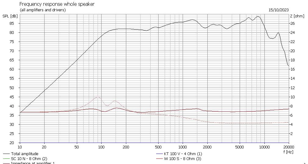

So the select transformer appears to change the optimisers goals. So added one of it's calc'd Z corrections. Optimised and it did improve it. Then added a fairly random RC to the circuit. The effect is shown dotted, the higher F slope. Double peak close to the first optimisation. Solid what the optimiser did when the add on RC was included. All of the previous values where changed. This is with box.
I've just added an L pad to remove 8dB. Result Z is now very close to a straight line at 8ohm. This one is mid range. The woofer has to be 4ohm. I'm wondering if I should switch this one to 4. Or try and bring it down from 8 with the L pad.

There is no reason or benefit to making it 4 ohms.. however the L-pad itself does help to bring the impedance closer to flat so make good use of it.
I tried correcting the woofer again. i did look at using an RLC but it wanted 2,5mF so didn't try it. This time I did an optimised it, That gave a sensible value for C. Then added the RC circuit, Result a pretty flat 4ohm line across the whole F range. The other 2 are 8ohm and 10ohm.
Amp sees ~2ohm all connected. I've no idea what crossovers will do to that. So next step to see.
