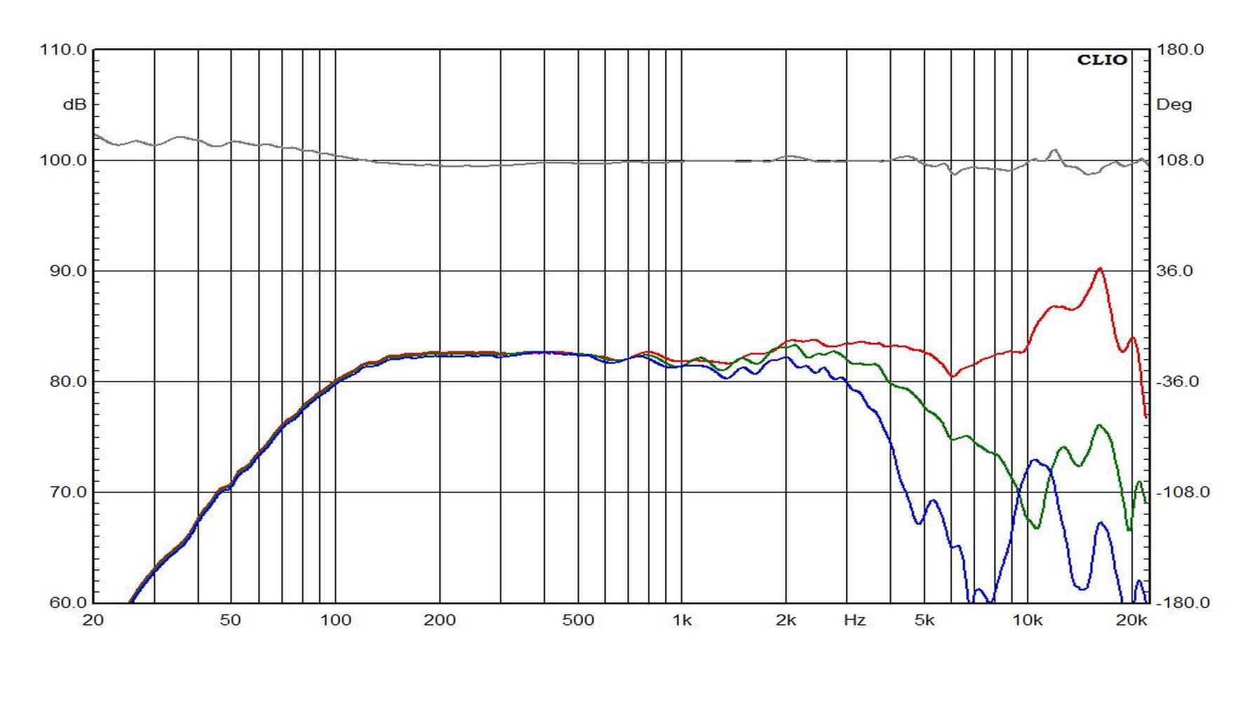

1. Just to add the tweeter, let the RS100 run full range and filter the tweeter at about 3.5kHz (30 degree off axis FR plot here, green line it's for the 8ohm variant but the 4 ohm version should be pretty similar).
I think this is the simplest approach but if I aim for a flat off-axis response, the on-axis will look like trash because it will be both tilted upwards and I will also have to deal with comb filtering because the tweeter and the woofer will play the same frequencies, and due to the wave travel paths not being equal based on how I move it might look a little be better or worse. Impedance also might become an issue. I have no idea how bad this might be.

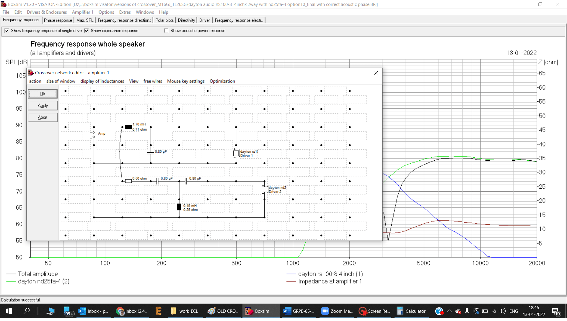

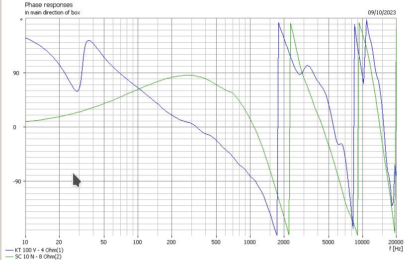

we are in same situation, i also would like to add a bit of top end to my RS-100-8 HT speaker, ported 4 ltrs.
I am going to do it wiith a DAYTON ND25FA.
You see a large dip in FR in the background, because the polarity of twtr is reversed.
when normal, i see a +/-2 dB response.
disclaimer: all of it simulated in Visaton's Boxsim software, driver FR from datasheets.

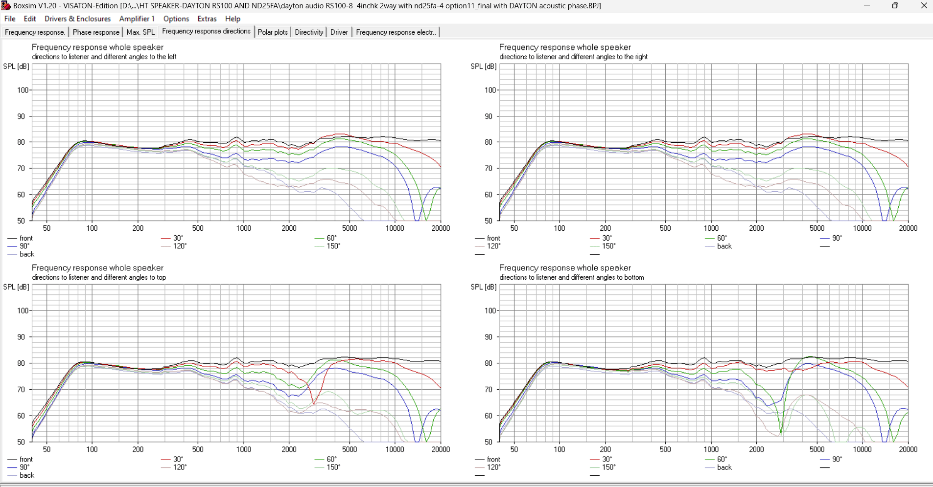

Thank you. Do you have any tips about crossover design on how to avoid lobing in the first place?
I'll try to move to VituixCAD since XSim can't work on multiple axes and that's what I've what always used.
The ND25FA is another tweeter model I've considered but I'll try to fit a smaller one to bring the acoustic centers as close as possible, because high max SPL isn't required for this speaker since I live in an apartment.
do you mean these plots?
I used these simply becaue they were available locally at a hi-fi store.
you can look at ND25FN-4 if you want smaller one and mount them close together.
boxsim is a difficult software to learn, but once you get the hang of it, you can try different things like moving around the drivers , changing box size, etc.
center uses PC83-8 with ND25FA, in MTM, its about 5dB more sensitive. The store ran out of RS100-8, just had 5 of them

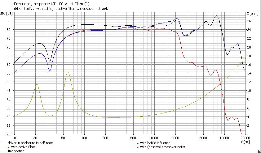

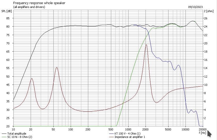

I'm using version 2. Crossovers. There is a calculator that needs the impedance of the drivers at the frequency it's going to be used at, Before that the spl of the 2 drivers may need correcting. There is a calculator to remove xdB. The resistance of this has to be added to the driver it's applied to if this method is used. These are under extras, The speaker impedance can be read of the plot.

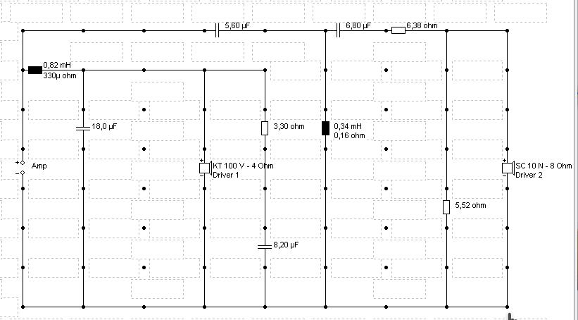

LOL Where things go wrong. This is ambitious. Whole speaker response.
What happened to the hf cut off - slope of the driver impedance at cross over -IMHO anyway.
The crossover
The RC across the woofer - some impedance correction. It has a calculator for that, The R network on the tweeter - putting them there tends to mask driver impedance variation. Probably pointless on a tweeter but also allows more LC to be added across the R's for more correction. There is a calculator to set the dB reduction.
Phase - I feel it needs to be better
The optimiser can only get things to some point. The above is a mix of selective use of it and when cap values are standardised all of it except caps.
😉 The woofer is a woofer to trying to get it to work to 2kHz is bound to be tricky.
