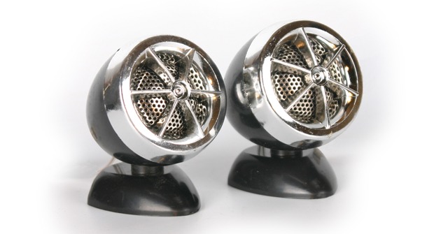

I'm planning on building a pair of rear surround speakers for my system. They will be used mainly for music, but movies too. I have quite a few 5.1 albums which I'd love to listen.
I have a pair of Dayton Audio RS100-4 (4", long-throw, aluminium cone, 4 ohm fullrange speakers) laying around that I would like to use for this job.
Usually, I'd use them alone by themselves without any tweeters, but since I'd be listening mostly off axis I'd love them to have a good off axis response. Therefore I think I need to add a tweeter.
I've been thinking on how to do this and every approach I can come off with has its own set of drawbacks and I can't decide. I'll list them here.
1. Just to add the tweeter, let the RS100 run full range and filter the tweeter at about 3.5kHz (30 degree off axis FR plot here, green line it's for the 8ohm variant but the 4 ohm version should be pretty similar).
I think this is the simplest approach but if I aim for a flat off-axis response, the on-axis will look like trash because it will be both tilted upwards and I will also have to deal with comb filtering because the tweeter and the woofer will play the same frequencies, and due to the wave travel paths not being equal based on how I move it might look a little be better or worse. Impedance also might become an issue. I have no idea how bad this might be.
2. Treat the RS100 as a regular midwoofer and use a regular 2-way LP/HP 1st or 2nd order crossover and cross lower (I'm thinking in the 2.5kHz/3kHz ballpark). In theory this should be the approach the will provide the best on-axis and off-axis, closely matching the directivity between the two speakers. However, the damping factor will be pretty low. The RS100 already have a high Qts, which is already somewhat compromised by the 10m (32ft) of wire that I will have to run from my receiver to the speakers. I would prefer to avoid adding another choke point in the form of an inductor.
2b. What if I did this but instead of using an electrical crossover on the RS100 I used a "mechanical" one (eg. a piece of cloth in front of the woofer)? Would this work? Has anyone had any experience with this?
3. Get a very small tweeter (I'm thinking SB Acoustics SB14ST-C000-4), remove the phase plug of the woofer, and make it into a coaxial. Then I'd just filter the tweeter and let the RS100 run full-range. This way I'd have to deal only with the rising response on-axis and not with comb filtering, because the wave paths of the woofer and the tweeter would be equal.
4. Sell the RS100 and get something else :'
I can use DSP on the entire channel, I'm using a PC as a source that is running Equalizer APO so I have access to many filters. The speakers will be hanged on to a wall, at the two opposite corners of the room, near the ceiling. I don't think I have to deal with baffle step because of such placement.

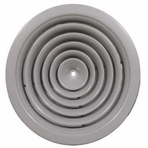

Manger used once for his Manger fullrange transducer a star like diffusor.
It can widen up dispersion without adding a delay like some other diffusing elements.
Here you see it for a tweeter but you can build it out of craft paper more deep and bigger

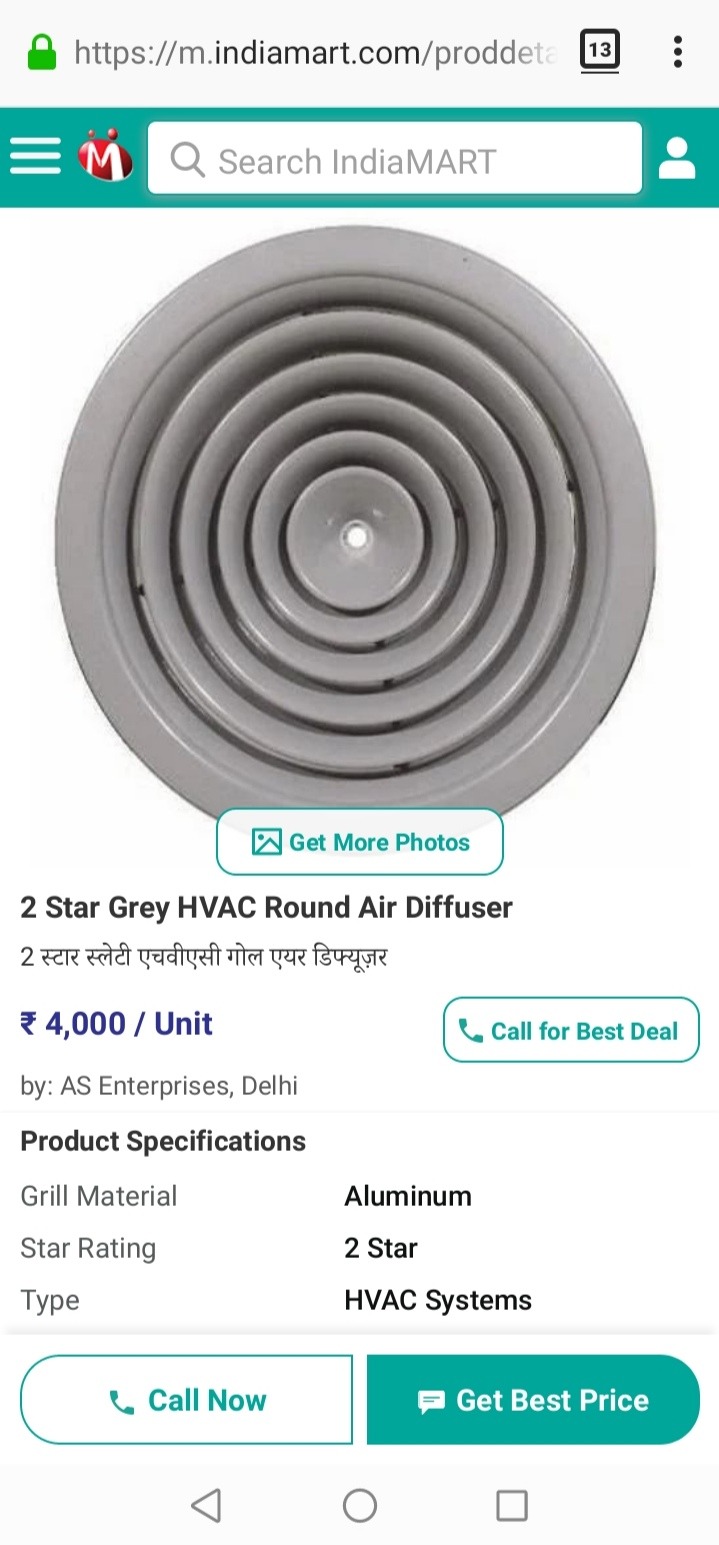

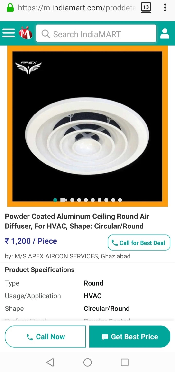

This one adds delay but it's worth a try
https://m.indiamart.com/proddetail/hvac-round-air-diffuser-19127827248.html
