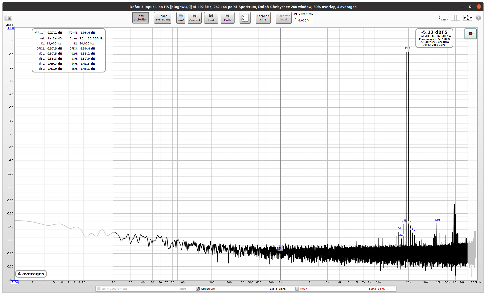

One way to lower the higher harmonics of ES9038Q2M is to lower the DAC clock albeit with some increase in noise floor.
Here is the same setup with 11.2896MHz clock (earlier was 45.1584MHz). Also the input is now -1dBFS. With these changes the result meets PMA's requirements 🙂
Yes, this looks good and it keeps good dynamic range (low N).

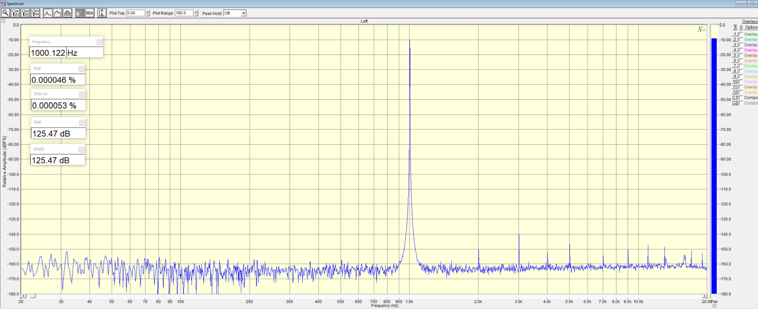

Have you tried HF linearity with clk/4 frequency, at least with 19+20kHz test? Would it be possible to make a meaningful THD20kHz test?

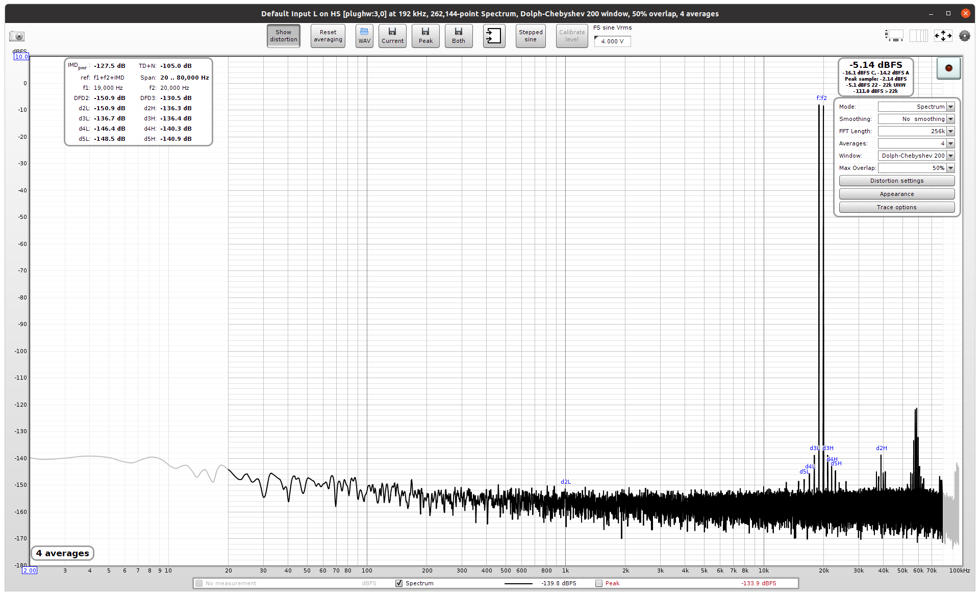

With 192k sample rate the ES9038Q2M DAC clock needs to be at least 36.864MHz so clk/4 does not work with 192k in my setup. Here is the CCIF IMD at 192k with 45.1583MHz clk (no divider).Have you tried HF linearity with clk/4 frequency, at least with 19+20kHz test? Would it be possible to make a meaningful THD20kHz test?
It is very good, good enough for amplifier testing. I guess these results are better than any AP?
Not necessarily. Have you tried the synchronous mode? It could be interesting to compare the results.With 192k sample rate the ES9038Q2M DAC clock needs to be at least 36.864MHz so clk/4 does not work with 192k in my setup.
I have 45M/49M clock in my setup so synchronous would require 352k/384k sampling rate. Unfortunately REW is not up to this in Linux. I need to change the clock to 22M/24M for 192k sampling rate.Not necessarily. Have you tried the synchronous mode? It could be interesting to compare the results.

This seems to be correct. Here is the CCIF@192k with ES9038Q2M in synchronous mode using 49M MCK with divider 2. Also 96k and 48k work with this setting. The improvement is only marginal but maybe with a better clock more improvement could be possible.Synchronous mode can work with higher frequency clocks works so long as they are integer multiples of the minimum synchronous clock frequency. IIRC ESS told the Twisted Pear guys about that. Alternatively, the internal MCLK divider can be used to lower the internal clock frequency.

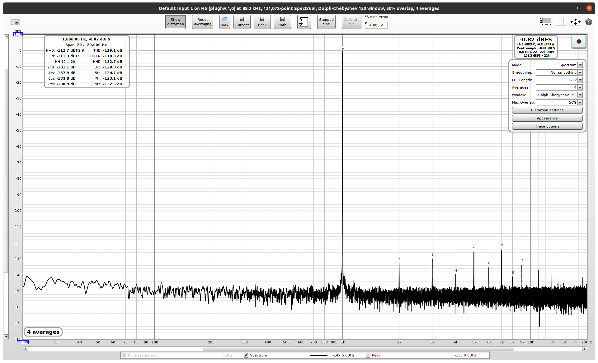

I have a question regarding ES9038Q2M. My take on ES9038Q2M is basically very similar to ESS evaluation board. I'm using OPA1612 as the AVCC buffer (OPA1612 in that spot resulted in lowest noise) and OPA1656 as IV and summing opamps. I noticed that when lowering the opamp power supply from +/-15V the loopback noise floor worsened by about 0.5dB (+/-12V) or 1dB (+/-9V) but THD remained the same. What might be the cause for this?
Here is the 1k@88k2 loopback at -1dBFS with some C2/C3 compensation. Not spectacular but that may be partly due to ADC (AK5394).

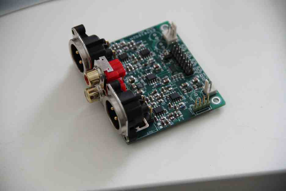

Do you use ebay ES9038Q2M with external IV circuit or your own board to get this result?
My own board. My other DAC boards share the same format so they are interchangeable. Forget about ebay boards as most of them have design flaws which cannot be fixed by hacking.Do you use ebay ES9038Q2M with external IV circuit or your own board to get this result?
It is part of a measurement setup / standalone dac I've been working on for my own use. The setup currently includes
Schematic of the DAC board in attachment. Some components are not according to schematic (e.g. board has OPA1656 as opamps and LP5907 regulators for DVDD/VCCA).
