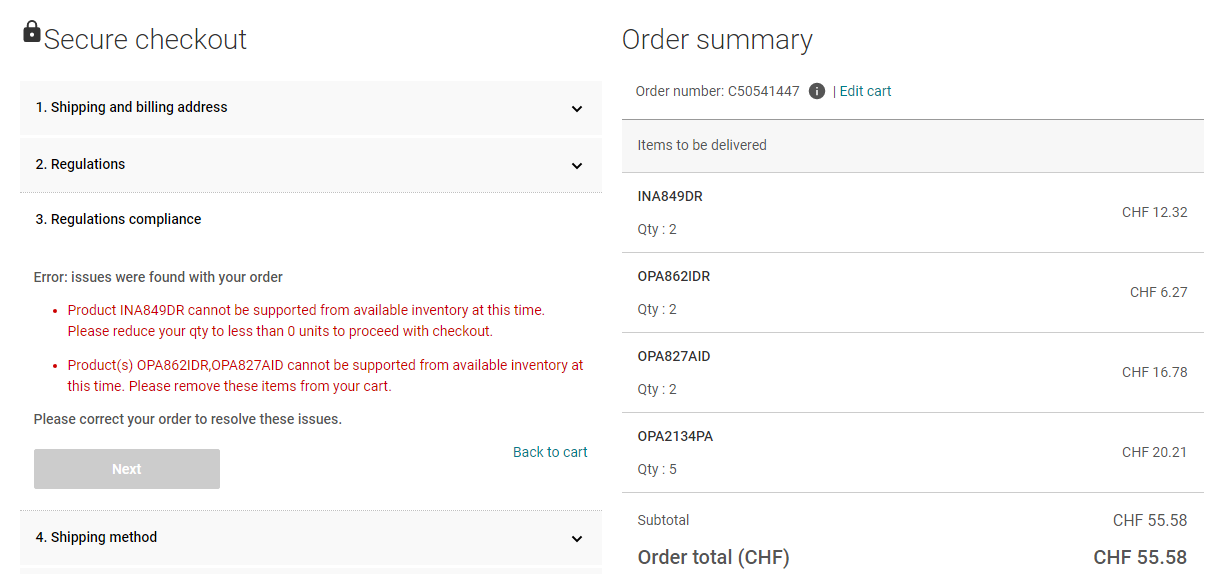

In my case it is one notch worse: even when they have the parts, TI refuse to sell me some of them.
They sold me OPA862 once, but since approx. 6 months it's a no go.
And in order to get INA849, I'd have to reduce the quantity to less than 0 (see att.).

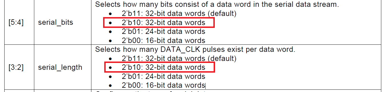

Before I pull the heavy guns (logic analyzer), and curse again ESS, does anybody know what's the difference between the default setting and the setting in red, below? This is ES9038PRO Register 2.
If I understood the question right:
The second - is the number of CLK pulses in one half frame (usually - 32)
The first - how many USED data (which really is significant only for right-justify bus format)
(Of course, DATA_CLK number >= data bits).
