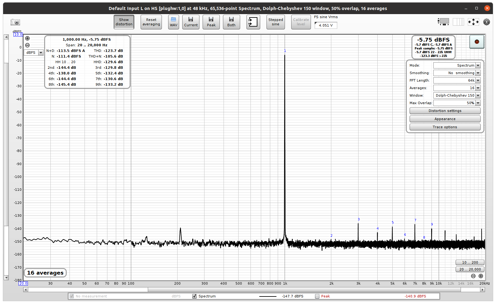

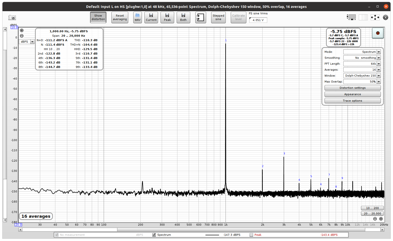

Here is my ES9038Q2M board without/with THD compensation. This is using one of the chips that has incorrect mousebite. The DAC output is at -1dBFS but I used my Autoranger to lower the output to -6dBFS which helps to hide the ADC distortion (AK5394). THD is closer to datasheet but THD+N is still quite far but that is partly related to using Autoranger to lower the gain.
BTW I'm now using my STM32F7 USBI2S bridge for both DAC and ADC although not yet in synchronized mode. The new USBI2S board has the DAC clocks outside of the isolator to be more compliant with the demands of the jitterati. More importantly I've also added two 5+1 isolators for isolated I2C and GPIO (2 for DAC and 4 for ADC). So now I'm able to use the same STM32F7 as both USBI2S bridge as well as MCU for DAC and ADC boards (or other stuff).

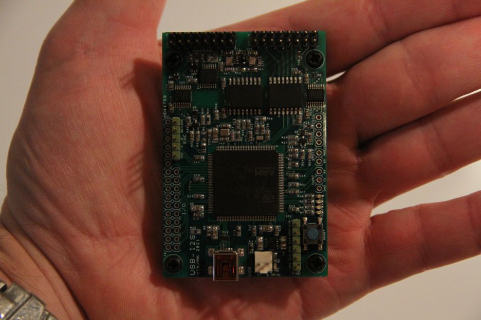

Here is the new incarnation of my STM32F723 USBI2S bridge. The size of the board remains the same (75x50mm). The I2S isolators are MAX14435F and the secondary isolators (I2C and GPIO) are SI8661.
For I2C isolation I used this:
https://www.ti.com/lit/an/slyt403a/slyt403a.pdf?ts=1636225345420&ref_url=https%253A%252F%252Fwww.google.com%252F
Although it looks sketchy with obscure resistances it actually works even with obtainable resistor values both in standard and fast mode with both AKM and ESS chips. However 2+1 (out, in) channels are needed as SDA needs to be bidirectional.
In case it is not obvious the purpose of this USBI2s bridge is to be used as a combined USBI2S bridge and MCU for testing DAC and ADC boards. Of course it can be used to implement USB audio DACs as well.
Why do you need two i2c interfaces?
Originally I had both I2S_out and I2S_in using the same I2C and used another I2C for e.g. OLED-displays. In the new board I just wanted to add some flexibility (probably not needed). Also using separate I2C interfaces helped the somewhat crowded layout (4-layer board).
Don’t you need to somehow sync the CLK_OUT with the LRCK and BCK? Or are both i2s in and out interfaces assuming the da and ad in master mode?
DAC is in slave mode. ADC in master mode.
The LRCK and BCK for I2S out are generated by the MCU from CLK which is also used for CLK_OUT. There may be some additional propagation delay in LRCK and BCK but so far I have not seen any problems (at least for 192k/32).

My board has 2 in and 2 out channels. STM32F723 has 4 SAIs so up to 8 channels should be possible.
What sampling rate are supported ?
The board has 45.1584 and 49.152 MHz clocks. I have tried up to 384k/32 output but that was with 98.304 MHz clock. My current ADC only works up to 192k/32 so have not tried more than that on the input side. Currently the output and input are not syncronized so both input and output are half-duplex. Full-duplex should be possible but I have not yet tested it.
Does it require audio drivers ? 5 (Linux/Windows compatibility)
No drivers are required. Unfortunately most audio tester SW (such as REW) currently require ASIO drivers for 32 bit audio in Windows. That is why I have used REW in Linux.
Is your design is based on the SDR-widget ?
No. My software has it's roots in the STM UAC1 stack. However not much of that remains.
Your board seem to work as USB / MCH streamer board from miniDSP, right ?
Don't know anything about USB / MCH streamer so hard to say.
Do you plane to make you design available in any way? (or open source?)
I have not yet made any plans. Open source is possible but I'm a bit wary about the copy-cats and vendors lurking around this site.
One thing would we great and are missing from other USB-I2S adapter is the ability to use it
as slave, with an external MCLK source.
That is certainly possible with STM32F7. However my board does not have a dedicated external MCLK connector.

But I should mention, that I do not really believe in THD measurements less than 0.00008% with my AK5394 based ADC, because ESS compensation always compensate DAC+ADC harmonics.
I noticed this same issue when I measured my THD compensated ES9038Q2M with another ADC as the compensation was way off. So apparently this feature is not very useful at least for standalone dacs.
If you're tuning a DACs THD compensation then it's only going to be as accurate as the ADC measuring it.
Likewise if you're tuning an ADCs THD compensation, but your DAC has limited performance, you're stuck.
This doesn't mean the THD compensation isn't useful, it means you have to take a lot of care in making sure you're compensating for the right thing.
For example if you've got an AP with distortion residuals down at -150dB then tuning the THD compensation in a DAC to a minimum of -140dB is going to be perfectly fine. Of course this could drift and require recalibration but this is normal for lots of test equipment.
