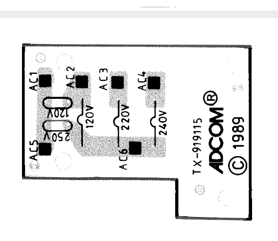

JackinNJ mentioned the transformer was a weak link - any recommendations for installing a better one? Maybe a decent toroid? (Something that will fit in the stock case, hopefully. I know the outboard power is the right way to reduce noise in many cases but having another box to deal with isn't optimal for me)
You could mount the transformer on the exterior of the chassis, but you'll need one which is enclosed.JackinNJ mentioned the transformer was a weak link - any recommendations for installing a better one? Maybe a decent toroid? (Something that will fit in the stock case, hopefully. I know the outboard power is the right way to reduce noise in many cases but having another box to deal with isn't optimal for me)
I prefer an EI transformer to a toroid...but I used an Amveco !
You could use a switcher with a pair of high quality regulators AND a "pseudo-ground". Too bad the DIYAUDIOSTORE is out of Jan Didden's "Silent Switcher".
That is not a bad idea. Build a 18 volt bipolar supply in an external case. The BA2018 by nelson pass uses those voltages. Leave the stock transformer in the case but unconnected. I was going to suggest against messing with the upgraded power supply as I have a BA2018 which I appreciate much more than the Adcom GFP565 (that isn't to say the Adcom was bad).
I would prefer to keep everything inside the case. I have nothing against those folks who want 10/10 out of their audio equipment and do remote power supplies, but the only time I ever consider heavy customization is when the shell/chassis are toast. I have one more 565 sitting at a friend's house and its pretty beat up, so I'll experiment on that one. The case is rusted out so I'll probably pick something neat to put the chassis in, like an old slimline PC. The volume knob is bent at an angle, so I'll look into doing a remote vol. If I go ahead with all that I'll try the outboard PS.
I'm curious, why do you prefer the EI transformer to a toroid? I've never had any kind of tf buzz out of toroids, but I have several units here with buzzing frame transformers. Most of them are NAD / Proton, but I've run into others.
You lost me there. Sorry, I'm still a rookie, 4 years into this hobby. 😆

FWIW you can add that 4th diode yourself : put the cap on top of the diode, wrap the cap leads around the diode leads, and solder it in place. Its very easy and I see no harm in doing it. If you want to be fancy, leave an air gap between the two and put a drop of hot melt glue in between.
One final note on this - you have an R901, but you're missing C901. I have all four caps, C901-C904, but my board is missing R901.
Thats one way to do it. Take a look at the transformer config board I mentioned above.
As long as the jumper for 120V operation is in place, you can delete the cap in the 120V position and install that new suppression disc capacitor in the 250V position. They're equivalent as far as circuit position and no different than jumping AC5 and AC6, just a little more elegant. Regardless of whichever you choose, I think its safe to delete the cap in the 120v location.
And there are people here with a lot more experience than me, so I hope they jump in and correct me if any of the points I've brought up aren't right. I'm still learning myself.

Result: Slight transformer buzz afterwards. Sound is still excellent but that buzz really ticks me off. I'll figure that out later.
Phase Six:
Install .01uF/250V Vishay WYO103MCMCF0KR Class X2 EMI suppression capacitor across AC5 to AC6
As I mentioned in my earlier post, I deleted the existing buzz-killer mylar disc from the transformer configuration board, and put the new Kemet disc in the nearby "250v" position. I installed it from beneath for a cleaner appearance. Either side will work.

What frequency is the buzz? A stupid check, I have tested preamps by setting them on my amplifier before. Last I remember, the GFP-565 is fairly silent and
well-shielded. However, I did chase a buzz problem on a Hafler DH-101 that I rebuilt only to figure out that setting it near my amp was the reason for the buzzing. This was after a couple of hours of scratching my head. Are all your solder joints good? Maybe go around and tap things with a chopstick to see if there is a change in the buzzing sound. It is unlikely that a new component is bad although it does happen. Are all the grounds making good contact etc.?
The buzz seems the same as every other frame transformer buzz I've ever experienced. This one is shielded and I'm assuming its potted under that shield, so I doubt the transformer is the trouble. I cleaned every pad prior to installing new parts. All the new joints were checked and in some cases I reflowed them after I trimmed the leads just because I can't stand how they look if I accidentally nip the solder when I'm doing the trim. Its ridiculous, I know, but I can't put the cover on knowing there's flat spots on the joints. OCD I guess.
I'm wondering if its possible that the diodes themselves could be contributing to the buzz. I only have UF4003 on hand, not the IN4003, and I don't know if that would be an appropriate replacement. There's always so much more to learn.
