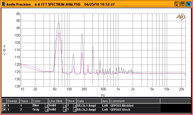

The Adcom is a nice preamp. Before doing the upgrade, I liked a Hafler DH-101 I have more. I liked it so much more that I sort of kicked the Adcom to my 2nd system and upgraded a bunch of parts on the Hafler. Now the Hafler doesn't even compare to the Adcom. I did a lot of A/B testing to be sure. That was my reasoning to why I think the upgrade worked out well. I am hearing a lot of little details that I don't think I've heard before.
Adcom GFP-565 Stereo Preamplifier Manual | HiFi Engine
Hi Mike, the chart you asked about is a noise floor comparison, the big spike around 55hz is due to the mains power, then the smaller spikes are harmonics from that. the magenta line indicates lower noise overall.
Six.
Six.
I am not too knowledgeable regarding electronics. Still have a lot to learn. What am I looking at here? I assume the Magenta line is an improvement.
Nice, that is definitely an improvement then. I have since built a DIYPass Nutube B1 Korg which is ridiculously nice sounding. I plan to setup a 2nd system in the somewhat near future. I am going to build a pair of Speaker Design Works - Travelers speakers. When I do that I may incorporate some of these mods to the Adcom GFP-565 and put it on that system.
Thanks for clarification on the graph. I am enjoying leaning so many new things through this hobby.
