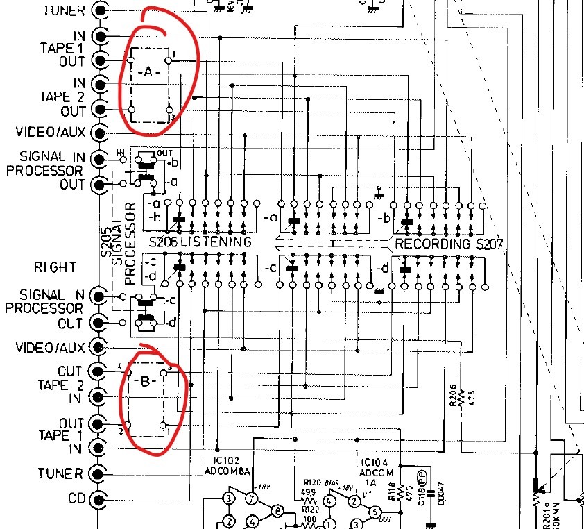

I might be wrong, but I think someone didn't put the right sticker on. If the numbers at the bottom are how many pins it is, because it's 4 pins. I have looked on ebay and there are quite a few with loudness. Making sure who to buy from is it.
