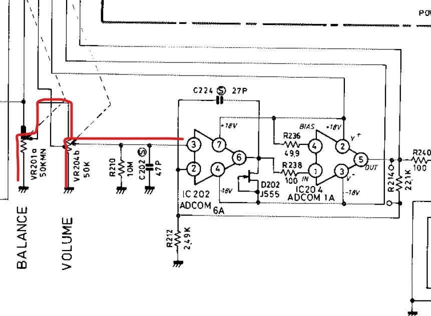

Yes. This for example. If the opamp were something like a NE5532 which has a high input bias current then that current (which can be as high as 800na according to the data sheet) flows out of the input pin and via the pot wiper to ground. 800na or 0.8uA may not sound much but it will develop 40 millivolts across a 50k resistor. Any voltage on pin 3 of IC202 will be amplified by the gain of the complete subcircuit so if you can measure a voltage that changes on pin 5 of IC204 for example as you turn the volume control then you have a problem.
DC current flowing in pot wipers is a major cause of noise although of course a pot can just be worn and noisy in its own right.
If this were a FET opamp (and maybe it is) then the bias current is to all practical intents and purposes zero (a few pico amps).

I am getting exactly 23 mV at pin 5 on either opamp 204 or its complement. This decreases as volume control increases, to about 1.5 mV.
I’m hard-pressed to find any source for this in either circuit as it is affecting BOTH circuits.
All other voltages so far as I can trace them from power supply forward, every test point indicated on the factory schematics are accurate enough (18V at TIP outputs, 15V at LM78/79)
I’ve even replaced the ICs (202 circuit) with original/OEM, no difference (pot was noisy when I got the unit a couple years ago).
If I spray with TCE/deoxit, it gets quiet for a bit, noise comes back in a few weeks.
Is this just a bad pot, or is there something else I should be looking at?

It may well be the pot as the main cause, it is a real possibility.
The small DC offset you measure sounds to me like the opamp is a standard bjt type (ordinary transistor input and not FET). If the IC's are easy to swap you could try a FET device for IC202 as a test to see if it helps. Something like an OPA134. The single is the OPA134, data sheet below is the dual version.

Adcom semiconductor equivalents are discussed in the thread https://www.diyaudio.com/community/threads/adcom-opamp-semiconductor-replacements.339904/
Adcom 1A = LT1010
Adcom 6A = LT1056
Adcom 1A = LT1010
Adcom 6A = LT1056
That's interesting because the LT1056 is a FET opamp (and coincidently the model I use most in LTspice simulations) and interesting because a FET opamp would not give such a change in DC offset as the source impedance (volume control) resistance changes.

I started off with stock, OEM LT1056 opamps, pots were noisy THEN. Chris Hoppe tells me he’s never had a problem with cleaning a pot, suggested I measure offset. I did that.
BEFORE fooling around with anything else, I recapped the board. High-quality Nichicon for power section *(bumping up the 6800 mF to 8200 mF power caps), new TIP110/115 transistors (one, I don’t recall which, HAD blown with only a few volts output), then replaced the voltage regulators with SPARKOS discrete units. ALL voltages are correct. I left R908 alone initially, then changed it to 12.1k for the OPA134AP’s, changed back for all other opamps).
I changed the gain section opamps from LT1056 to OPA134, then OPA604, NOW I‘m using SPARKOS labs 3601s and enjoy the sound, the improvement in reproduction, soundstage, very much. I’m going to stick with the SPARKOS units.
SPARKOS, however, operates a current bias in the milliamp range, 15mA IIRC (I mentioned this earlier in the thread, or maybe it’s the other one), while the OEM TEXAS INSTRUMENTS 604/2604s (I bought last year from Mouser.com) operate in the PICO amp range. I don’t know what the LT1056 units did, but again, the pots were already noisy.

My NEXT step is to go ahead and replace the pot with a dual 50k ALPS unit and cut out the tone control circuit - I don’t use it anyway.
I just wanted to rule OUT any other circuitry as the source of the bias voltage on output (yes, measureable on all three outputs, although lower on lab/norm vs bypass which is HIGHER, 23mV quiescent).

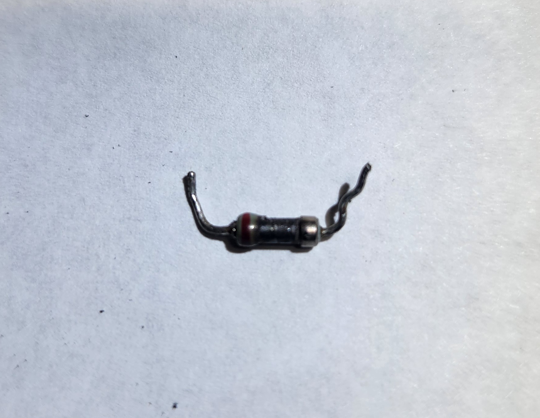

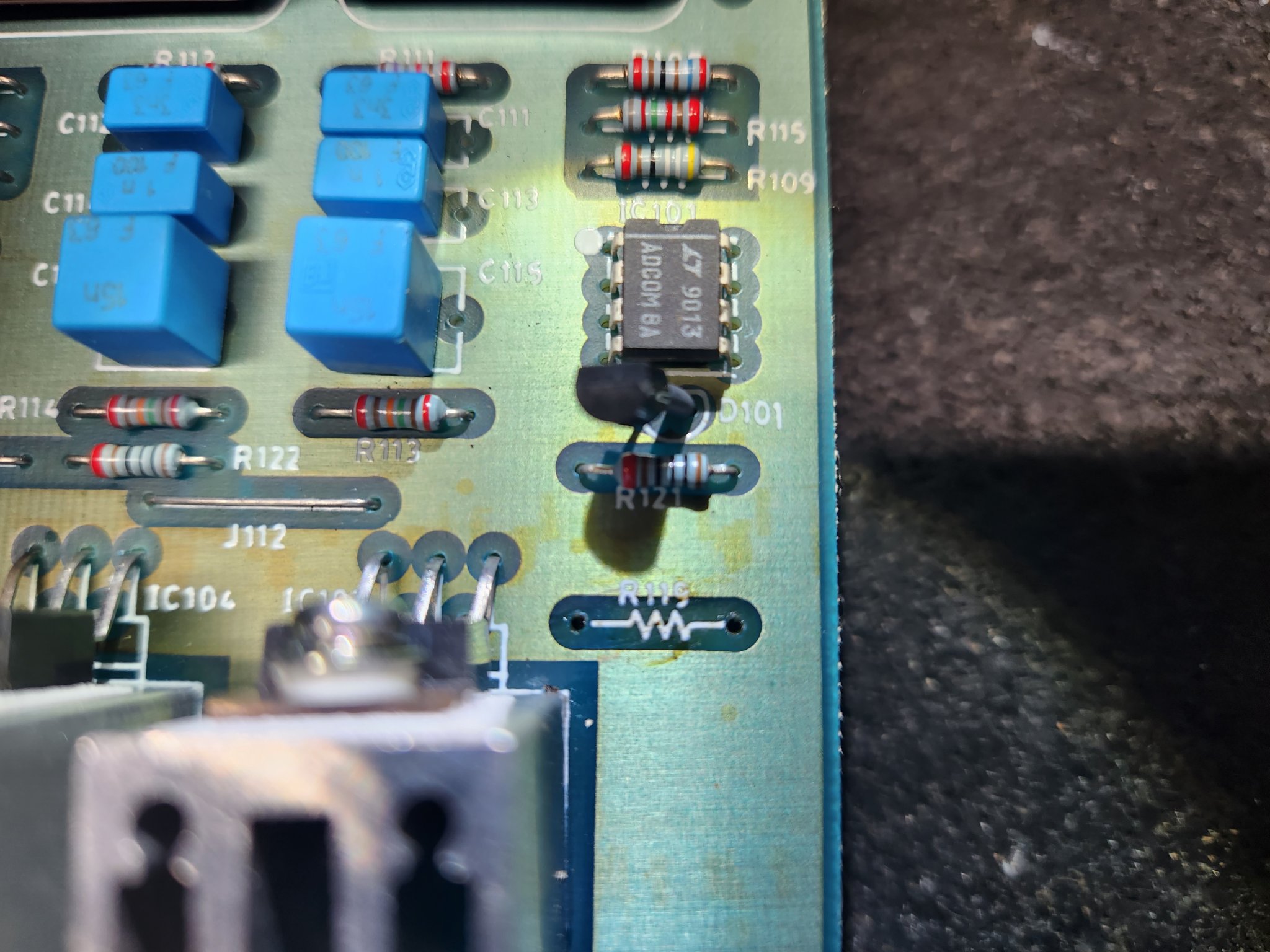

So I knew sooner or later knowing me I would screw something up and did, but I have to say that I am getting just a tiny bit better with the schematics. Not great or I wouldn't have screwed up. Now I'm starting to get a little frustrated with myself.
On checking the ICs I must have touched the wrong pin and burnt up a resistor. While I'm at it, I'm just going to replace a couple ICs, 401 and 402. 401 seems to be the one that is giving different readings. It's a chance I'm willing to take.

Are you saying you have burnt the 49.9 ohm (it looks to be written as 49.9 anyway)?
If you accidently shorted pin 4 to pin 3 then you placed 36 volts (the total supply of both rails added together) across the resistor. That would smoke it 😀
It is an unusual value as well.

I just did that the other day - TWICE. On IC 205. Despite using insulated needle-point probes for my DVM and while wearing 4 diopter magnifiers. BIG spark. Tone controls still work, sounds fine.

Well after my first resistor order got lost then had to reorder it finely came, but more bad news. After putting it in then turning on the power, the new one started smoking. Now i'm getting really frustrated. This was R119 resistor. My question now is when I was checking IC103 and shorted the R119 out, could I have shorted the inside of the IC to cause my second resistor to go bad?
