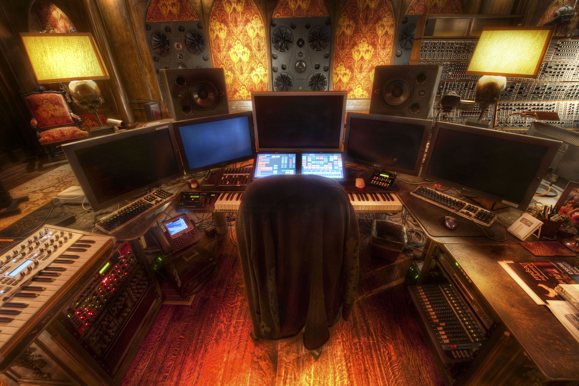

actually Julf, looks like Hans Zimmer has it under control (see insane 'home' studio below), but they wrote their own software and have unlimited budget with a coder on staff... as you can see.
they used it not only for control surfaces/midi/audio, but for managing massive hi-rez multitimbral sample based instruments for soundtrack work. (The Dark Knight, A league of their own, Inception etc.)
how they go with latency on live performance i'm not sure, perhaps they work with low res proxies and then sub in the hi-res when they are nearing completion/mixdown. which would be an option for you too hipro5, but does add another layer of complexity on the programming

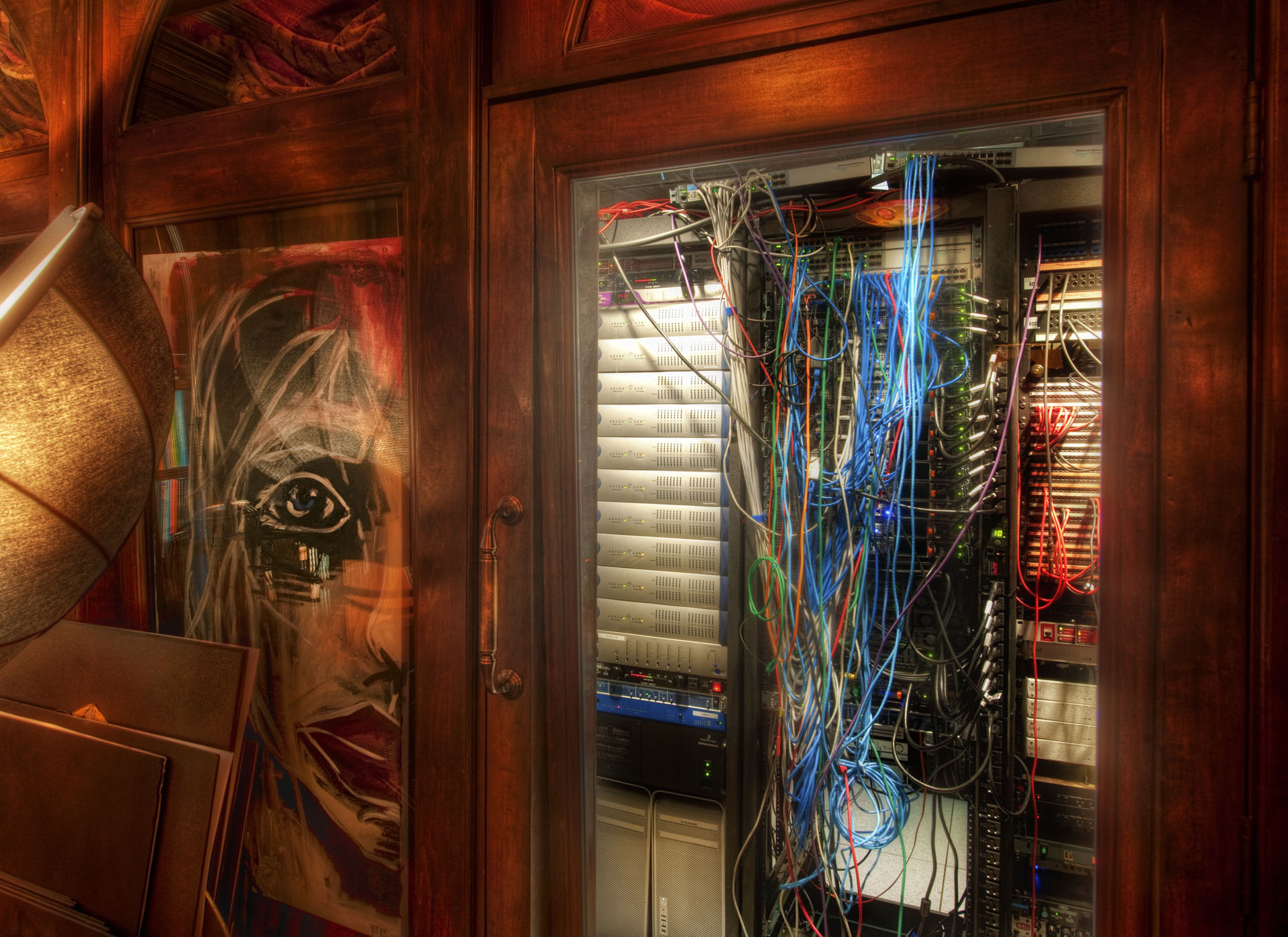

I was going to mention this before, but its not exactly accessible and I dont know much detail
the whole left side of that rack is a stack of protools HD interfaces, so there will maybe be some innate hardware capability also.
Ah, yes. Unlimited budget always helps 🙂
