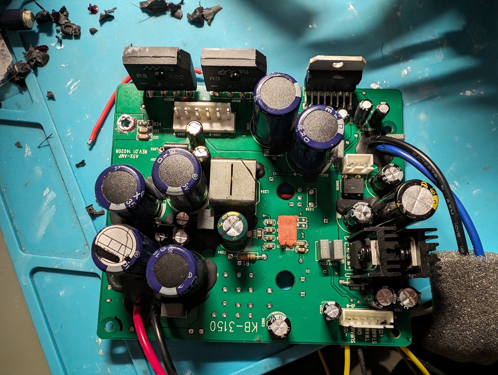

I've narrowed it down to the amp-board so far. Haven't had very much time to look at it this week but I will check more tomorrow.
I'll take some pictures of the board, but as far as I can tell, everything looks as it should. But the more eyes the better I guess.

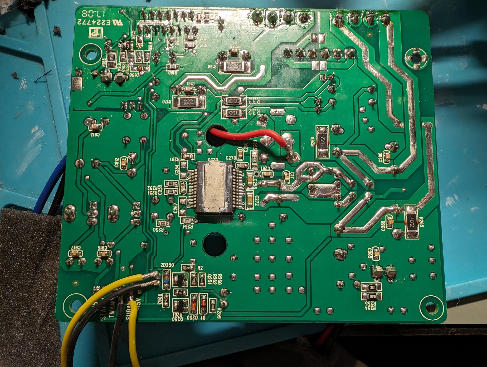

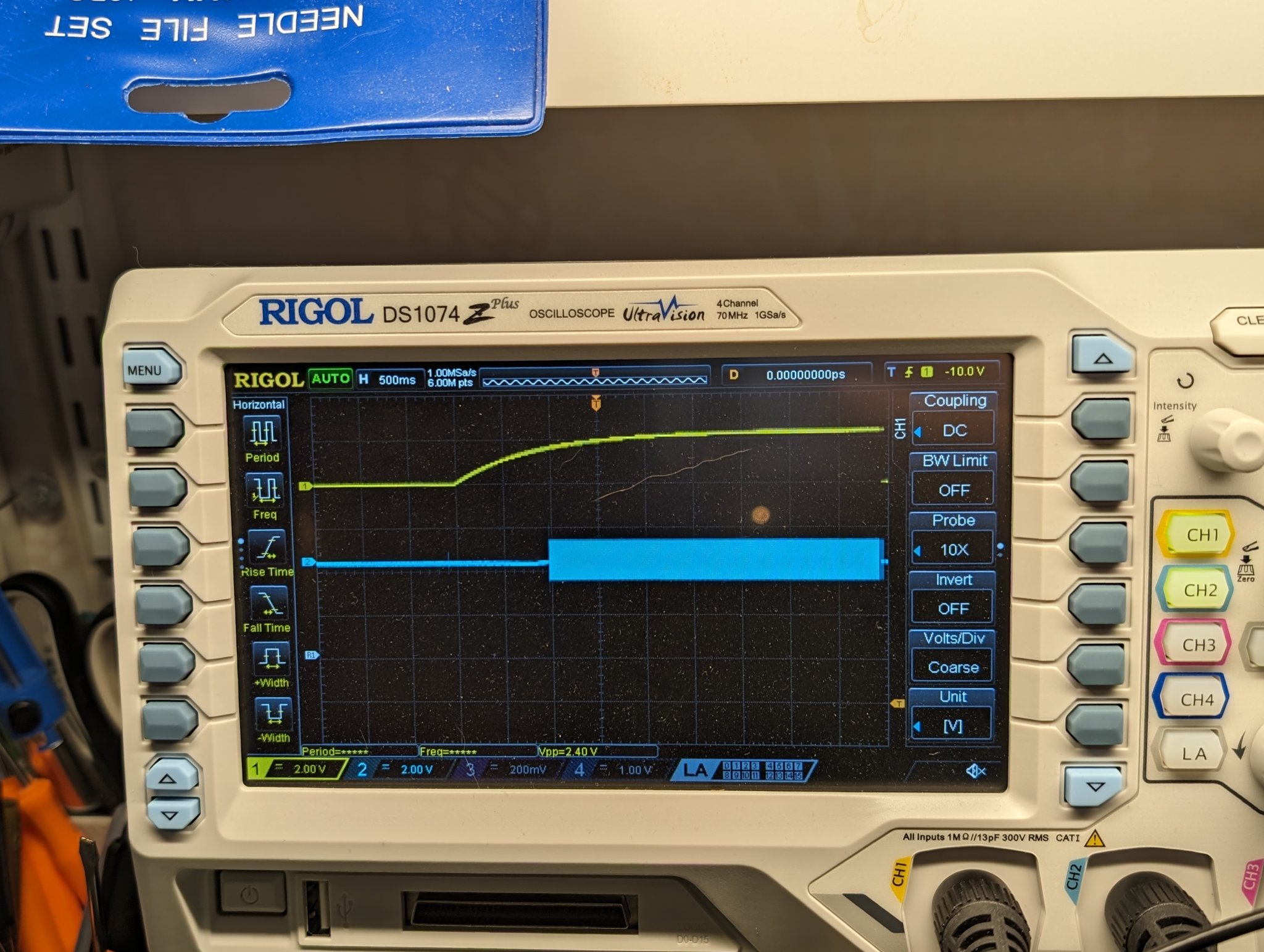

I've pretty much concluded that the amplifier-chip (TDA8950) never starts up fully.
According to the datasheet the voltage on the mode pin (pin 6) should rise to between 2.2 and 3V to enter mute mode, Then the PWM output start oscillating and the voltage should there after rise to above 4.2V to enter operating mode.
My problem is that the voltage stays on "mute-level" even after the PWM has started. I confirmed it with the scope (attached image).
The other amp-chip (TDA7294) has a similar function, but I haven't checked that one yet.
There isn't any cap at the input. Pin 6 goes to the via to the right of R264 (0 ohm link) and down the the black lead to the left of ZD250. On the other side of the via there's a track to another via which comes back somewhere under the chip. I can't find a cap directly connected to pin 6.
(Cables are for attaching the scope)
The cap may be wired via a resistor. Have a look at the data sheet
