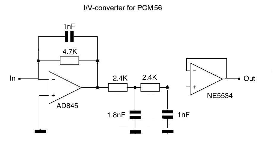

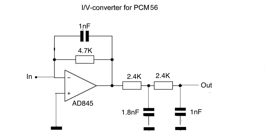

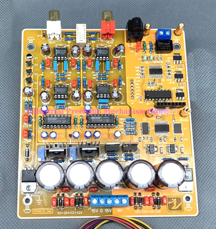

Responding to "some other op-amps" in the thread title, I've been doing some modding on my socketed chi-fi PCM56 DAC. This comes with 2 stages of NE5534 op-amps. First I removed the small cap between pins 5 and 8 on stage 1, and put in an AD845 which was an improvement and a good sound. I left the second NE5534 buffer. The sound was clean though missing some low level detail. I then took out the stage 2 NE5534, and took the output from pin 3. In this setup there was a lot more low level detail, plus good tonality on voices and acoustic instruments, but the overall sound was less clean. It sounded compressed, as if the dynamics were flattened and homogenised. This was most apparent at low volume levels.
Can you guys explain this phenomenon? What can it be attributed to? I see from following threads here that your setups don't usually include a second stage buffer, so what can be done? Maybe a better buffer? Why does a buffer make such a difference and what's the best way forward?
In this setup the DAC goes into a type 27 mesh valve stage with 100K input resistor. The DAC board uses a SPDIF input fed by a V-Link asynchronous USB/SPDIF converter. Source is a Mac Pro with archived CDs in iTunes.

The same problem happened to me the first time I used an AD811 with a NE5534 buffer, from Signetics. It played well, but the ECC88 sound was much better to me at the time, and I moved on to tubes. Now I dared to leave the AD811 without any buffer or filter behind it and that's it.Responding to "some other op-amps" in the thread title, I've been doing some modding on my socketed chi-fi PCM56 DAC. This comes with 2 stages of NE5534 op-amps. First I removed the small cap between pins 5 and 8 on stage 1, and put in an AD845 which was an improvement and a good sound. I left the second NE5534 buffer. The sound was clean though missing some low level detail. I then took out the stage 2 NE5534, and took the output from pin 3. In this setup there was a lot more low level detail, plus good tonality on voices and acoustic instruments, but the overall sound was less clean. It sounded compressed, as if the dynamics were flattened and homogenised. This was most apparent at low volume levels.
To begin with, try connecting the output directly via a low-value resistor to pin 6 of the AD845, and add a 47-100K to the output in parallel with some 100pF so that the op amp output is always connected to ground, although it is not necessary. This is also the practice in the vast majority of commercial devices and since the output impedance is always low it has no effect on the sound. The AD845 does not have the same current capabilities as the AD811 so I hope the next stage is high impedance.
I'm the designer of the AD845, at least I was in a prior lifetime. 😉
The AD845 can source/sink 50mA typically. It also has a pretty high standing current in the output stage, so the OL output impedance is pretty decent.
Incidentally, it was never envisaged for use in Audio, so it was never optimized for linearity.

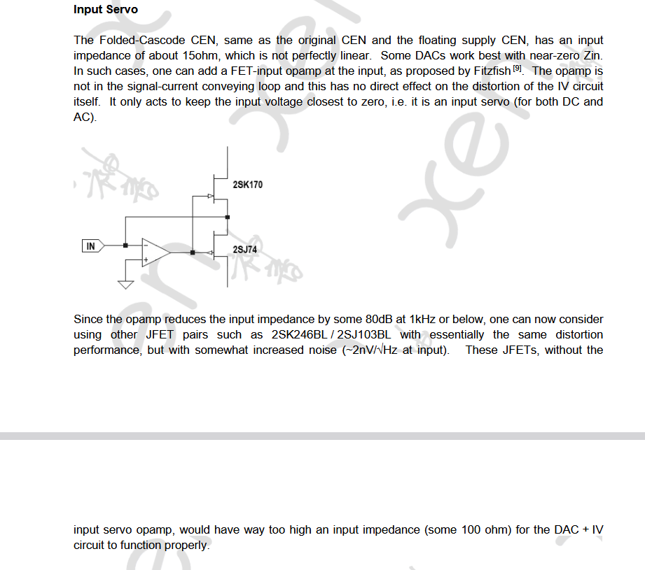

G. What would you think to make a composite with The AD811 to get-rid of the highish input resistance ?
Jfet complementary input à la EUVL with jfet opamp servo to lowish the input resistance near zero for the next dac ic stage (the op amp servo has no signature how it is used.)
Do you think it will be stable without the I K resistor after a k170/J74 input buffer stage? At 5 to 10 mA Jfet output to input before the inverted input of the AD811 ? Also the AD811 works better with source lower than 1K (AD1862 for instance is 2K R output -(don't know for the capacitance). I know the 700 to 1 K R is here for stability, but is there a way to reduce that value or get rid of it ?
Best of two world and HF spread solved at the same time by the Jfet input ? I/V made by the AD811 still ?
from the Folded Cascode CEN pdf by EUVL aka Patrick from XEN Audio:

I'm glad you're responding in this thread. The AD845 in the DS has even lower impedance than the AD811, so I think the problem is probably in the filter between it and the buffer, or as you say, it's not optimized for linearity. With the AD811 I drive transistor amplifiers directly and in between I only have a quality audio potentiometer. By the way, the AD811 is great for an I/V stage and I'm glad Walt used it in that way too.
