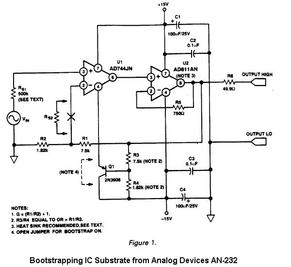

Another article from W Jung in AD AN-232 aplication note.@grunf,
Slightly off topic, but AD811 related.
Did you ever experiment with W. Jungs line amp/preamp AD744/AD811 circuit?

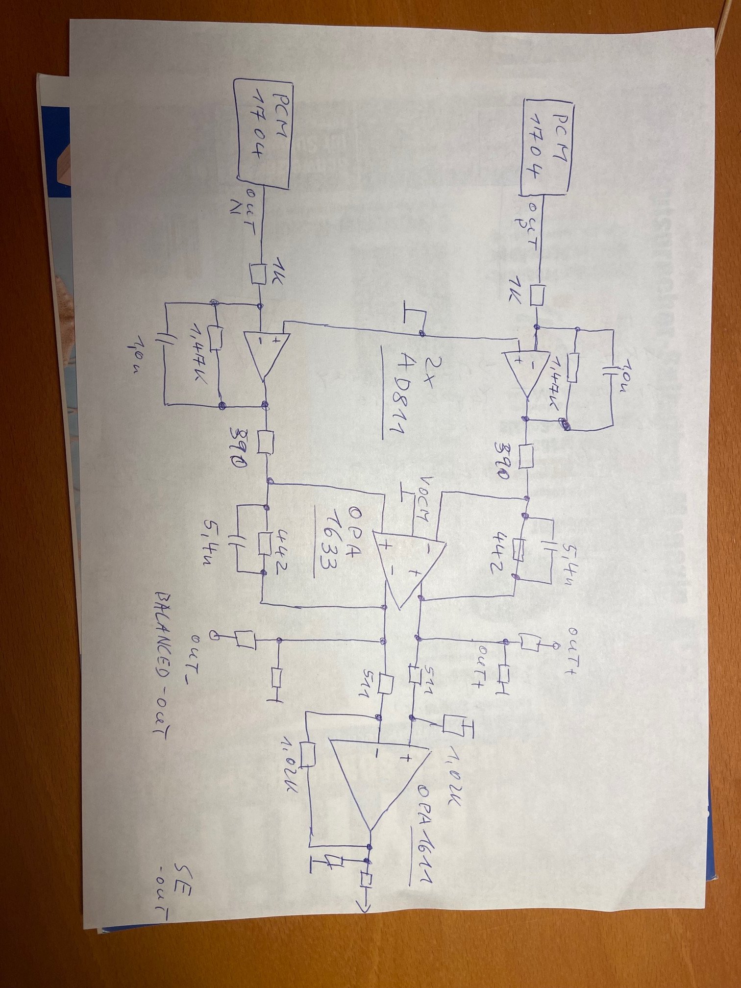

Hi , @michaelbehrendt@grunf ,my idea for I/V converter with 2x PCM1704 per channel, I/V with 2xAD811, then low pass filter with OPA1633 and symmetrical output, then symmetrical to single ended with OPA1611, what do you think?, all resistors visual PNM or Yageo NT, all caps COG (NPO), regards Michael.View attachment 1426571
Thanks for your interest for the AD811 I/V, I would throw out the OPA1633 and go for a simpler solution like in this Circuit design document for the PCM1794 but configured with unity gain after the AD811.
If I were doing something like you, I would put a Broskie Cathode Follower with ECC88 behind the AD811 and not even think about op amps🙂.
I must point out one error on the AD811, you must connect the 1.47K/1nF feedback before the 1K resistor .
Igor
or just use the opa1633...
OPA1632/OPA633/LME49724 etc. work very good in DAC I/V.
Alex.
Yes, but in combination with the AD811, every other op amp in my opinion degrades the sound of the AD811 itself, so the less of it behind the AD811 the better.
The AD811 is quite capable of dealing with even the most stubborn SS amplifier.

so the answer is : don't sum your two ad811 from the PCM1704 ! 🤣👍. the CFA op amp is rigth, not your dac ic choice ! Fun.... You're really guys make audio great again...

So anyone about my idea to use a discrete current mirror JFet input helped by an opa (it is not in the signal path) to reduce the impedancce input and shot noise to the lowest levels, before the AD811 and its noisy input stage (relative to much modern quieter ones) ?
