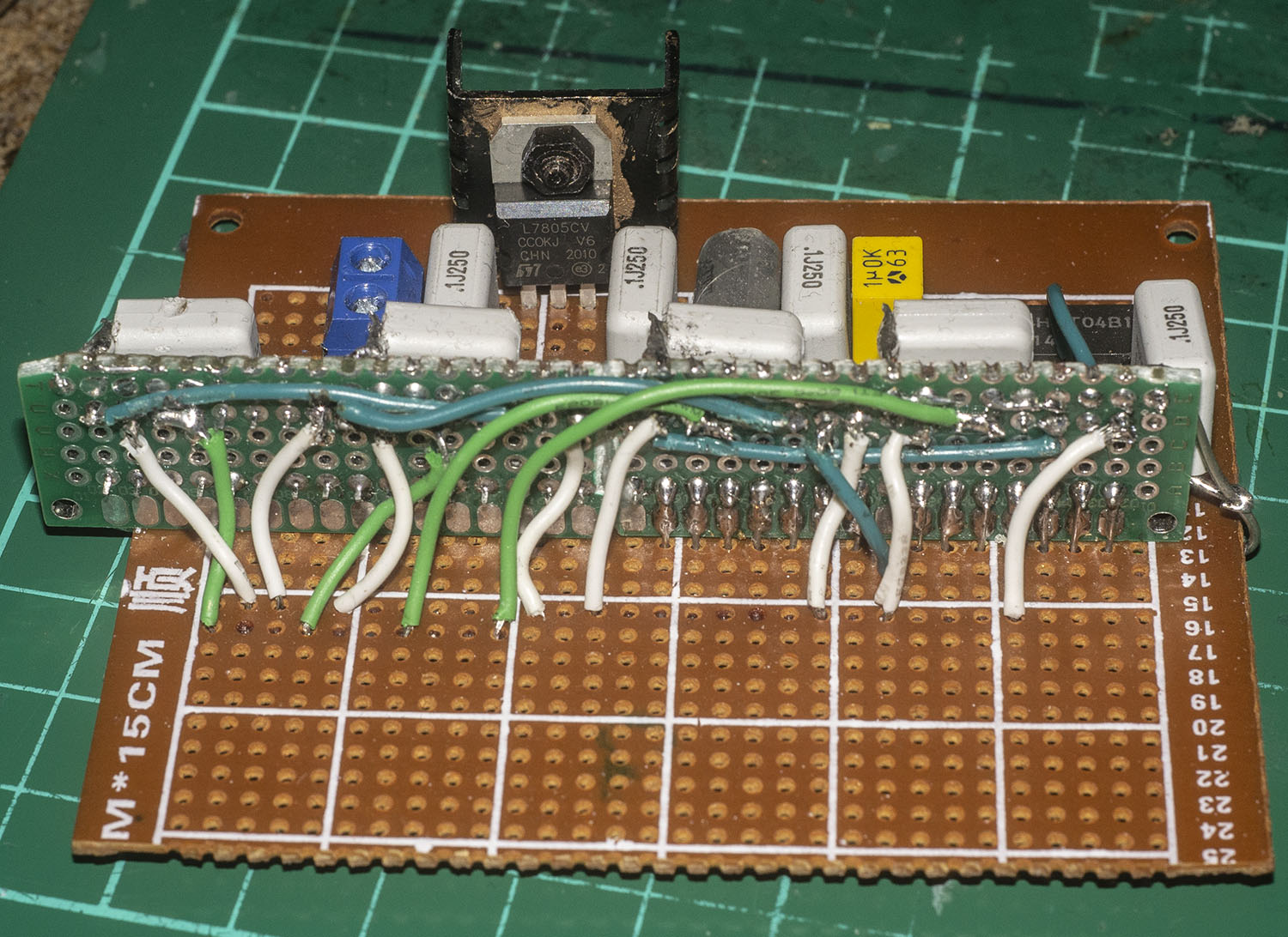

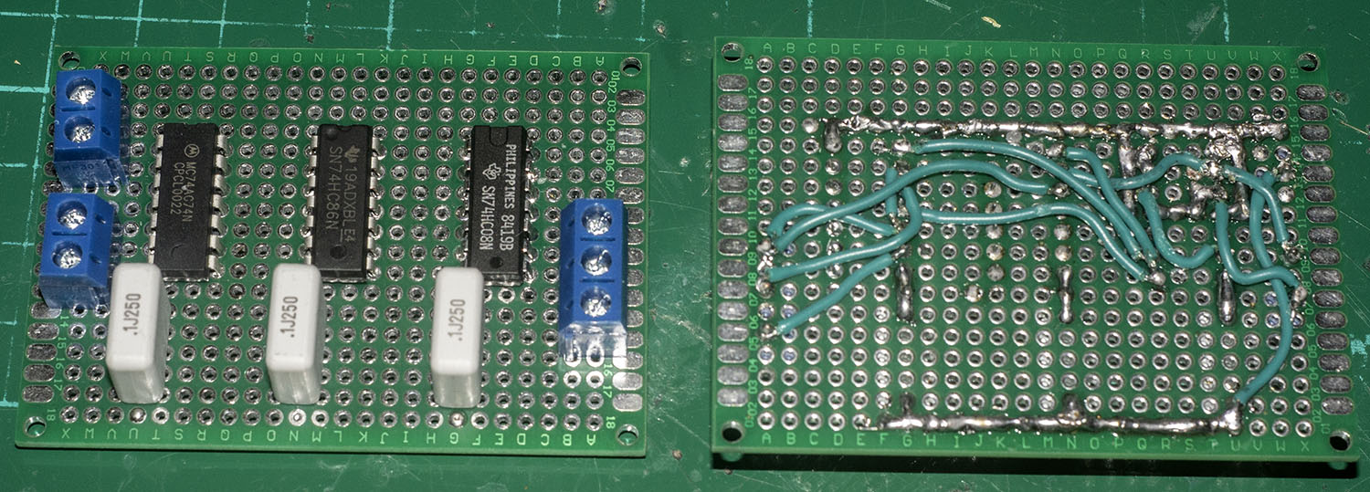

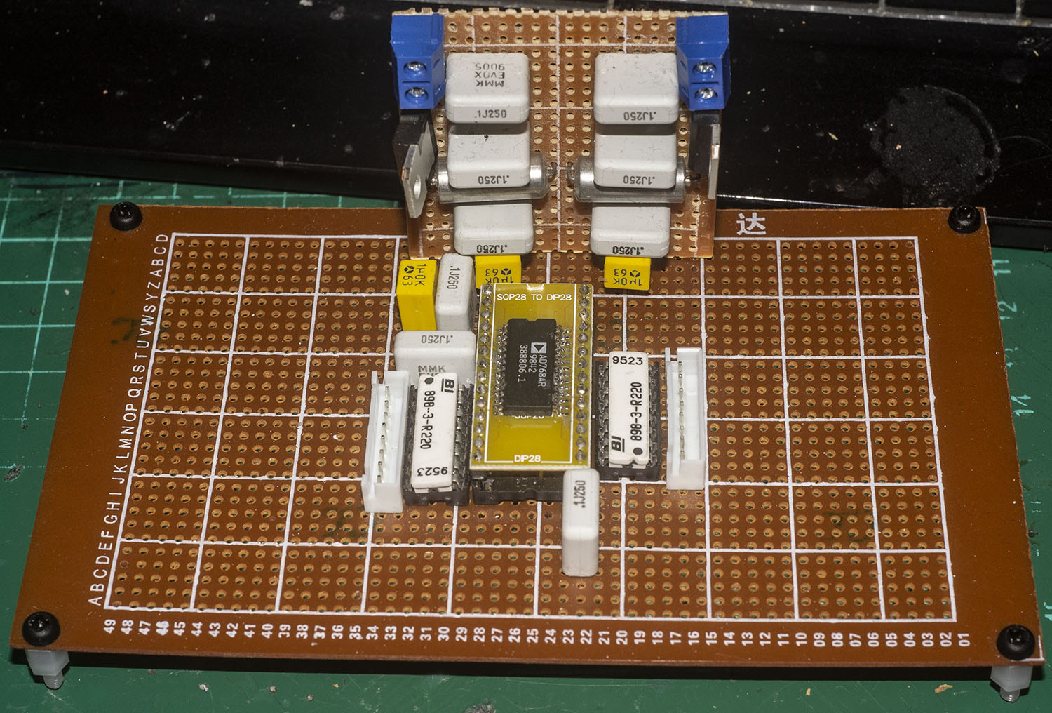

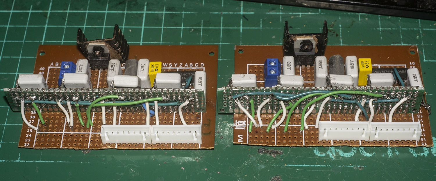

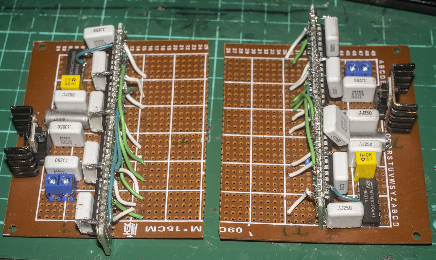

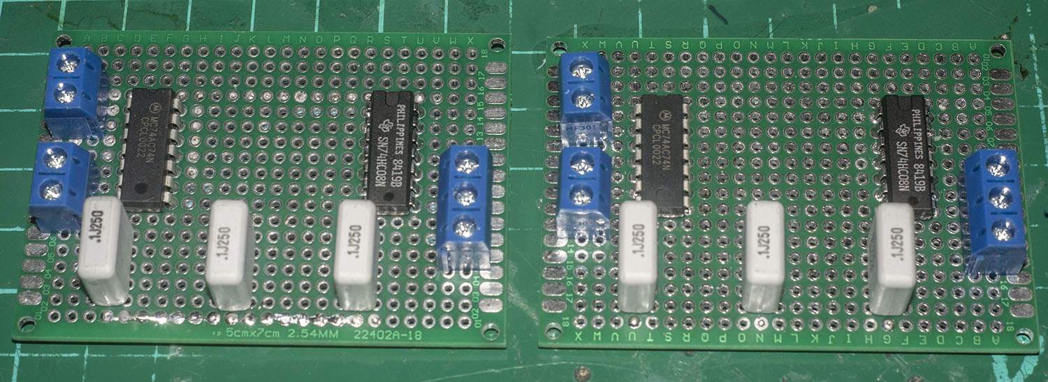

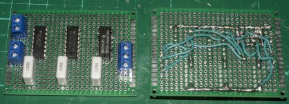

Here's some pictures of the progress I've made, I've built the logic boards, but none are 100% complete yet as I'm waiting for some parts to arrive.
The shift register boards are a bit messy, not my best work, after I did them I wished I'd laid them out differently, but that is hindsight.

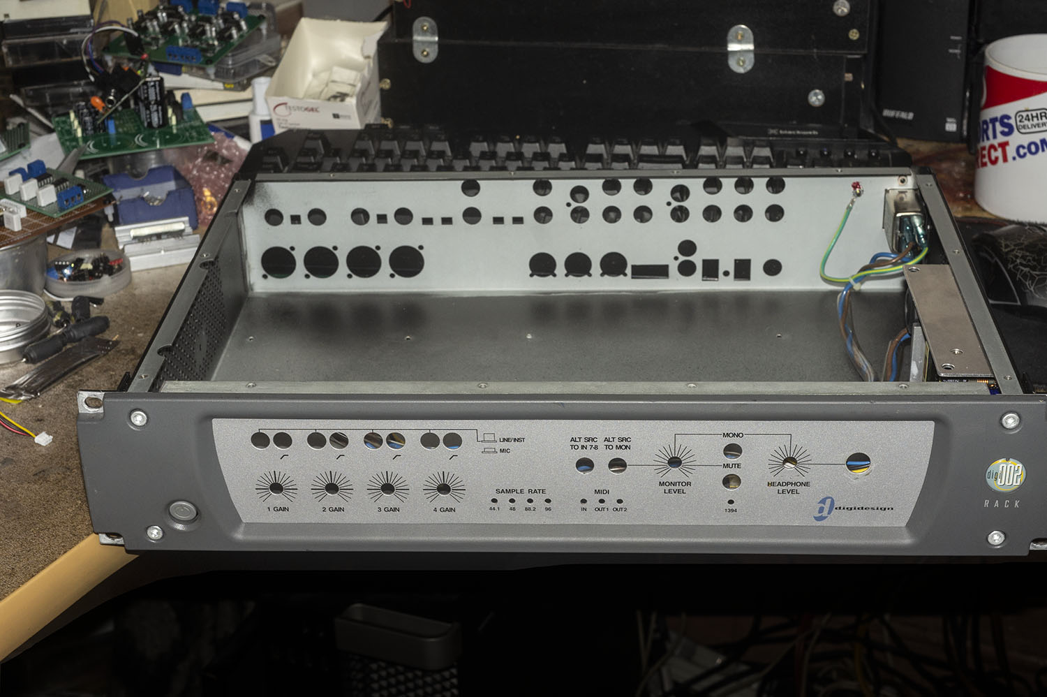

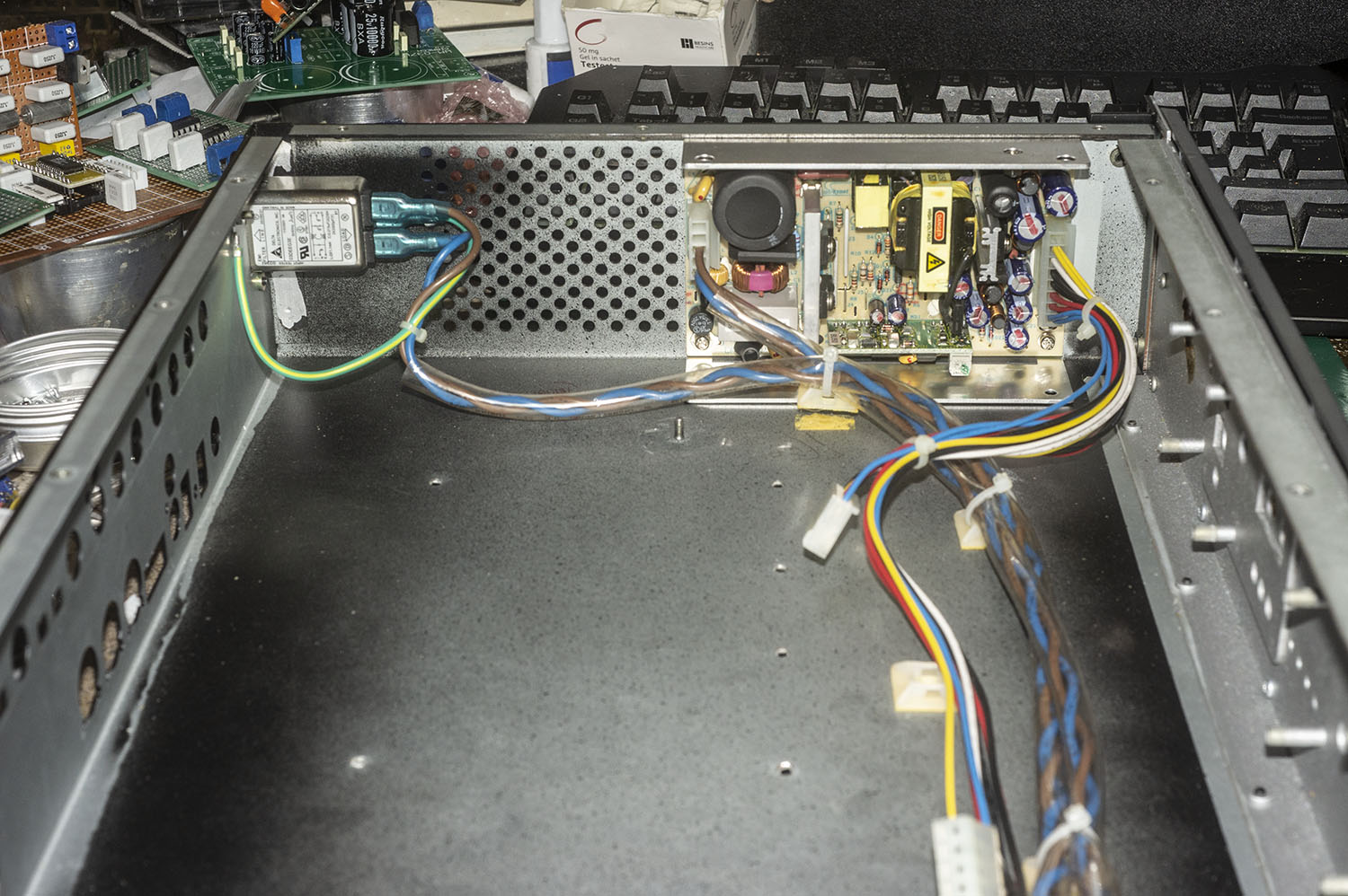

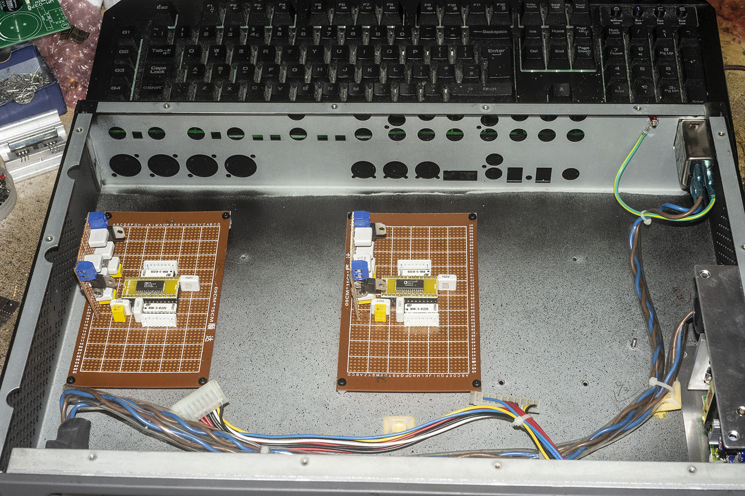

I've obtained a really nice enclosure to put it all in, I'll take some pics of that after the England vs Croatia game, which is just about to start.

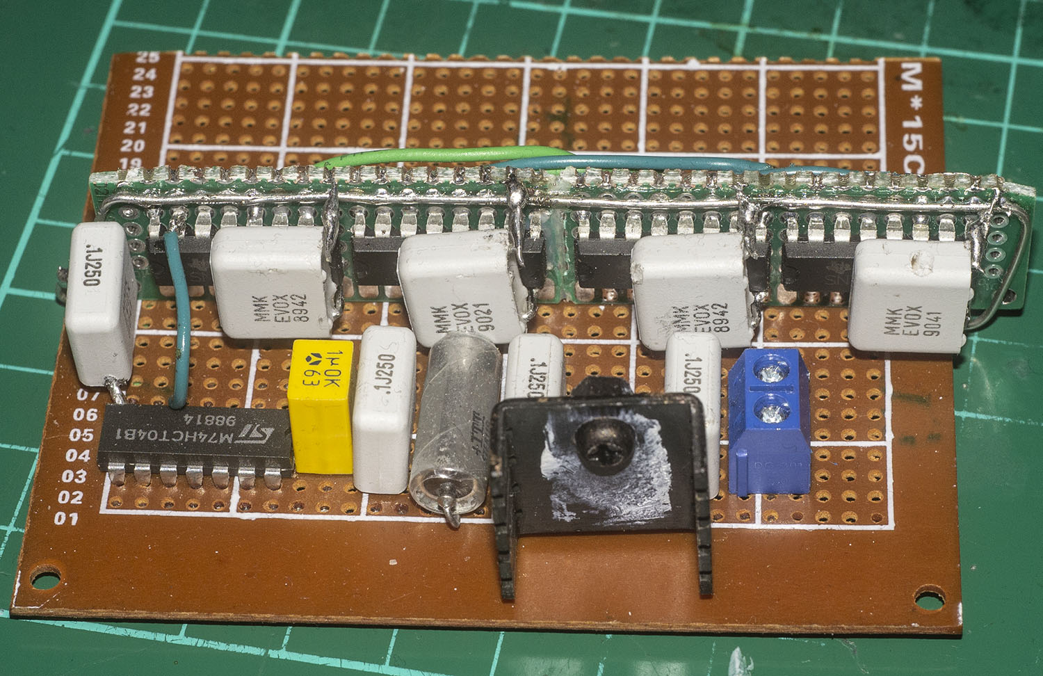

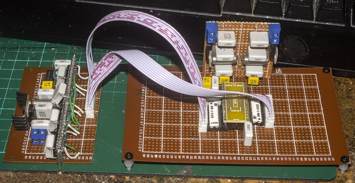

Made some further progress, so now I can start to work out the rest of the device - the receiver, digital filter(s) and the analogue output stage.

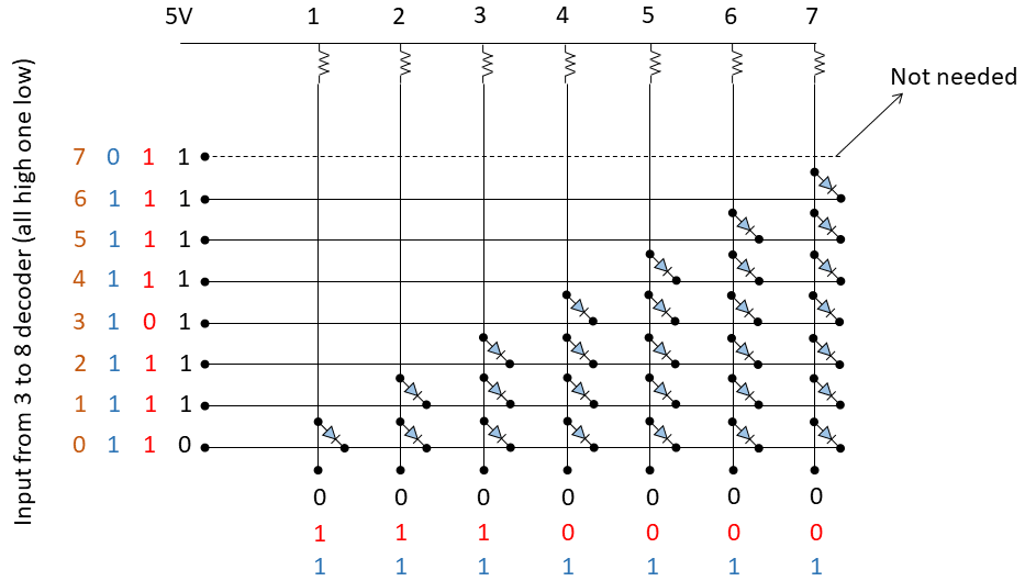

@Zoran, to come back to this thermometer code issue... Have you seen any attempt which use the so called "diode matrix" (or diode ROM)? Below is an example for n = 3 and n=4 using 120 cheap diodes does not seem too crazy. The resistors could be around 5k.

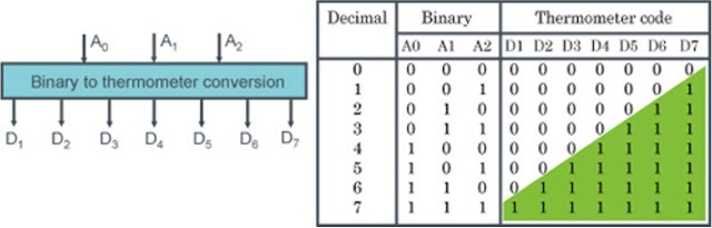

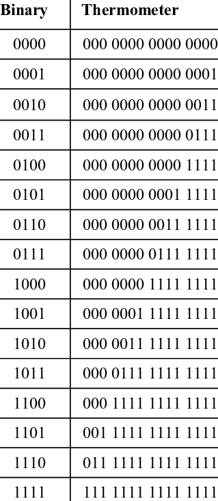

For first 3 MSB (bits), You will have only 3 input to thermometer encoder and 7 outs. Not 7 inputs and 7 outputs...
For first 4 MSB (bits), You will have only 3 input to thermometer encoder and 15 outs.
there are some tables
binary-to-thermometer-jpg.1055676
Thanks but when you build a segmented DAC, say for n=3 MSB, you will need to add 2^n - 1 = 7 unary pieces (see below for the generic idea). I did a sloppy job in explaining my idea. In my drawing I did not show 3 binary inputs. I have only shown 8 corresponding decoder outputs (on the left - just 1 out of 8 stuff) and 7 thermometer outputs (at the bottom). I have exemplified 3 codes from decoder output and 3 corresponding thermometer codes (black, red, blue). Let me add that on the LHS, binary input goes from 000 to 111, from bottom to top. So, the whole picture is equivalent to the table you kindly supplied above.

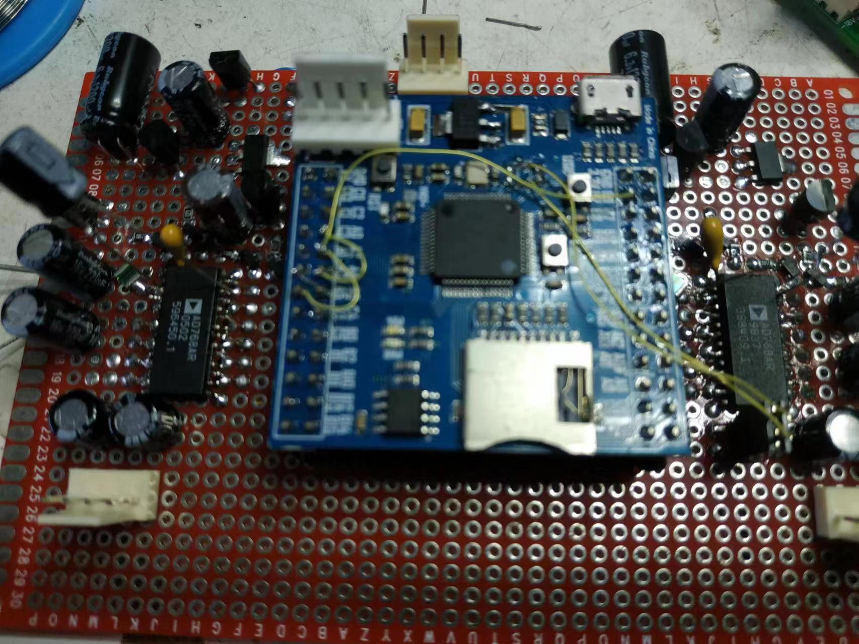

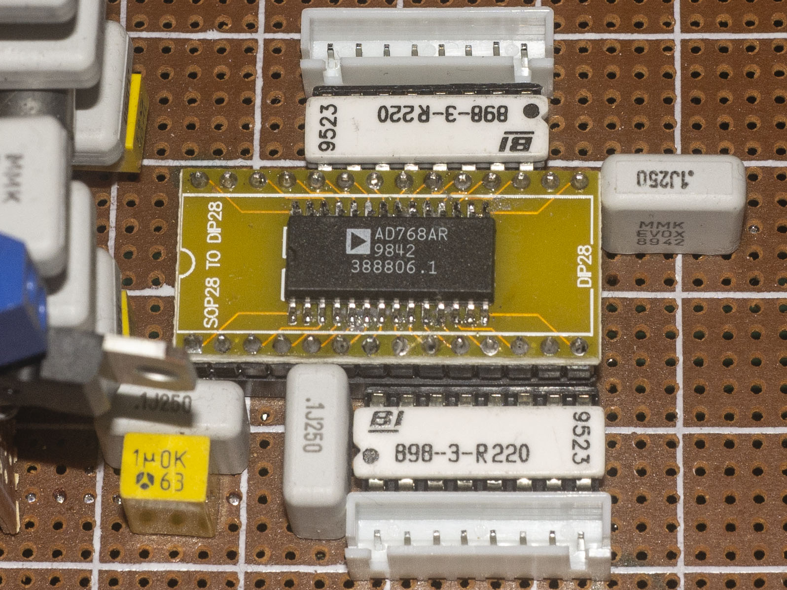

I eventually got my dual-AD768 DAC working where the interface is handled by a HC32F460 Cortex M4 MCU. It needs the 64pin package to have two 16bit parallel ports to talk to the DACs. I jigged the power supplies so it only needs a single 10-12V power rail. At present the MCU is doing 8X upsampling - the output filter is the next part to be added on, probably a 3rd order CLC will be sufficient.

Subjectively this dual AD768 is giving satisfying results so I've built a second prototype with the aim of playing around paralleling the two to get the noise down.

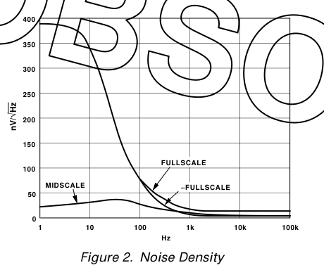

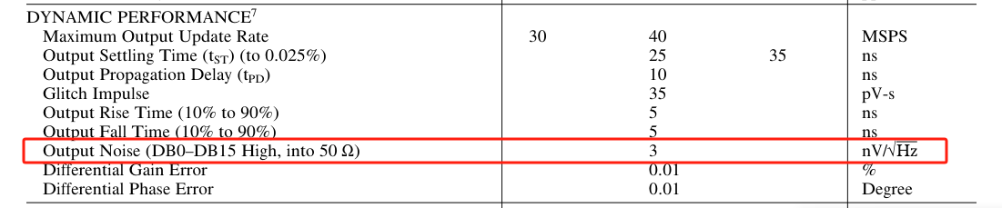

The noise specification for AD768 is rather interesting - the datasheet has this :
Footnote 7 tells us that its measured at IoutB so if the two balanced outputs are taken then we should see 3dB improvement assuming the noise isn't correlated between IoutA & B. Also of note is the condition DB0-DB15 high, which is the maximum output. Normally noise for DACs is given at digital zero, not at maximum output. As R2R DACs are multipliers of their reference current it seems reasonable to me to infer that if the noise comes from the reference then the noise at digital zero is going to be lower than at full scale. The 3nV figure integrated in a 20kHz BW gives 0.4uV noise and the (single-ended) signal's 1V p-p or 353mVRMS giving 119dB SNR. Not too shabby at all, especially as it seems to be an upper bound.
AD1862 is the only DAC chip I've come across that shows its output noise as a function of code, and frequency :
