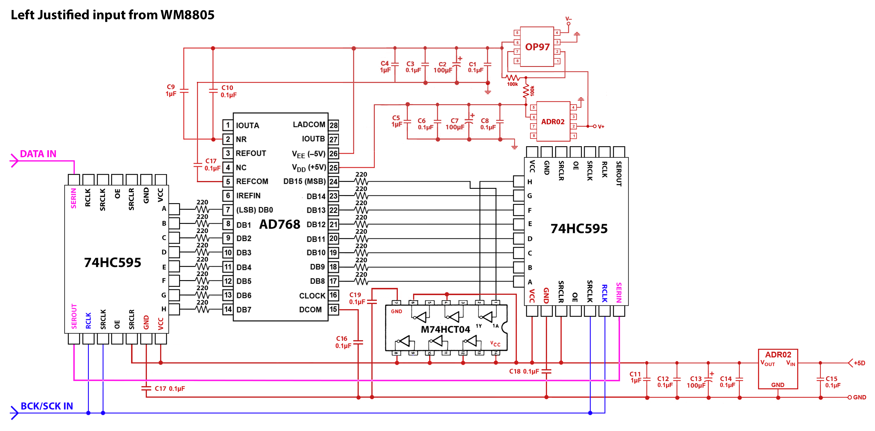

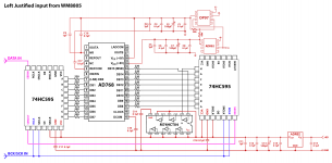

I have redrawn my schematic accordingly, assuming I will be using a WM8805 receiver outputting left justified format data.
I haven't added any resistors between the ICs other than the two banks on the AD768's inputs, do I need to add more? I guess it's time I got a 'scope...

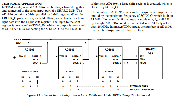

I note in the datasheet that you daisychain the AD1896 so that instead of just the 8x OS of one a chip, you can also achieve 64x, 512x and 4096x.

There is a fundamental difference between an ASRC like the AD1896 and an oversampling digital filter like the PMD100. More to the point, you cannot simply daisy chain chips irrespective of Fmax.
But the AD1896 is intended to be placed between a receiver like the WM8805 and a DAC chip and is designed to be daisychained, so I fail to see your point.
Perhaps you should look up TDM mode.

Waste of time bringing up TDM mode because the AD1896 supports daisy chaining in left-justified mode, which I was planning to use, so the point remains valid - I can experiment with different sample rates if I build a board containing multiple AD1896s.

Hi Ian
The point for paralel from serial when 32bit word is present is to have 32 bit shift register. 4 x 8bit. Does not matter the fact that You will use only 16bits from 2 x 8bit shift register. Because of the position of MSB - it is in the 4th IC from data input...
Other way is complicated, include interventin in WCLK line, Making "window" of 16bits, and "shorten" all WCLK periods introducing a jetter and adding maybe more ICs into the circuit.
Aah, I see, now I understand why you drew the schematic with four 8-bit registers!

Yes, I regretted buying the 595 modules the moment you explained that I would need more than two - the modules take up more than twice the space as a DIP version, so I shall have to buy some DIP versions and put the modules in my box for future use.
Again, yes, you are exactly right, just getting the device working is the goal, simply going from WM8805 to DAC using left justified data. Adding any further steps such as sample rate conversion can come later, or not at all, I only mentioned it as an aside, not something to be concerned about right now.

If that's true, why did you specify the ADR02 and OP97 as apparent voltage regulators? You show the gates of the HC04 wired backwards and you show series capacitors in ground connections. There's more but why should I waste my time. You obviously don't care. You just post something and hope someone will tell you how to fix it.

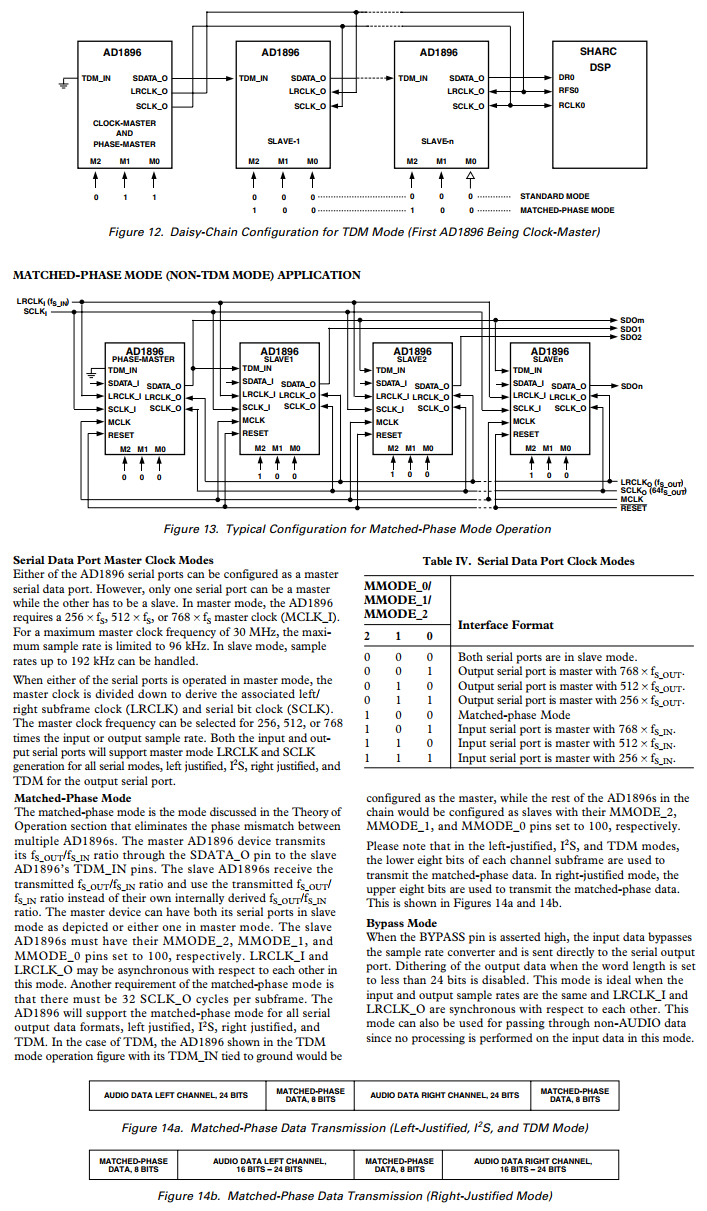

The AD1896 will have a maximum output frequency though so 4096X OS is only going to work for very low input frequencies, below full audio bandwidth. Which I take to be @rfbrw's point.

The typical maximum update rate is 40MSPs (i.e. 40MHz clock) but only 30MHz is guaranteed. But no matter how many AD1896s you daisy chain you'll not get anywhere near that figure because of what I've said above.
To get beyond 8X OS probably you'll need either an FPGA or a fast MCU. For the latter there is a Cortex M7 now at 1GHz clock - that might be fast enough to max out this DAC 🙂 Get it working NOS first though.

I seem to have made another ****-up by only just now realising that the ADR02 is only good for 10mA, so while it is very accurate and low noise, it isn't going to work to provide the power supply voltages. I shall have to have a good think about how to fix this problem as just sticking in some good old 7805s instead doesn't seem the best idea. Maybe there is a circuit I can build that uses the ADR02 and a transistor to deliver 5v with rather more current than 10mA.
That one can look at those daisy chaining diagrams and come to the conclusion the OP has points to a complete lack of understanding of how the AD1896 works.
