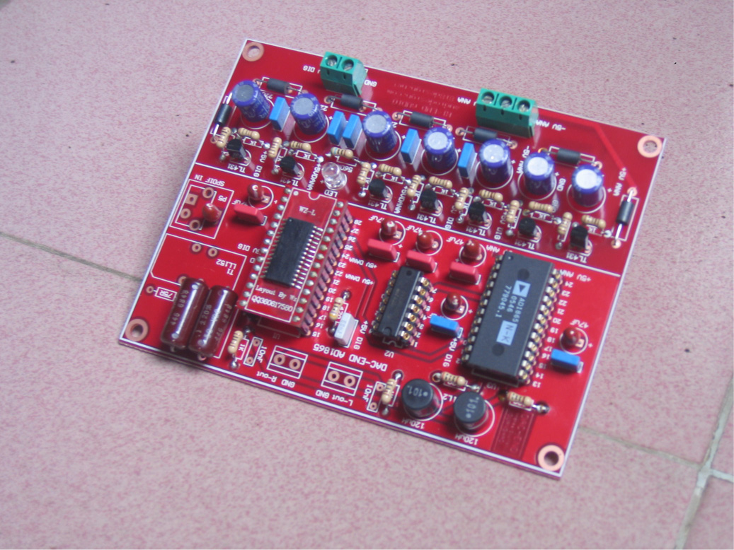

What's the green board of PCB?
A ha!
Green Board iv stage of him, he use moffet!
thank!

Oh! I think you can have it in Group by, because the board is very cheap! And the quality is good!
Thank!

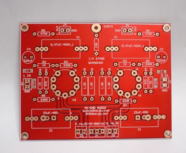

Is there any thought to producing the boards for the tube output? I was considering making a small batch of the boards for personal use. This would be a nice addition to the offering and save me the trouble, too!

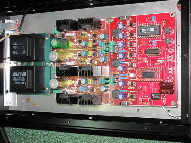

CS8414 receiver chip should have separate power supply for digital part and separate power supply for analog part.
74HC04 should have separate supply also.
DAC chip AD1865 should have 3 separate power supplies. One for +5V digital, one for +5V analog and one for -5V analog.
All together 6 power supplies. And I see only 3. To share same supply for receiver and DAC chip is not the best thing you can do.

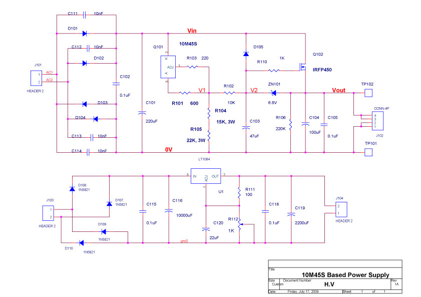

At output of Simplistic Salas shunt reg you have 2 capacitors, 470uF and 0.1uF. Before TL431 you have 220uF and 10nF, after TL431 you have again 220uF and 10nF. At chip supply pins you have another 47uF and 0.1uF. Together 8 capacitors for each supply pin?
Why shunting shunt regulator with a lot of caps and TL431? More caps = better sound? 🙄

Ok, but normally the grid of the output tube,like in your DacEnd, have a dc voltage of more than 1V.
Have you made any test of the limit voltage?

I show many capacitor parallel , the sound is betterCS8414 receiver chip should have separate power supply for digital part and separate power supply for analog part.
1. You know, all the sound equipment are important to a separate power source. I used to separate Tl 431 to each power before in different locations.
2. If you use only Boad DAC-ENd , you can use suplly simple +5 V and - 5v single is is ok, but not needed to Bo Salas..

Many of my friends have used DAC-END, They dont using the I/V stage as the sample Andrea Ciuffoli, they only use Pre out put.( Dac-End +Pre Tube)
They said with me: *the sound of DAC-end is great, extremely honest,and wonderful!*
