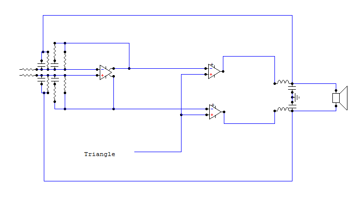

Hi Charles,
Now thinking of incorporating a fully differential IN-OUT opamp in frontend to make a balanced BD modulation, without using a separate inverter.
Kanwar
1.)
Congratulations to not using a differetial amplifier in the feedback path but using a differential forward path instead.
2.)
You could also do the same thing with two "normal" OP-AMPs instead of the fully differential one but you would have to take care of possible offset problems.
Regards
Charles
Thanxz Charles,
I have constructed a discrete differential opamp for this very thing actually. Its using diamond differential high slewrate input stage with matched transistors co-packs.
I am just thinking if single supply option could be used with the full bridge output. I think it can be done, but have to see how it goes with common mode input voltage range of the discrete opamp. I will also try this with differential chip opamp also and see for any difference in performance exists or not, there is one Vcom pin incorporated in these opamps, might be helpful in setting the offset of output at certain operating potential.
