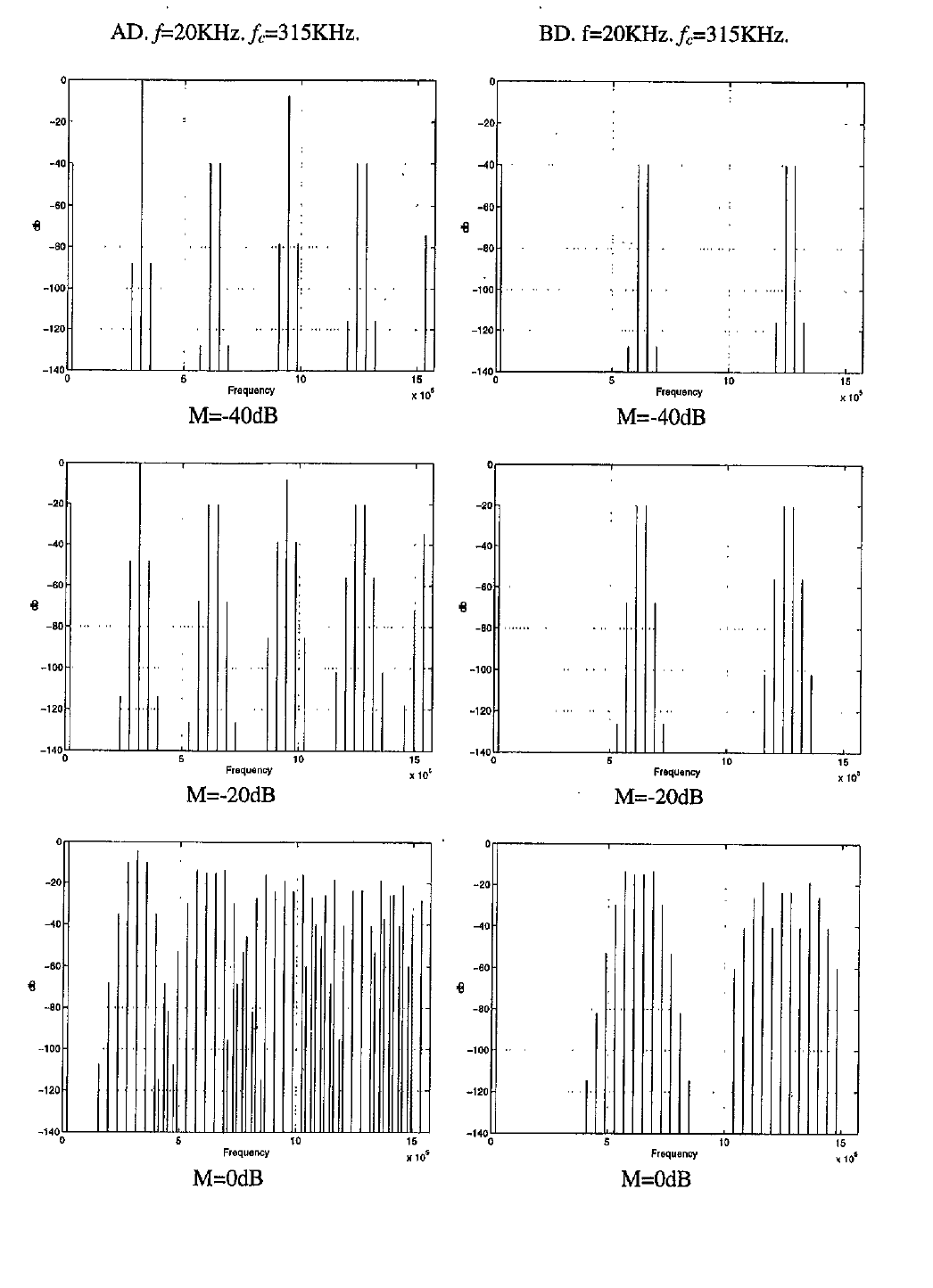

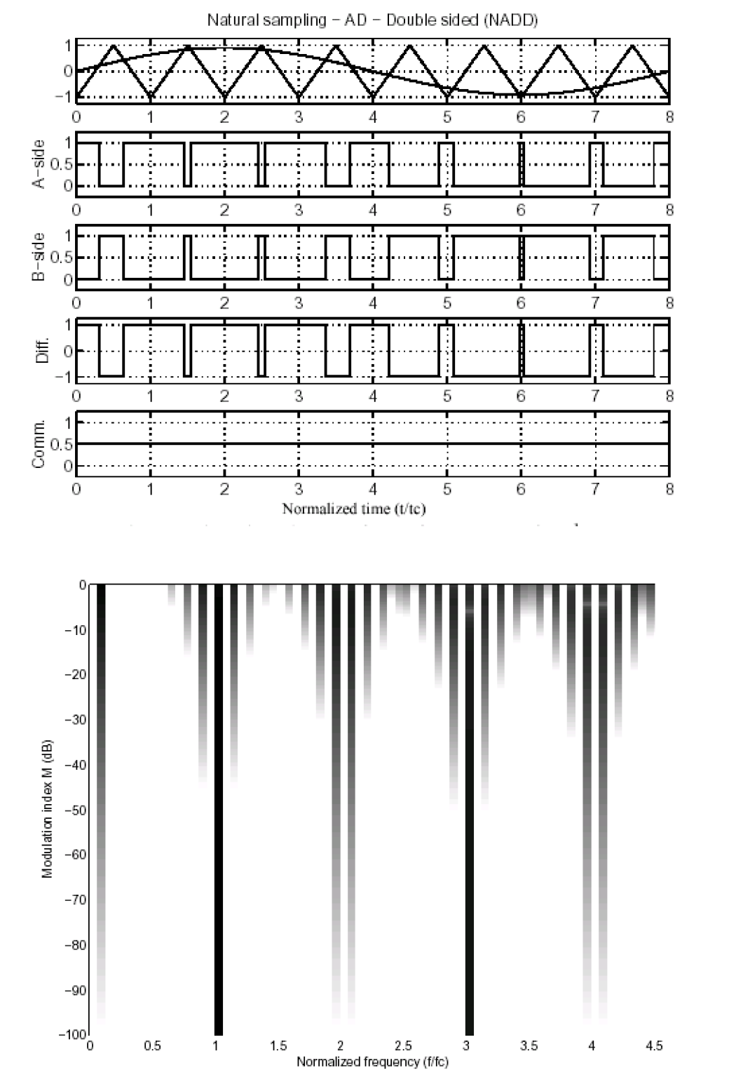

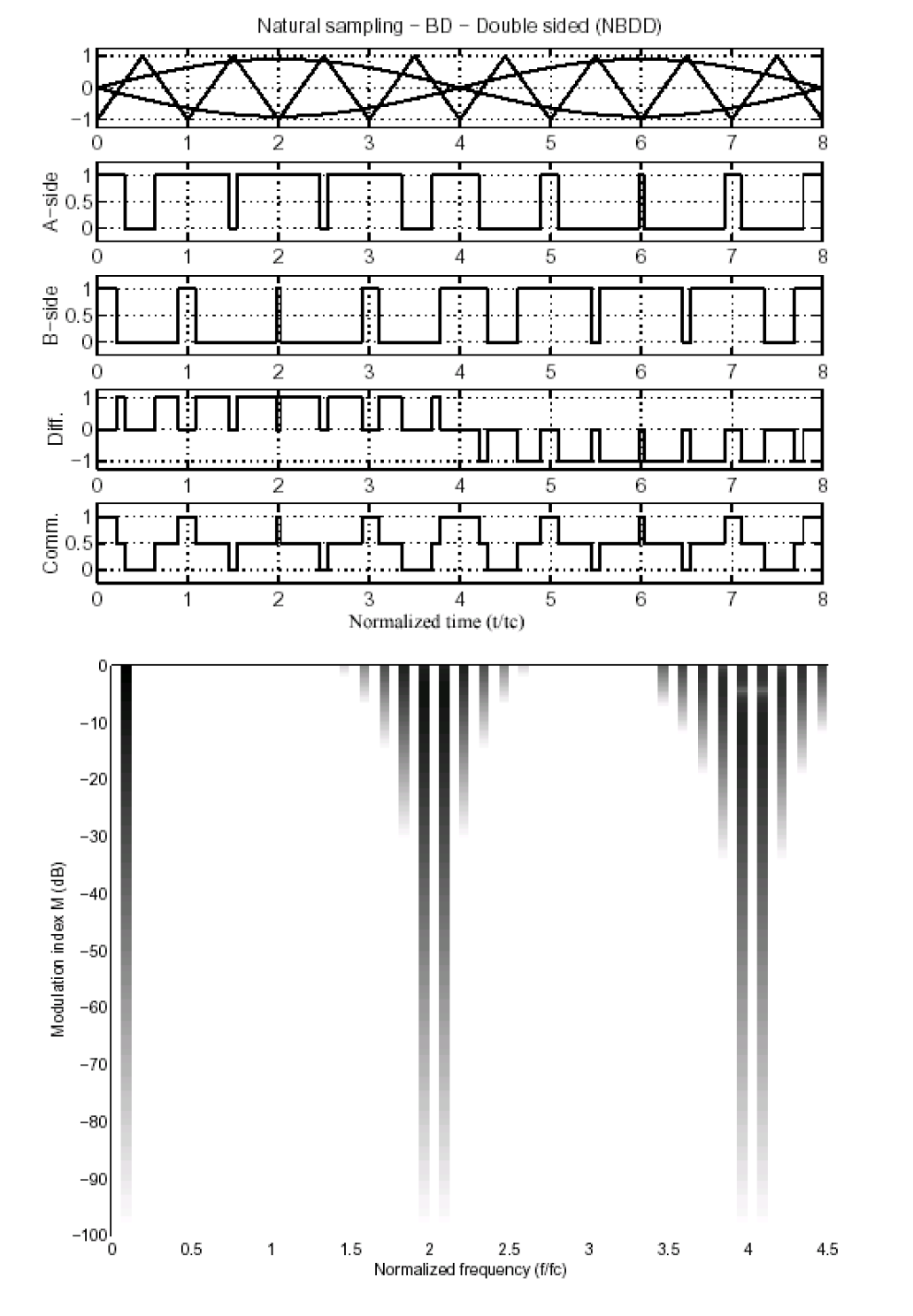

Of course not. It's the sum of infinite sinusoidal components (fourier series), and the freq of first (and dominant) component is fsw. And this component won't magically disappear if you add the two signal, because they are in phase! Don't mix addition and subtraction! If you subtract them, they cancel each other (this is one of the main goals of BD modulation). If you add them, they dont. And if there is a component at fsw, then the whole signal can't be periodical with 1/(2*fsw).
But at low modulation index both outputs are almost perfectly sinusoidal, in this state you can clearly see (without any mathematics, without spectral composition) that your statement is impossible.
Ok, I will do simulation and I will post result here
Do it, and you will see!

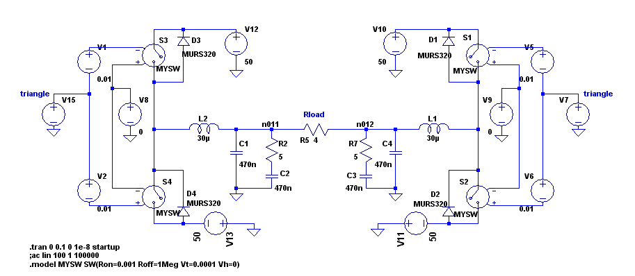

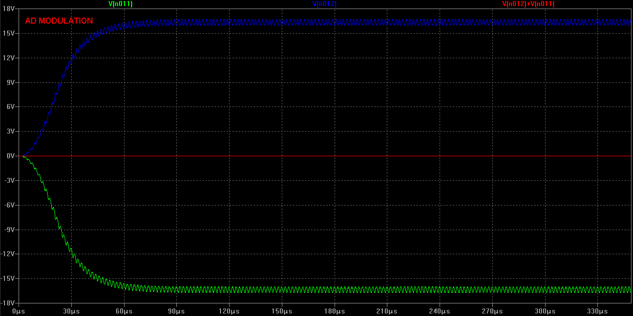

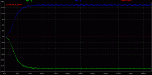

I simulated both AD and BD modulations, and found, that BD modulation indeed does not doubles the radiated frequency... My bad :guilty:
But it have proven the Bruno's sentences about cancelling of the radiated ripple in common mode in BTL configuration with AD modulation. Please, see attached images. Red trace is what will be radiated off cables. Each output wire will radiate its own ripple voltage and it will be summed in the air then. And since in BTL configuration with AD modualtion the residual ripple is in opposite in output wires, radiation will be cancelled (but on the speaker it will be doubled).
