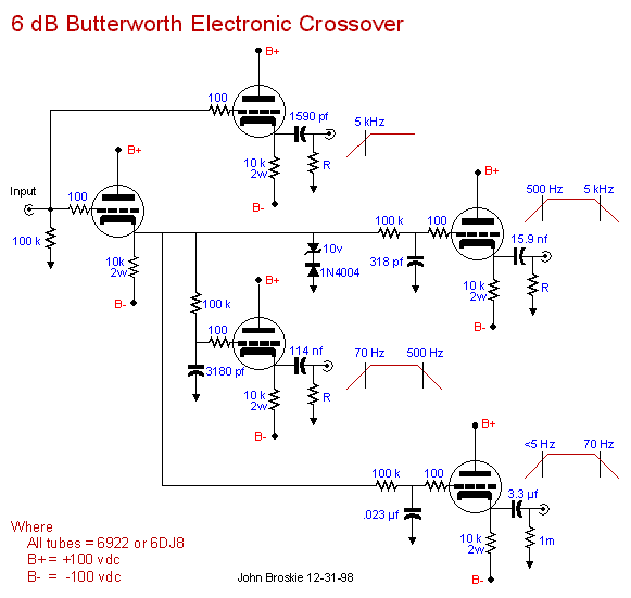

Don't forget that tubes are "slow". Anyway, like this (attached), or something much better?
What are asking me for?
I don't do electronics and I don't like tube amps unless they are amplifying a guitar, electric bass or a Hammond organ.

You mentioned about tube crossover. I thought you want to proof that the crossover doesn't affect the amp because it doesn't sit between amp and speaker 🙂
So from your point of view (taste) tube is not a solution for a system with active crossover 😎
If accuracy of reproduction is your aim than tube amps anywhere in the system are not the solution.
Years ago Bob Carver demonstrated that it is quite easy to use a cheap ss amp to mimic a very expensive tube amp well enough to fool practically any listener. It seems not possible to do the reverse, this should tell you something about the accuracy of tube amps.
And since according to him 90% of the job was to stick a resistor on the ss amps output it should also tell one something about the audibility of an amps damping factor.
In the end it all depends if you want to satisfy your taste or if you want to be accurate. I know what I want, your aims may differ.
