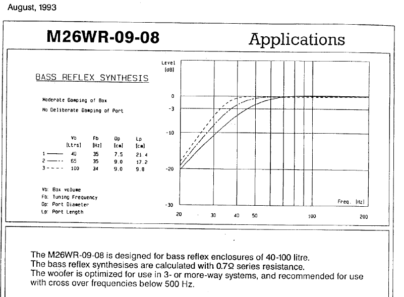

WinISD Pro has a neat feature where you can add series resistance and watch the effect on box alignment - its worth (when using passive XOs, or long speaker cables), adding the resistance of the added components in, so the cabinet alignment can be altered accordingly.
Yes and in a lot of cases the response will be better.... Look at some of the older vifa woofers datasheets and you will see that they show their modelled responses with series resistance added (in the case of my M26WR-09-08's they show 0.7 ohms!) If the driver has been designed assuming that it will be used with a passive crossover so that that estimated series resistance will be present then you have to wonder, will you get the optimum performance if it is not present?
